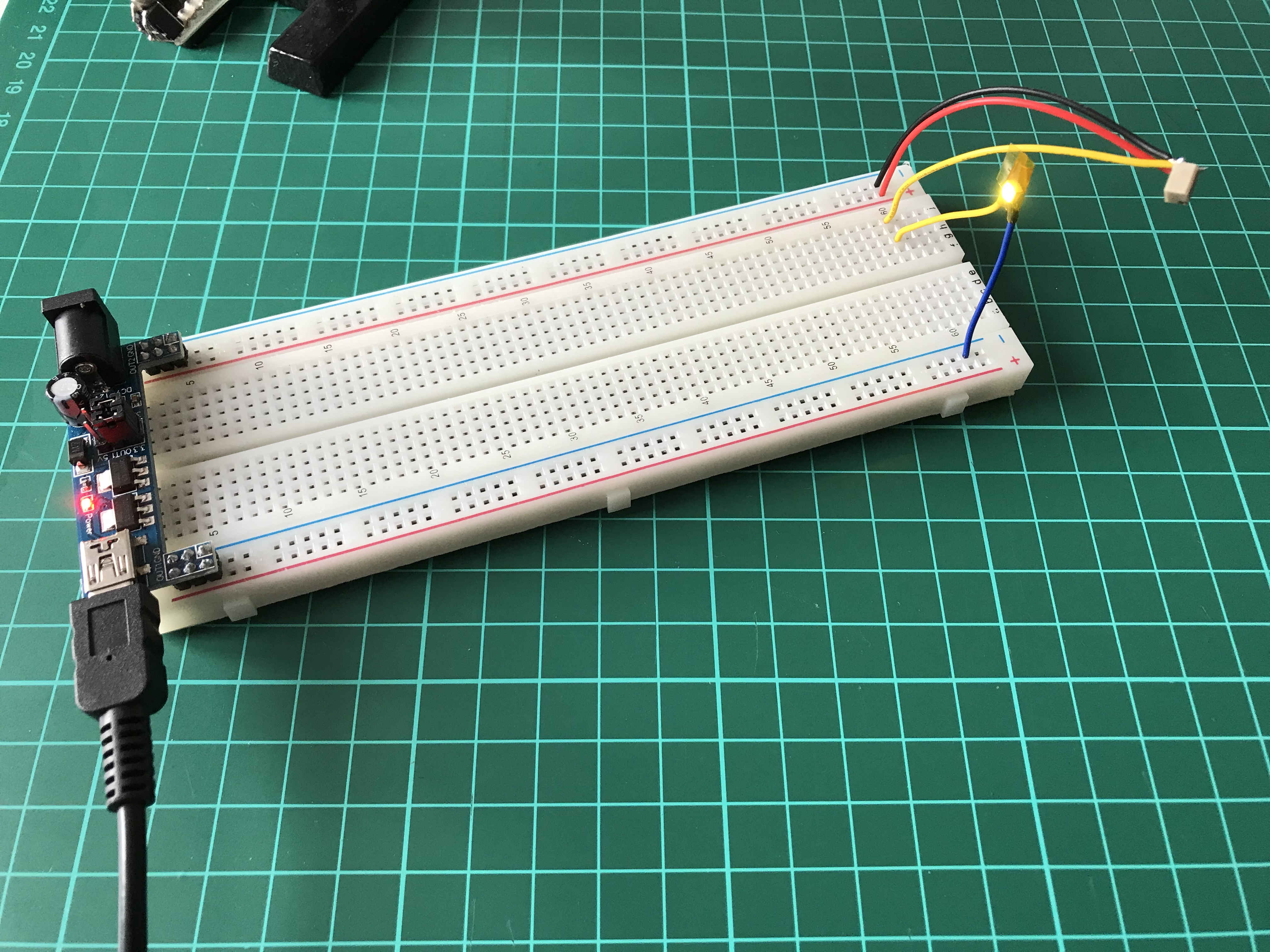

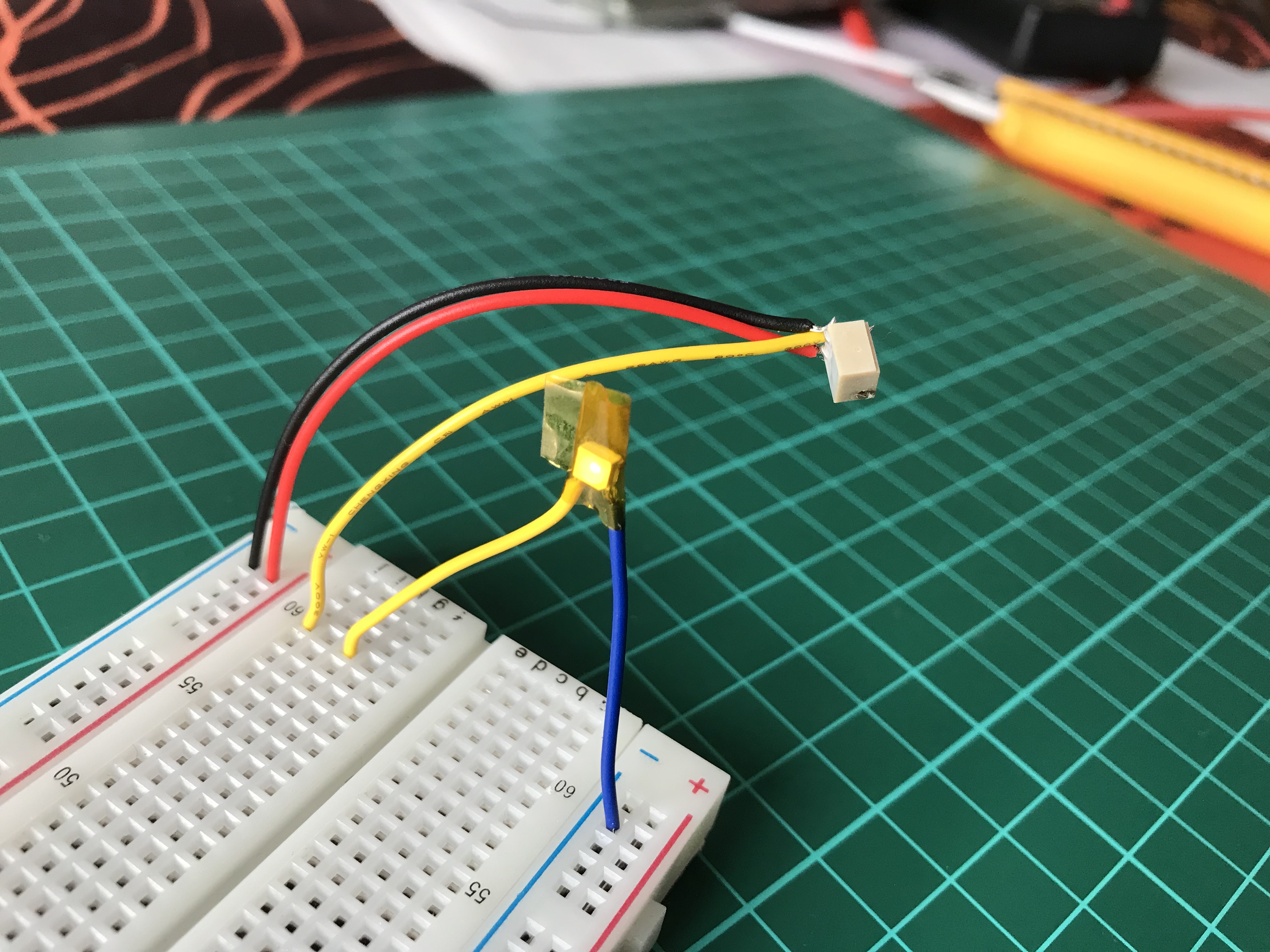

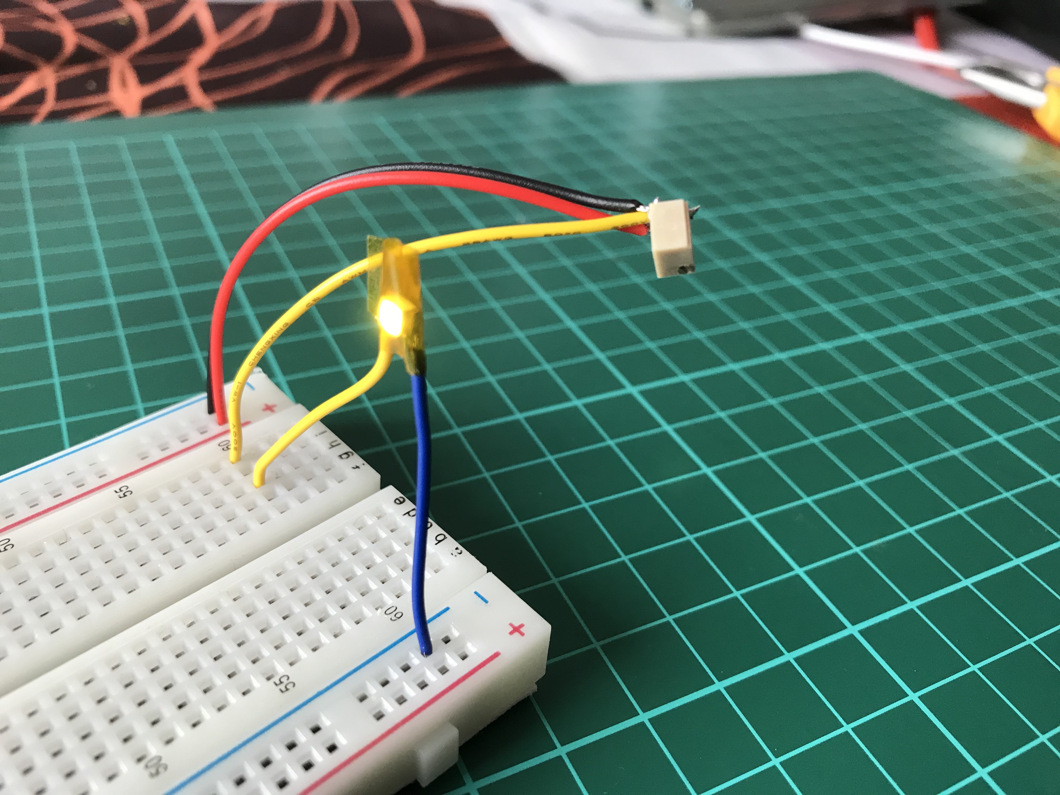

update 05/10/2017
The really not useful LEDS for the bling bling effect
I received today my pot to dim the LEDs i am about to add inside the build just for the bling bling effect, for the challenge and the fun
The pot is a 500Ohm and is only 4,83mmx5,03x3,73mm
It is intended to sit in the cartridge with the setting screw accessible to dim the LEDS
The testing is ok.
Now i need to sit these in the case in parallel, like 5 or 6 of them
to make some cool shadow effects
More to come... stay tuned

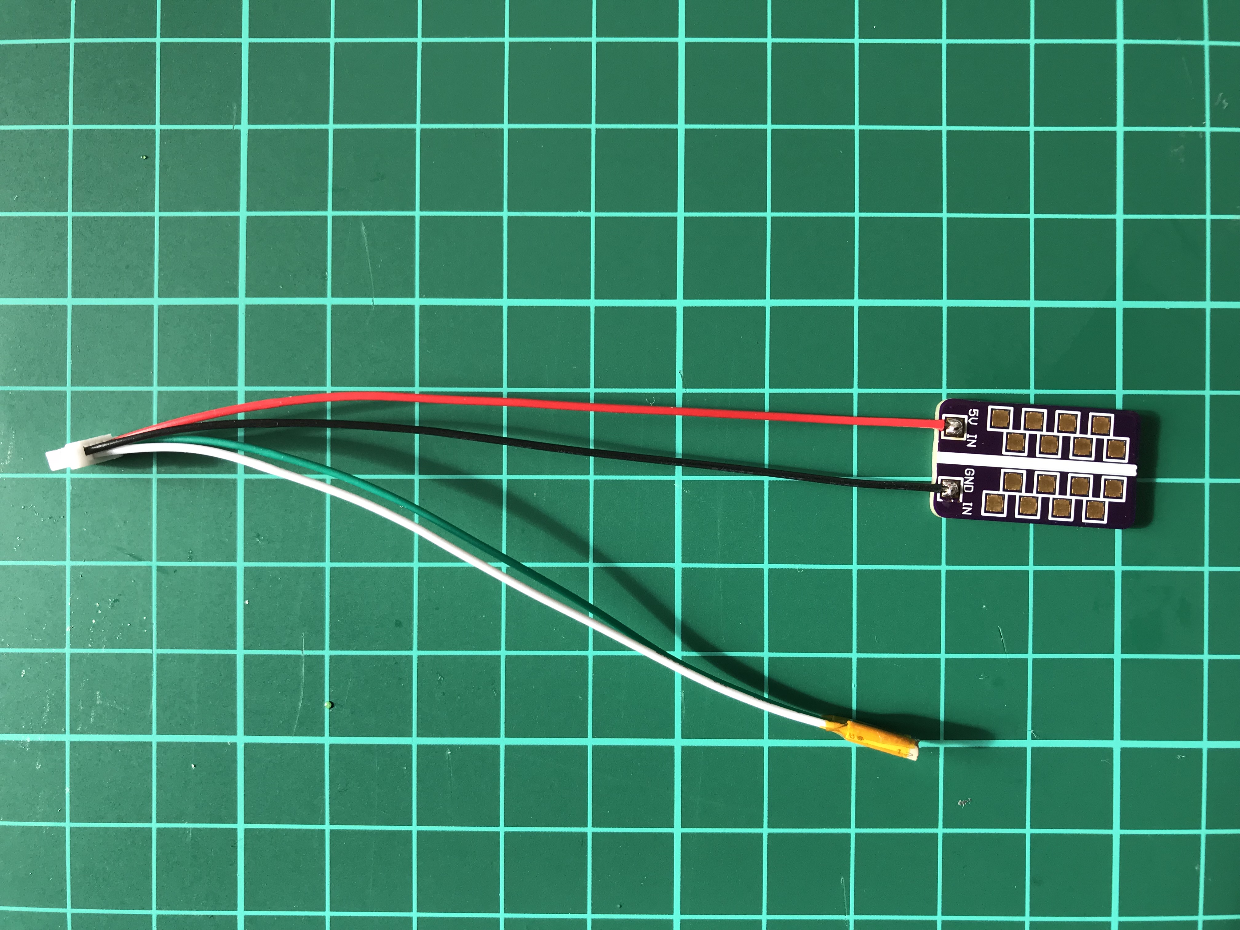

update 06/10/2017

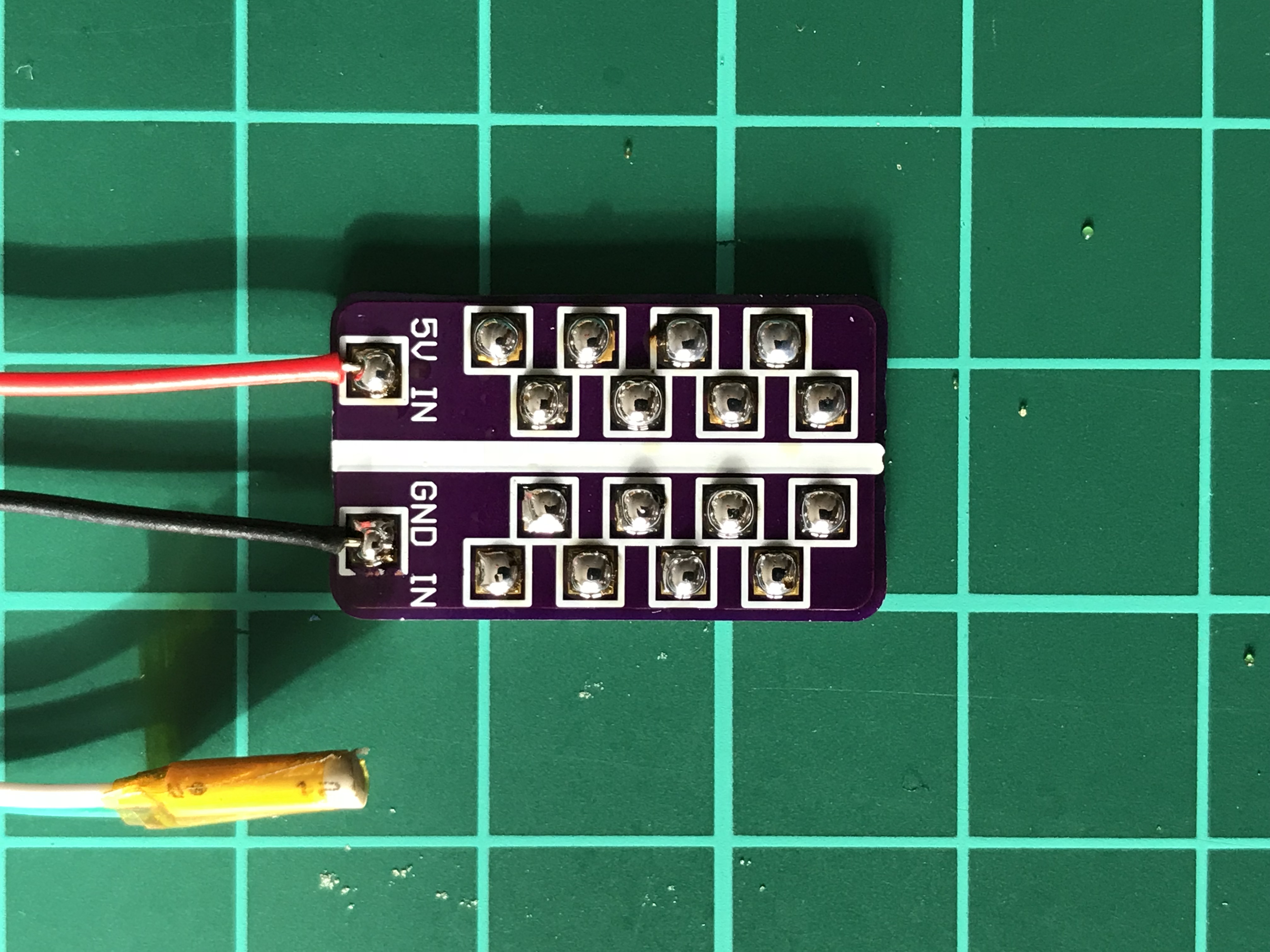

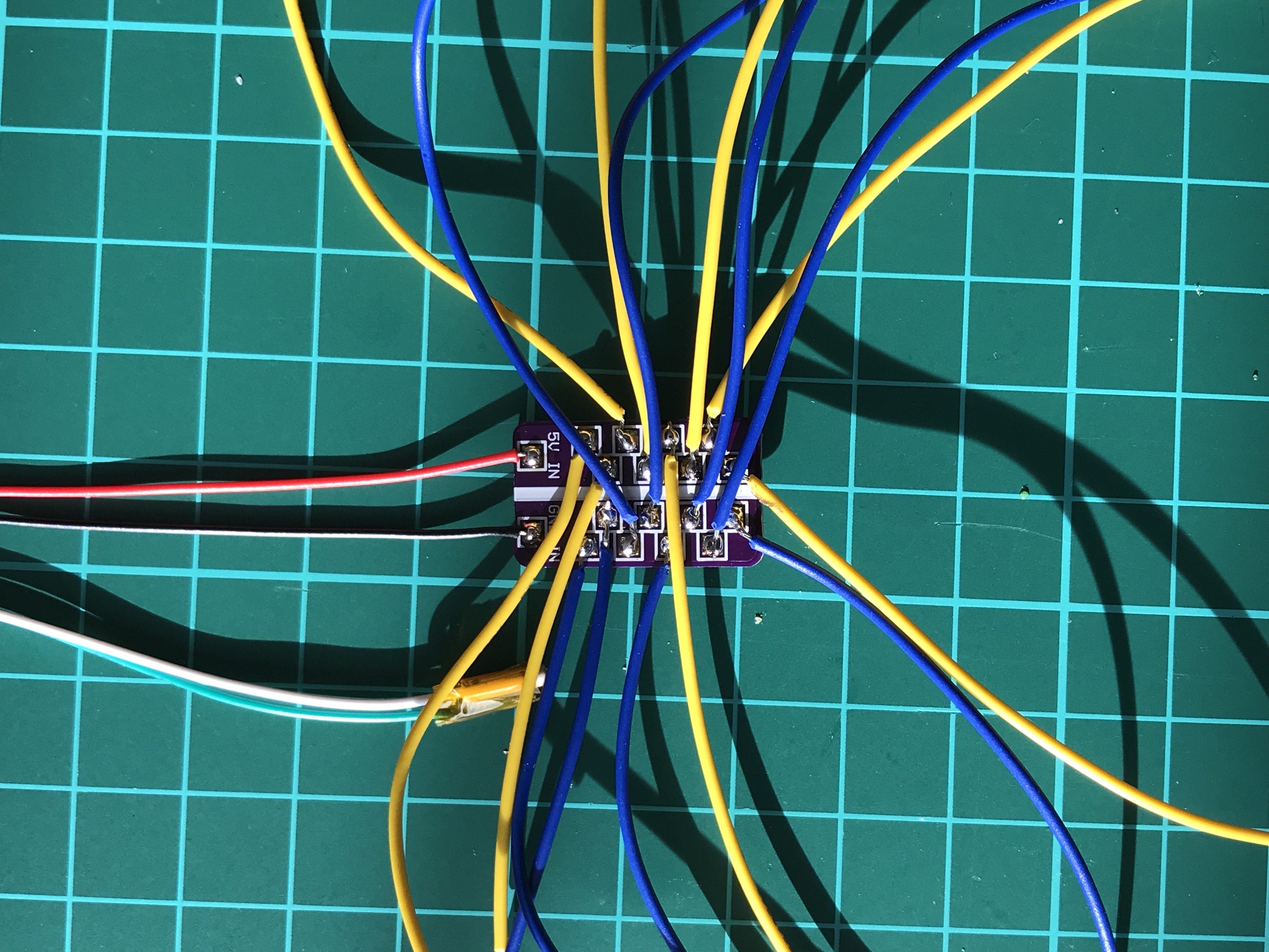

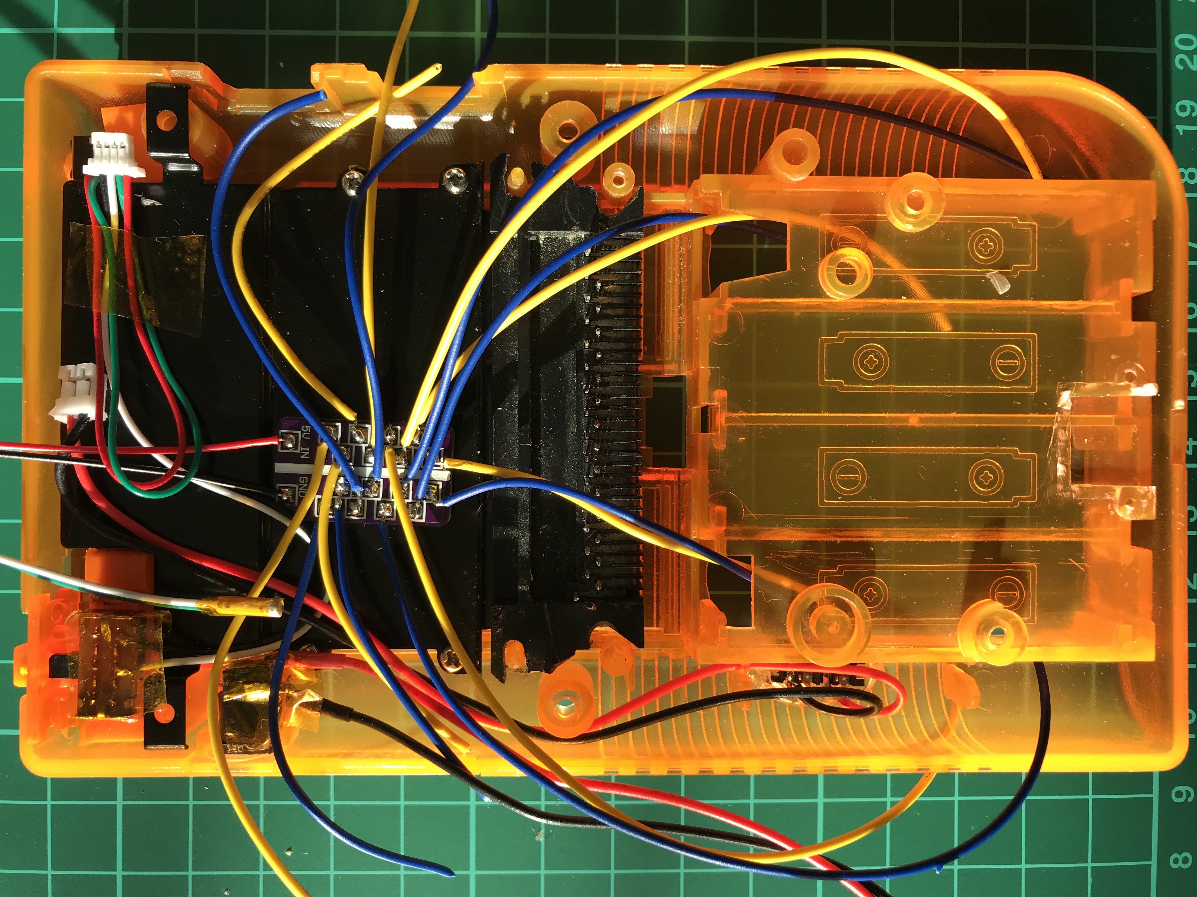

Ok, i’ve started the addition of LEDs inside my build.
Thanks to Helder for providing the power strip
I want to add 8 super bright LEDs, the power strip will be VHB taped to the cartridge metal shielding.
I am using the provided USB extension cable delivered with the board that i won’t use and plug it to the inboard USB Hub to retrieve 5V.
I made a mistake as i have soldered the JST connector to the power strip but it must instead be soldered to the cartridge connector to power the pot, and from the pot, back to the power strip
Too much hurry
The testingShow
Pot at 40%Show
Pot at 80%Show
The testing is ok.

update 06/10/2017
Too much hurry

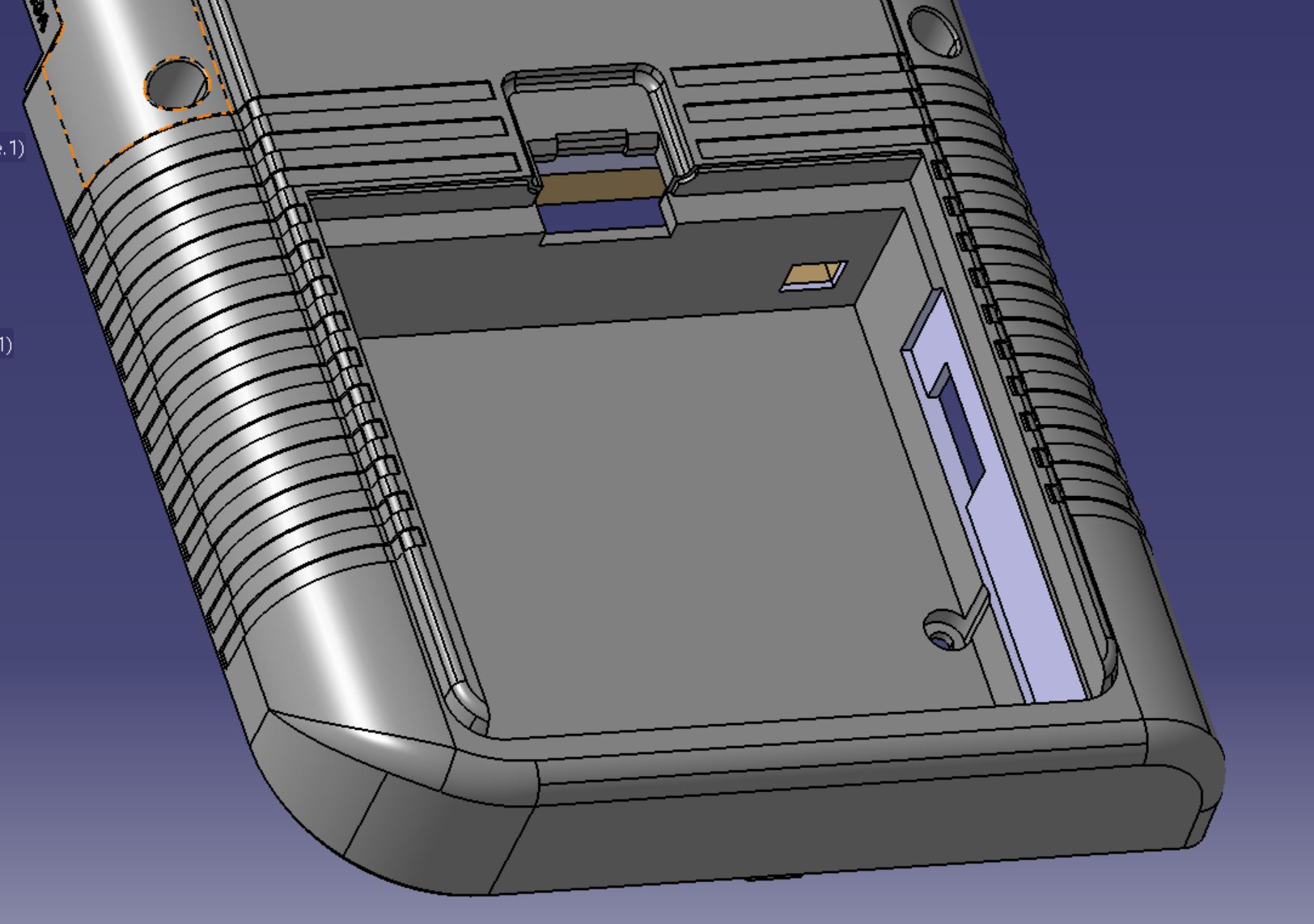

Re: YaYa's first GBZ - Kite's SAIO - Big Battery - NO Glue - DC Jack - minimum case mod
Really, really great job.
I would be also interested in your pogo pin bracket STL as I want to go the same way.
What kind of pogo pins you are using? Which battery are you using? I think its the same as me with 4800 mAh.
I have designed the battery bay to fit Dextec`s battery as well as the Samsung one. Dextec`s Battery will have a connector in the bay to easily disconnect. Right now I still didnt select the right Pogo Bracket.
Im also using the SD-Card in the Cartridge so Im also interested how you wired all that stuff in with the Cartridge Reader and so on.
Since im not good with Linux I would be very thankful for an ready-to-use build for the SD-Card with all your tweaks.
Are you using Pie Zero W?
reipet wrote: ↑Fri Oct 06, 2017 3:16 amReally, really great job.
Thank you for your comment !
Yes, i am using the Pi Zero W.
I will look for a way to make a script to automatically do my optimization or put them in a package or why not, integrate them in a full image. Didn’t dig yet in any way.
The SD Card is not yet connected as mentionned earlier, i’ll deal with this this weekend and post here the log
The battery i am using is this one
http://www.mbuynow.com/4800mah-replacem ... p-843.html
The pogo pins i am using are these ones
http://s.aliexpress.com/z6f22E7n
As for the STL, i should receive my first prototype today, if it’s okay, i’ll share them
Stay tuned, i have more to come.

update 06/10/2017
For those willing to use it, it is available on OSH Park for less than 4$ for 3 of them.
Follow this link http://www.sudomod.com/forum/viewtopic.php?t=1187
You can read my update by following this link
http://www.sudomod.com/forum/viewtopic. ... 327#p46327
