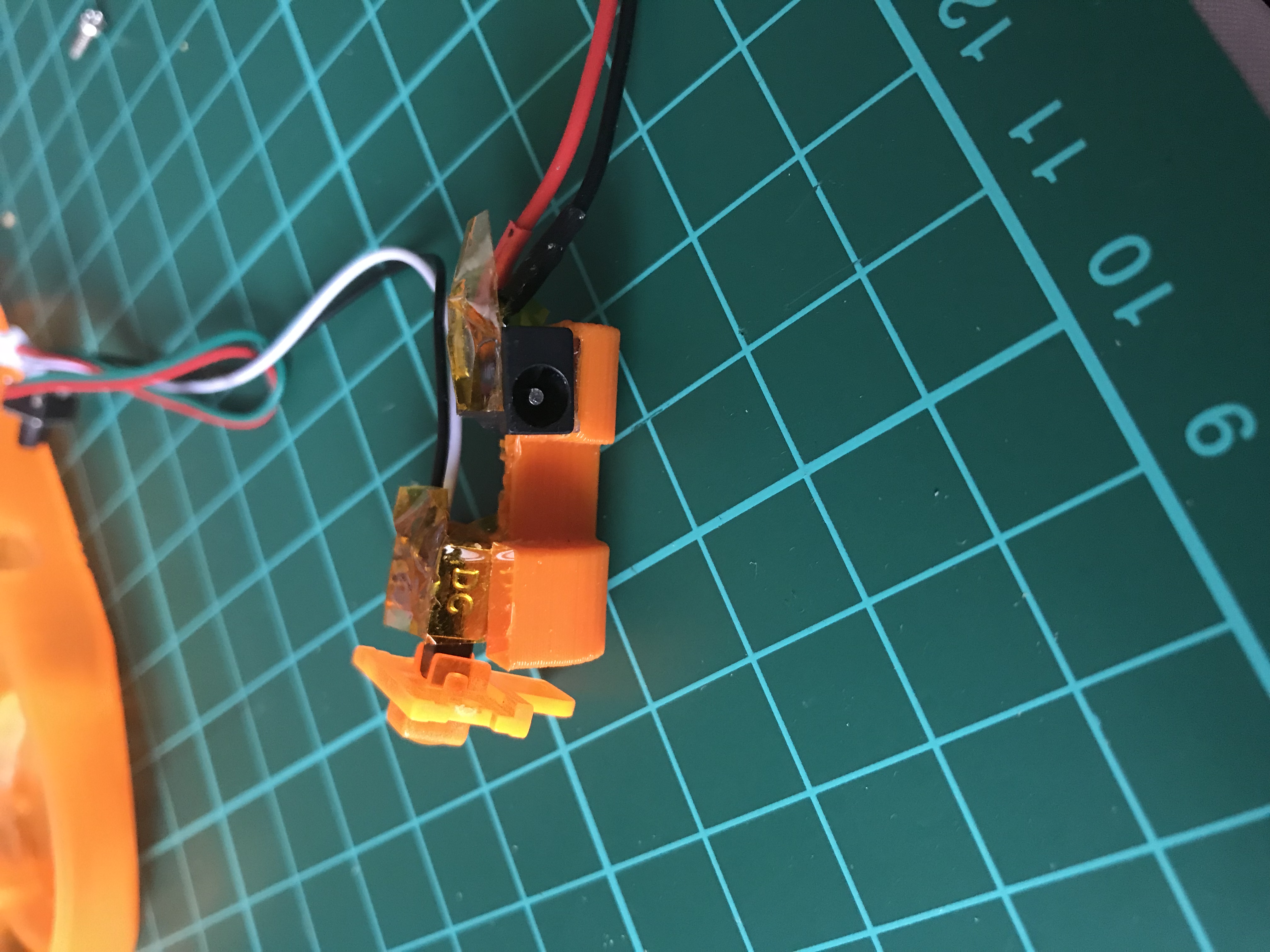

Where do you connect the DC-Jack? Very good thread.
Re: YaYa's first GBZ - Kite's SAIO - Big Battery - NO Glue - DC Jack - minimum case mod
Post by YaYa » Tue Oct 24, 2017 2:23 am
moooarcuuuus wrote:
Tue Oct 24, 2017 12:55 am
Thank you very much Mooarcuuuus ! :D
The DC barrel plug is connected to the pads just behind the power in micro usb on the SAIO.
On the above picture (taken from Kite’s wiki), those are the pads between the HDMI, USB and SD. These pads are the extension of the power micro usb port. So i’m not using the micro usb port and did not cut the hole for it and instead i put the DC barrel i to the classic hole and hold it with my custom support.
Tonight i will share the stls.

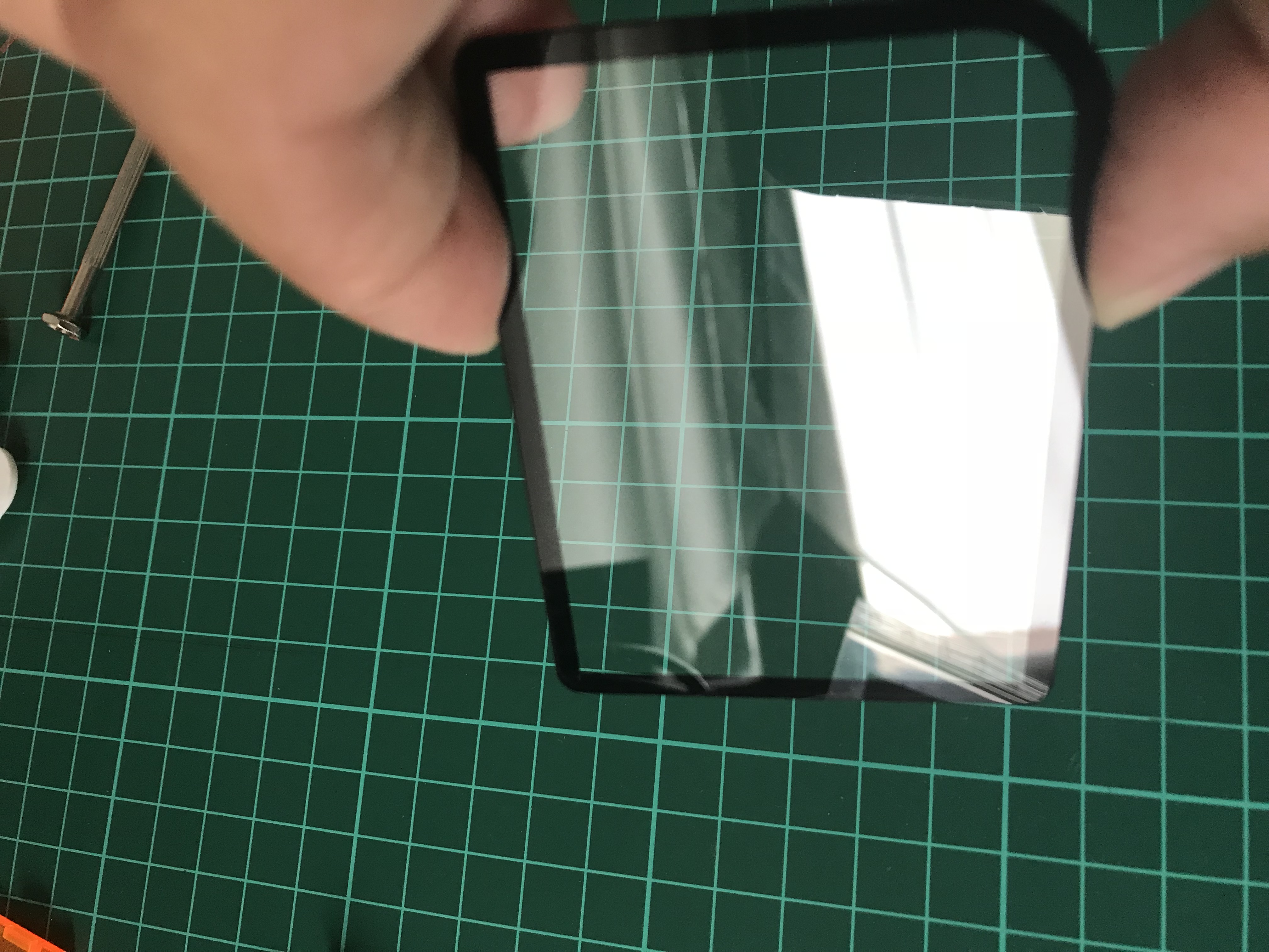

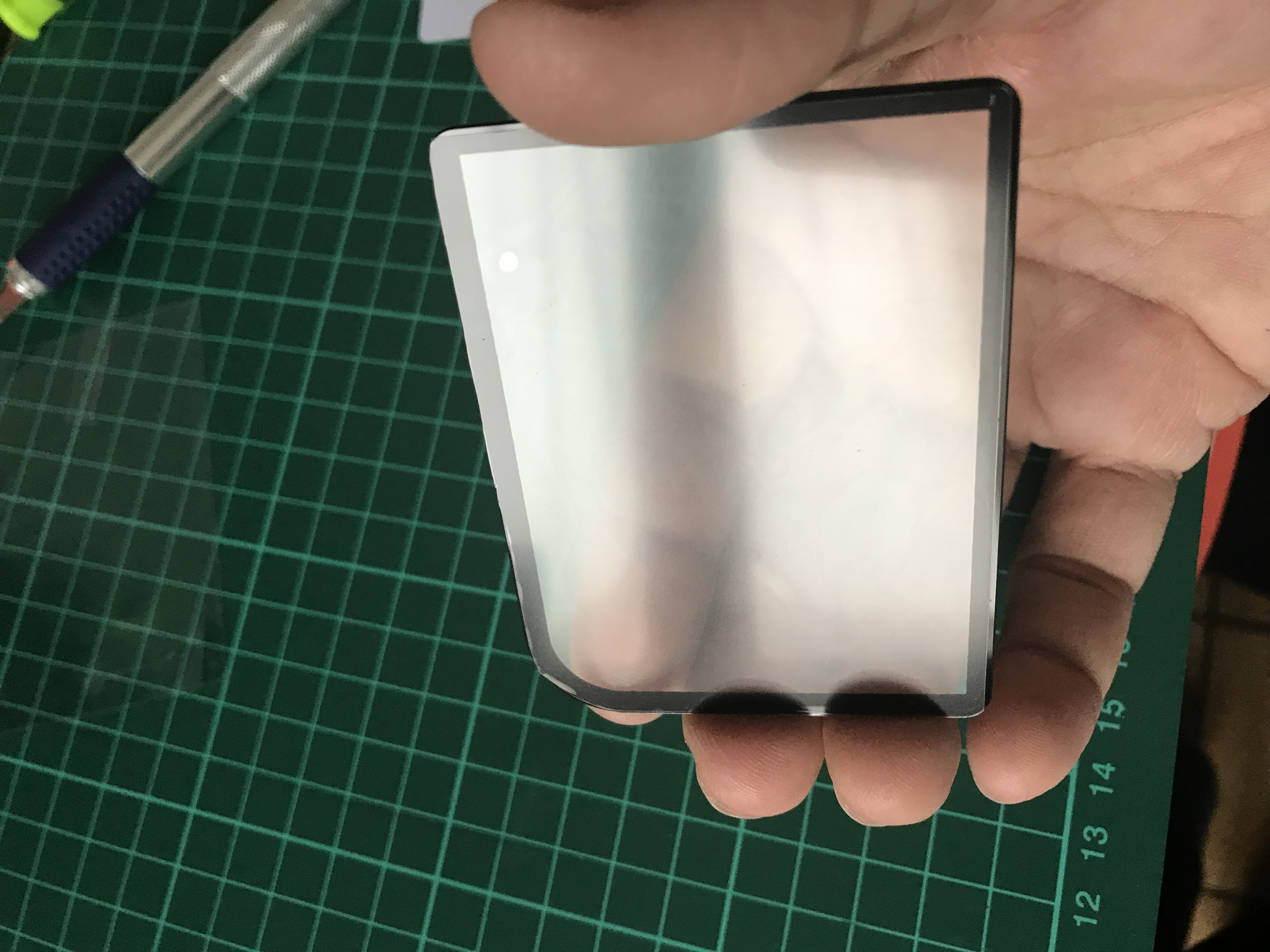

I was just a lot disturbed by the glares on the glass screen so i have decided to go for a laptop screen protective plastic shield with anti glare.
Before the updateShow
After the updateShow
You can notice that despite all my attentions and the use of the alcohol spray technique to make the sheet slide, i managed to capture a bubble (actually cause by a cloth dust :twisted: )
The cutting was a bit hard and now that i have the right technique, as soon as this one gets scratched, i'll do it even better :D

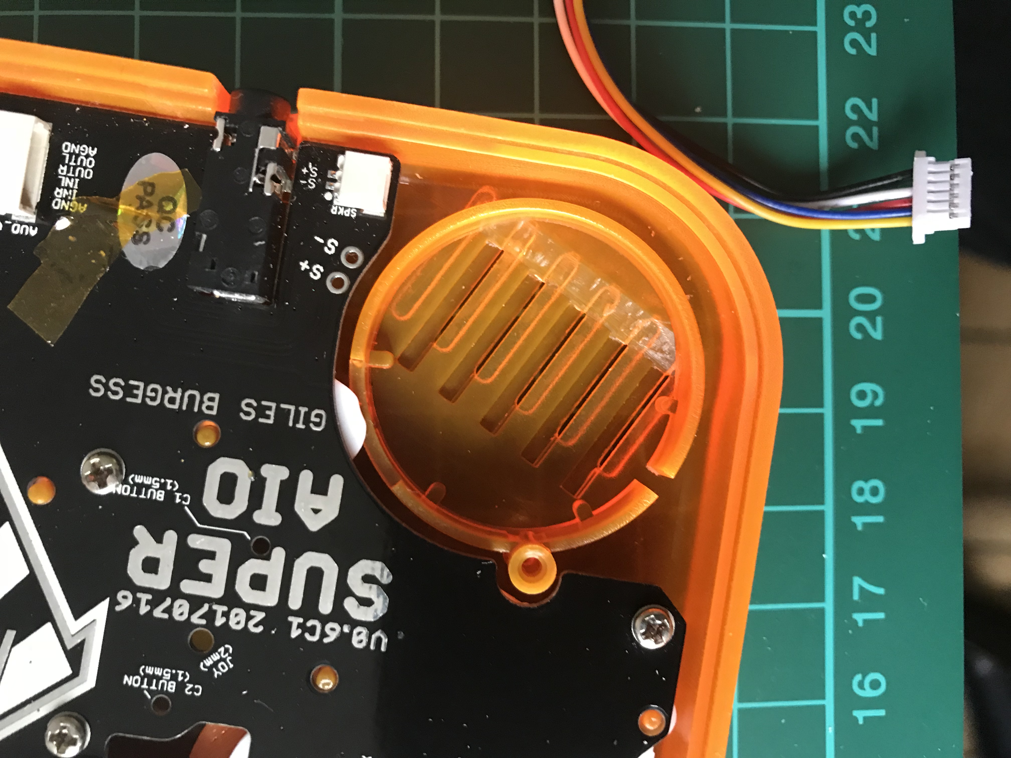

Speaker housing tray without modificationShow
Speaker housing tray after modificationShow
I'm my quest for zero glue and no screws nothing invasive, i've decided to tight fit the speaker in the original site. I slightly grinded the round shape to take around 0.5mm from all round the circle, and i just push fit the speaker in it and voila. It's so tight that i need to use a flat screwdriver as a lever from the cut you can see.
Here is the speaker i am using
https://www.aliexpress.com/item/4PCS-Sp ... 08263.html
DC barrel jack and power switch supportShow
Home made design to use with
https://www.aliexpress.com/item/10Pcs-H ... 57484.html
and
https://www.aliexpress.com/item/Free-sh ... 52393.html

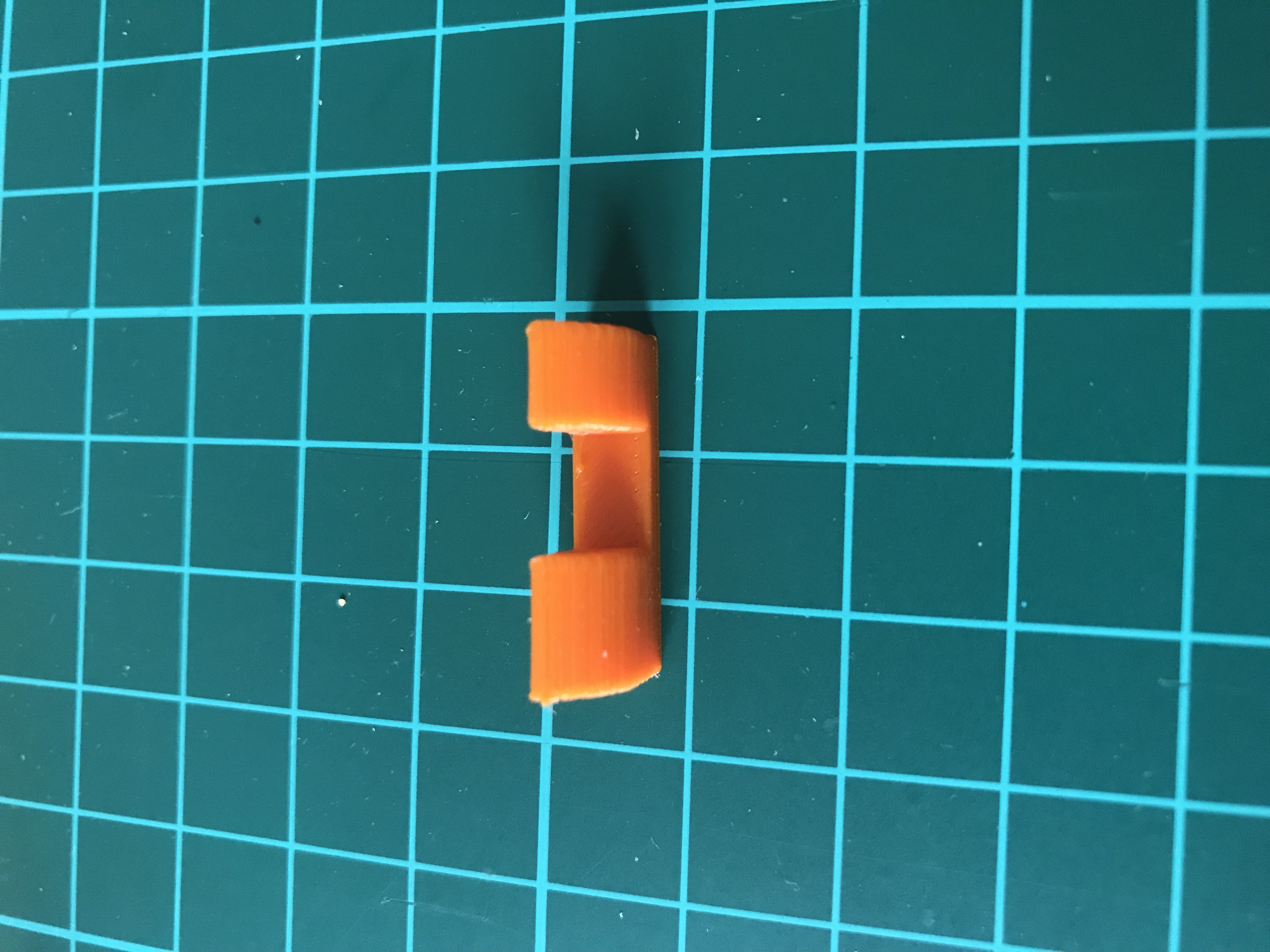

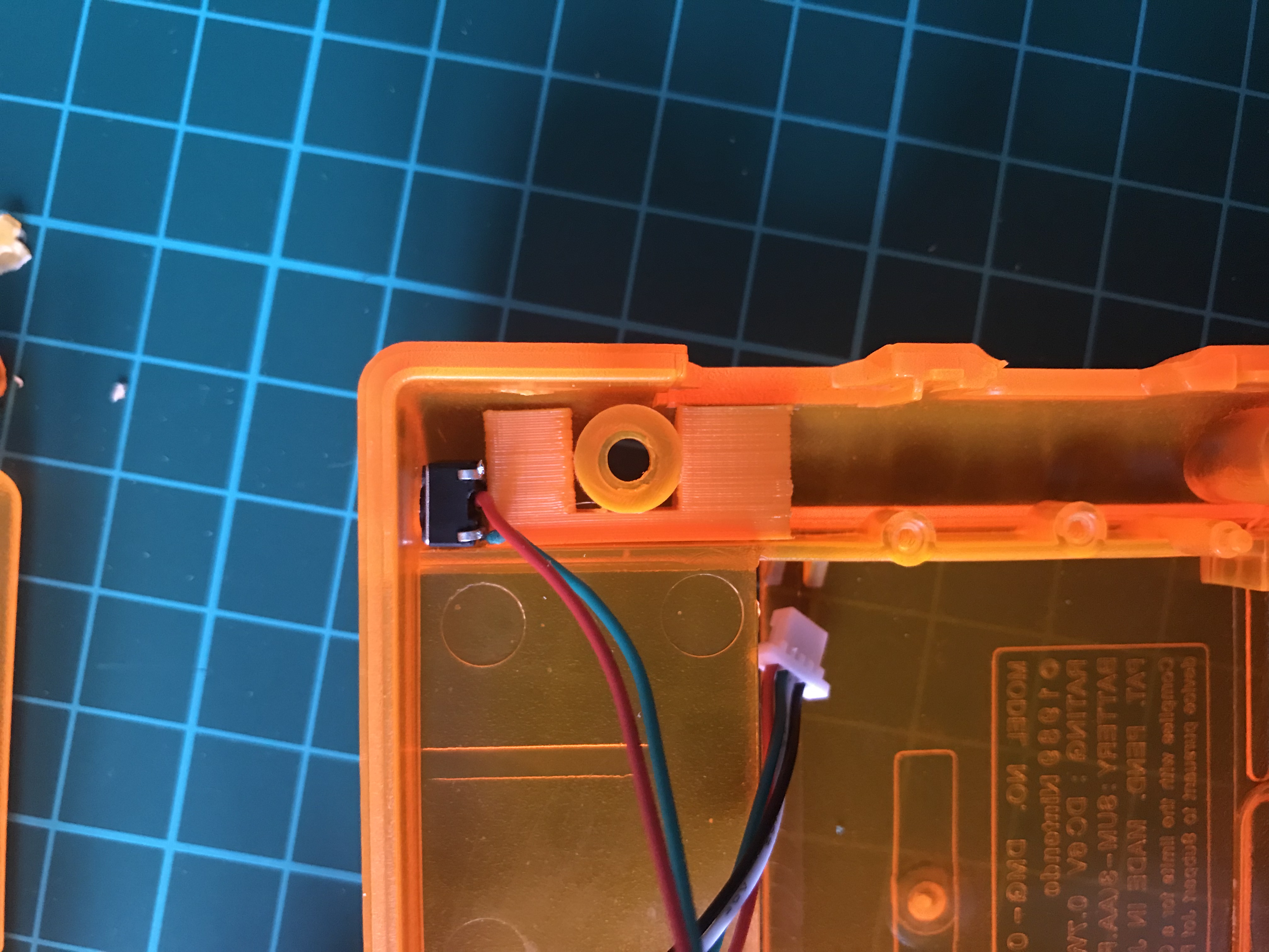

The mode button supportShow
Again, zero glue here. The button i have used
https://www.aliexpress.com/item/50PCS-6 ... 69199.html
I have grinded the button to make it shorter.

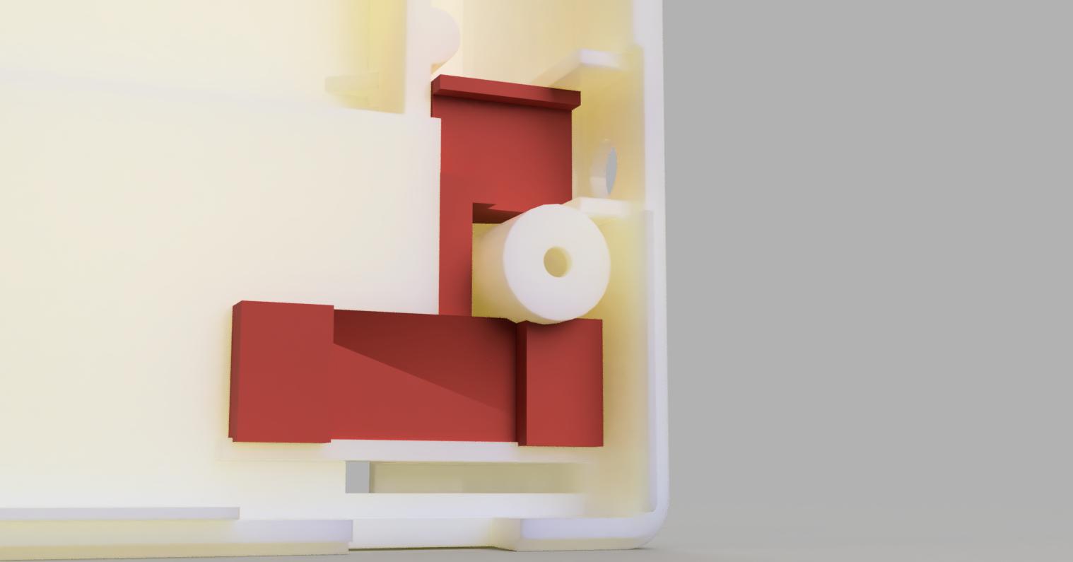

THE DC BARREL AND POWER SWITCH SUPPORT :mrgreen:
power-switch-support.stl
(110.59 KiB) Downloaded 635 times
switch and barrel support.jpg (35.65 KiB) Viewed 13175 times
Designed for use with this DC Power Jack Socket Connector https://www.aliexpress.com/item/10Pcs-H ... 57484.html
and this High Side Toggle switch 2P2T 2 Position Slide Switch https://www.aliexpress.com/item/Free-sh ... 52393.html

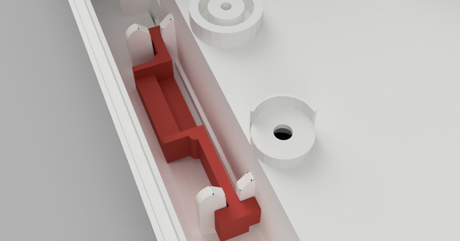

THE POGO PINS SUPPORT (W.I.P. design not finished, not yet 100% functionnal) :mrgreen:
battery-connector-support.stl
(27.3 KiB) Downloaded 565 times
pogo pins support.jpg (36.54 KiB) Viewed 13175 times
This support is designed to use with the aftermarket Samsung Galaxy S2 pogo pins
https://www.aliexpress.com/item/10pcs-l ... 75669.html
THIS IS STILL A W.I.P. so please don't blame me if this is not working for you yet :D
THE POGO PINS SUPPORT V2 (W.I.P. design finished, not yet tested as i'm waiting for the 3D print) :mrgreen:
battery-connector-support-v2.stl
(58.76 KiB) Downloaded 579 times
pogo pins support v2.jpg (42.31 KiB) Viewed 13041 times
The difference from V1 is the pogo pin being used reversed upside down so that the pins can bend in the correct direction (from up to down)
I have removed 2 small pieces of material so that the holder can sit a bit further down, this will allow a better vertical alignment between the battery pads and the pins (now it's all centered)
I have removed some material from the front for the same reason.
Added a "wall" behind to support the back of the pogo pins (we will add VHB up this wall and on the battery side of the wall so the pogo pin will slide and stick on top, preventing it to lift, move right/left, and back)

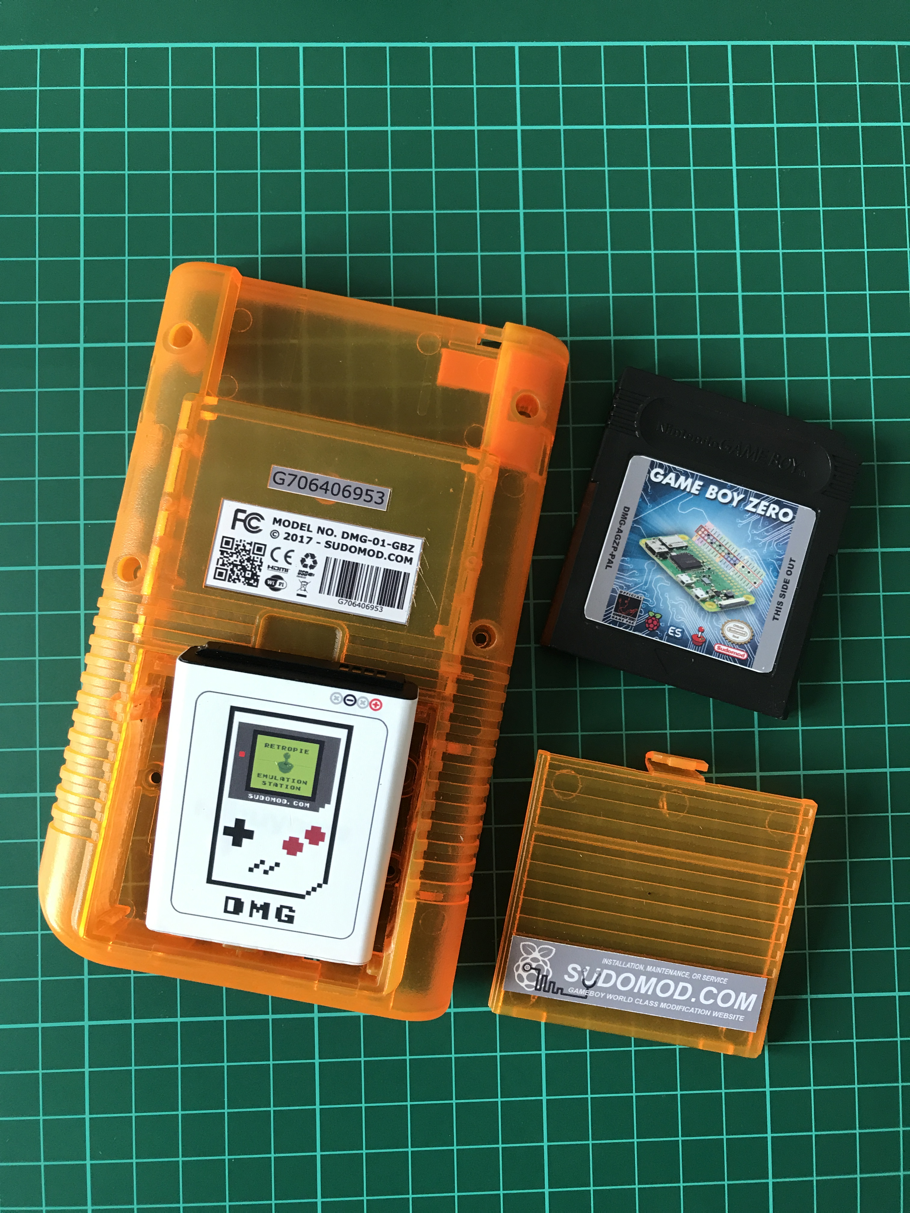

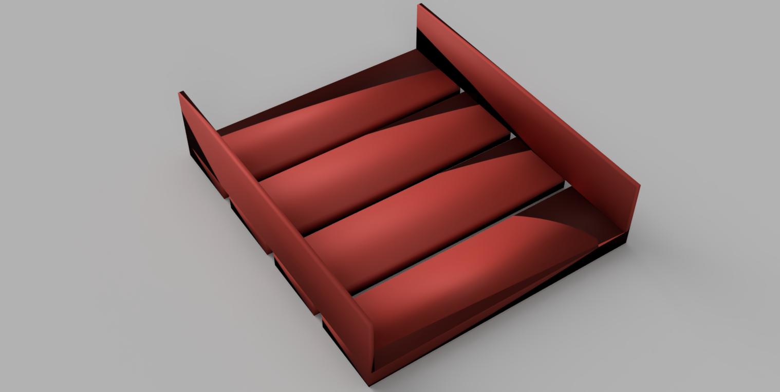

THE BATTERY HOLDER :mrgreen:
lipo-support-v2.stl
(17.07 KiB) Downloaded 578 times
battery holder.jpg (44.18 KiB) Viewed 13041 times
This support is designed to be used with the aftermarket Samsung Galaxy S2 batteries. It allows the battery to be hold tight in the compartment and also it's a guide to see where to grind the sides :mrgreen:
The bottom gives you the bottom level for grinding, the left and right walls, gives the right and left limits to grind
If you find those files useful and think that it deserves it, please support by making a donation. Nothing mandatory, you are free. Any amount will be greatly appreciated.

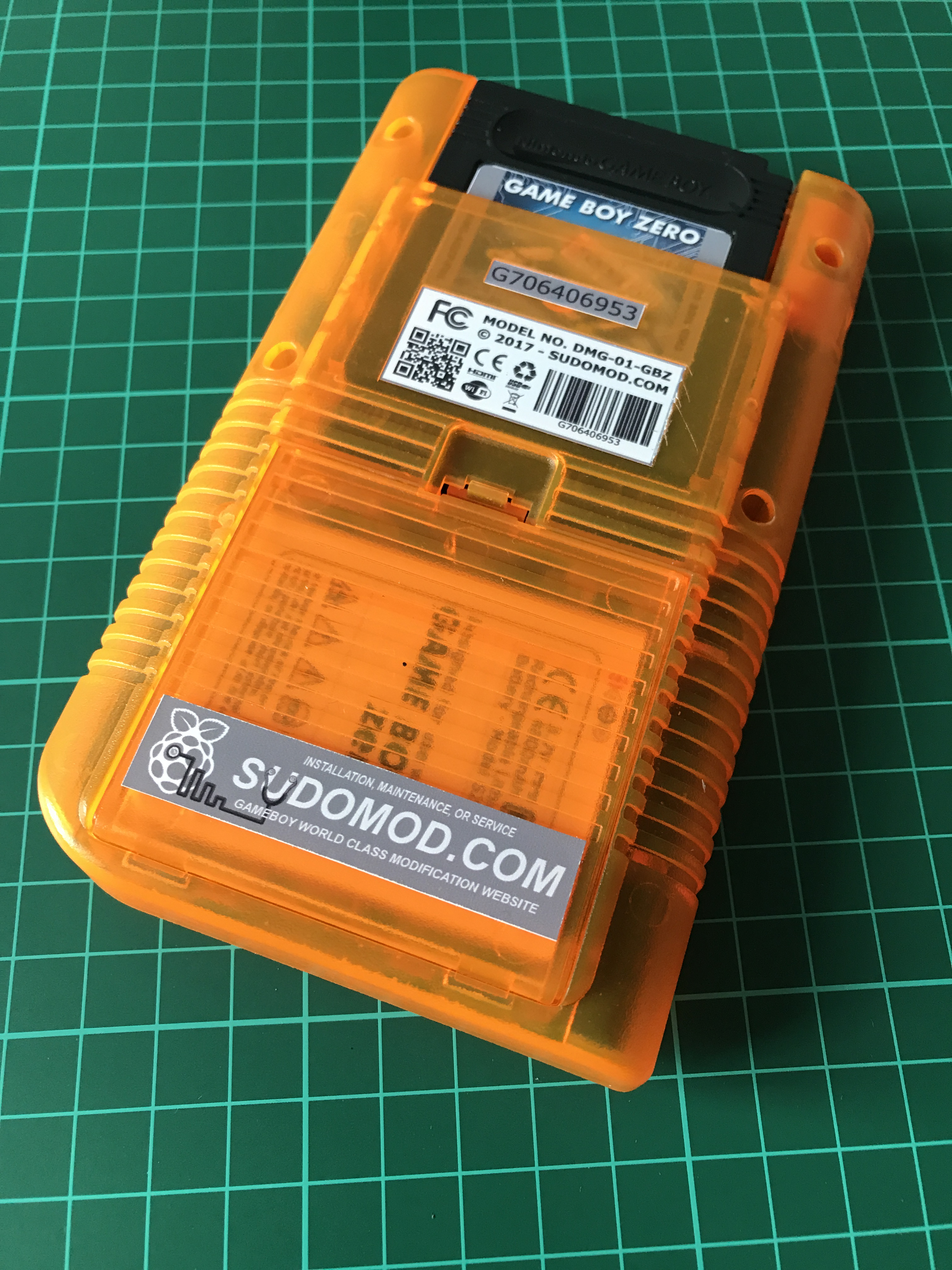

Post by YaYa » Tue Oct 24, 2017 12:53 pm
Tests prints of the stickers.
I have a sale thread opened for those stickers factory printed. More information here
viewtopic.php?f=40&t=3752
