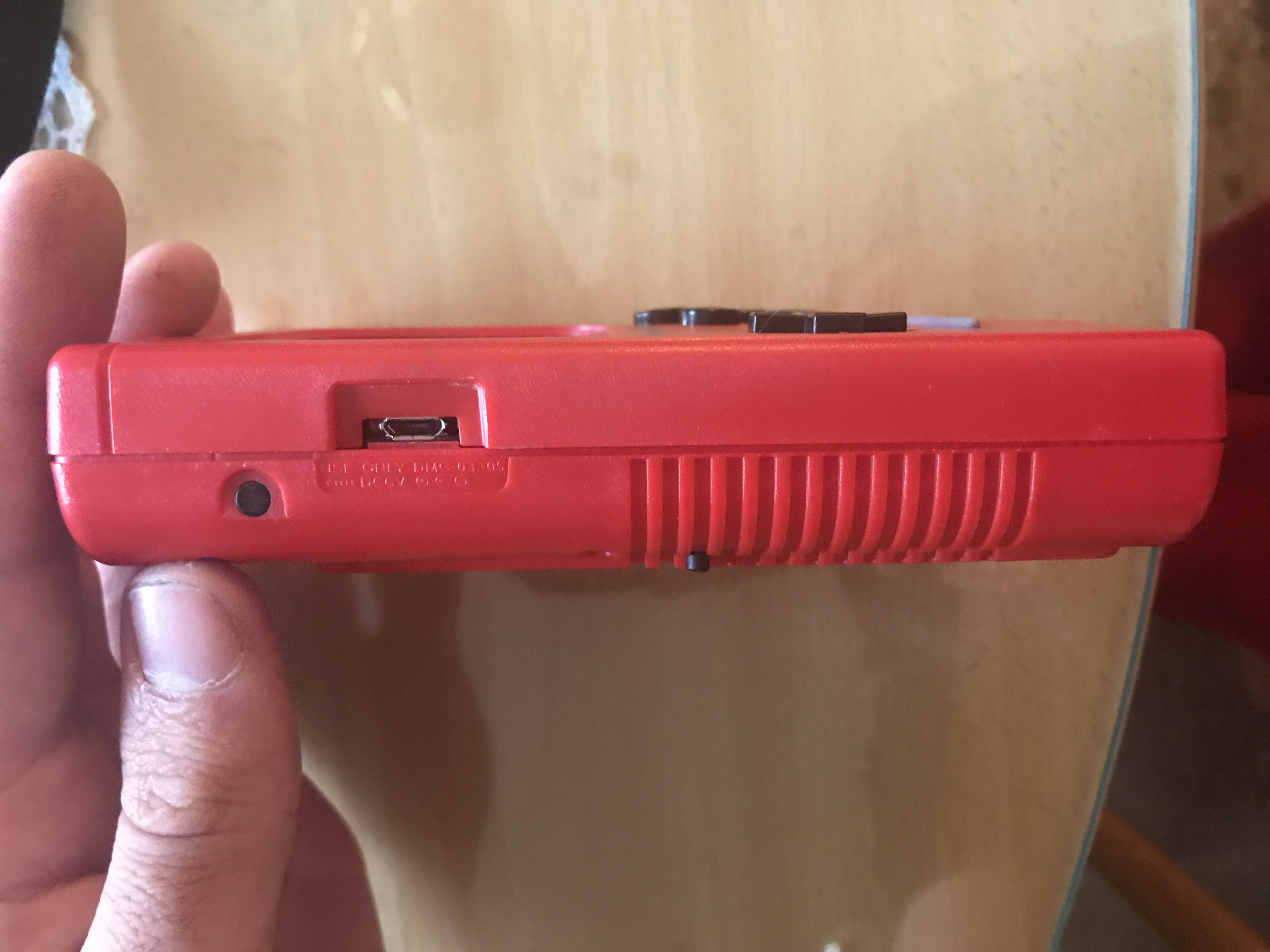

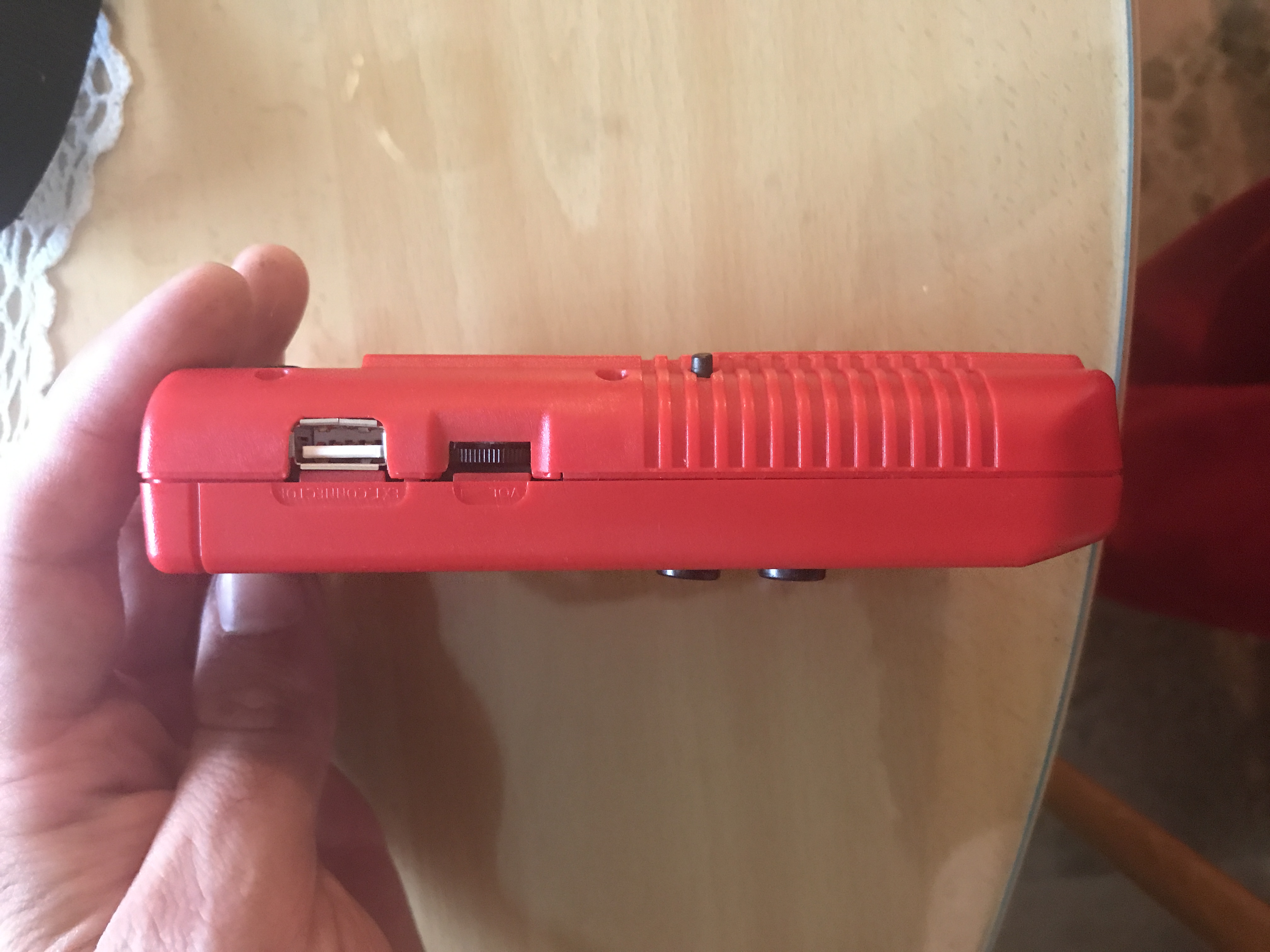

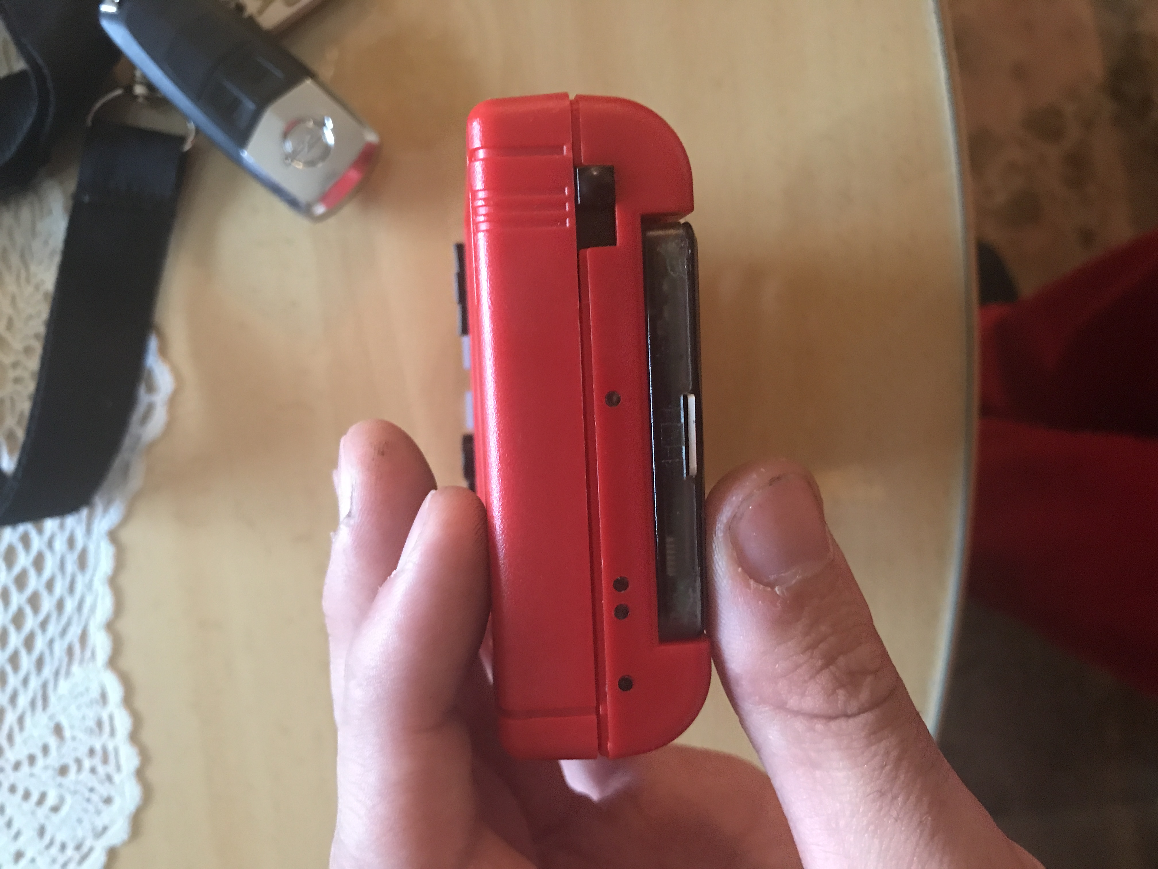

Hello sudomoders,
First I want to thank all the members of this forum for their contributions because without them it would have been impossible to carry out this project.
I decided to use a raspberry pi3 I had at home, but I assure you that in future projects I will use a Gameboy zero :lol: , it is very difficult for a beginner to put a raspberry Pi 3 inside a Gameboy.
I spent hours reading and seeing images of gameboy constructions, I liked banjokazooie projects, especially their order and cleaning, so mine is quite similar in distribution of components.
In my construction, all components are screwed, can be disassembled if needed, I have used very little Hot glue.
If anyone wants the list of components I put it here, but are "typical".
After a few weeks of hard work, I finally have my gameboy finished.

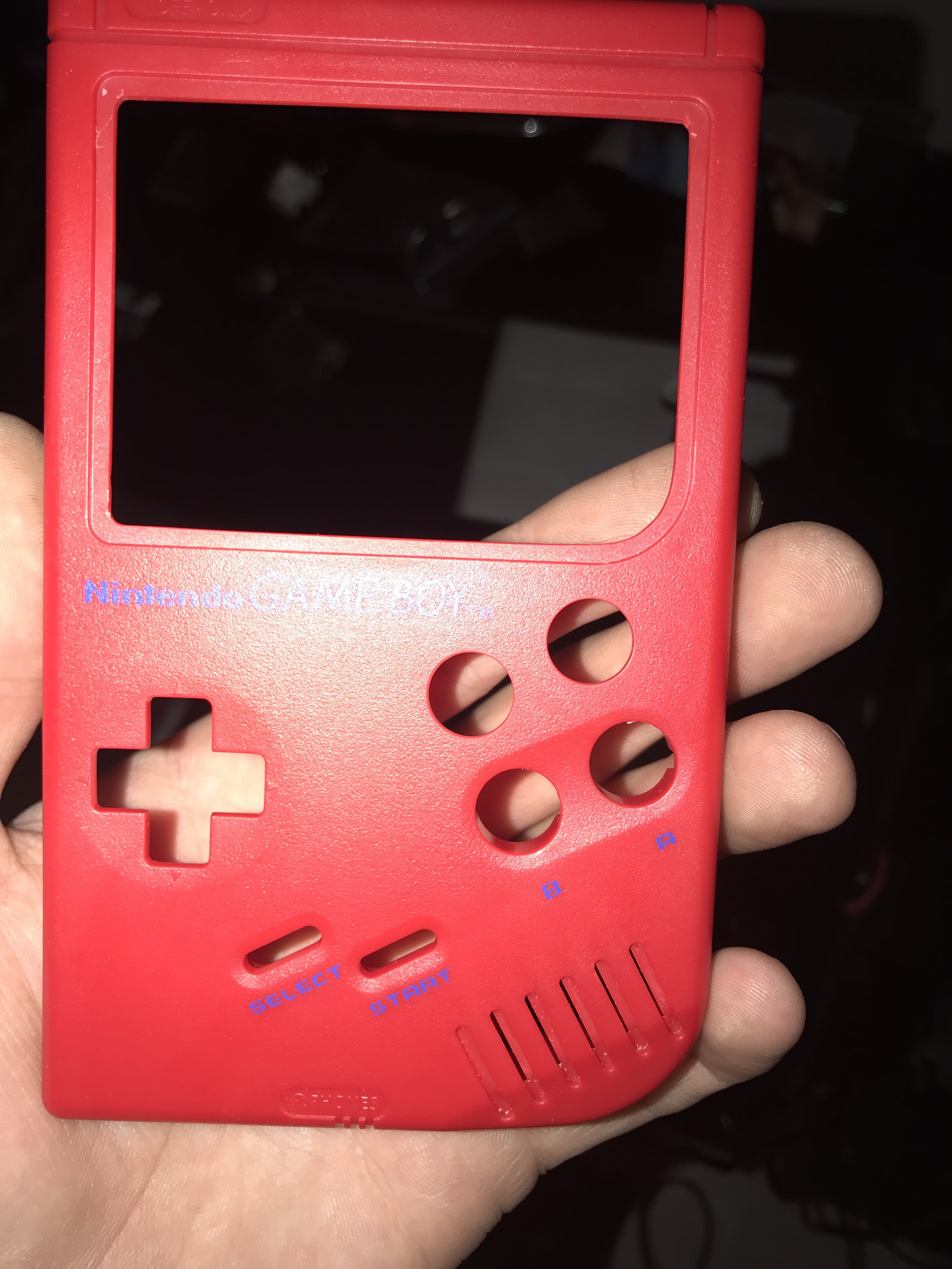

Mod case:

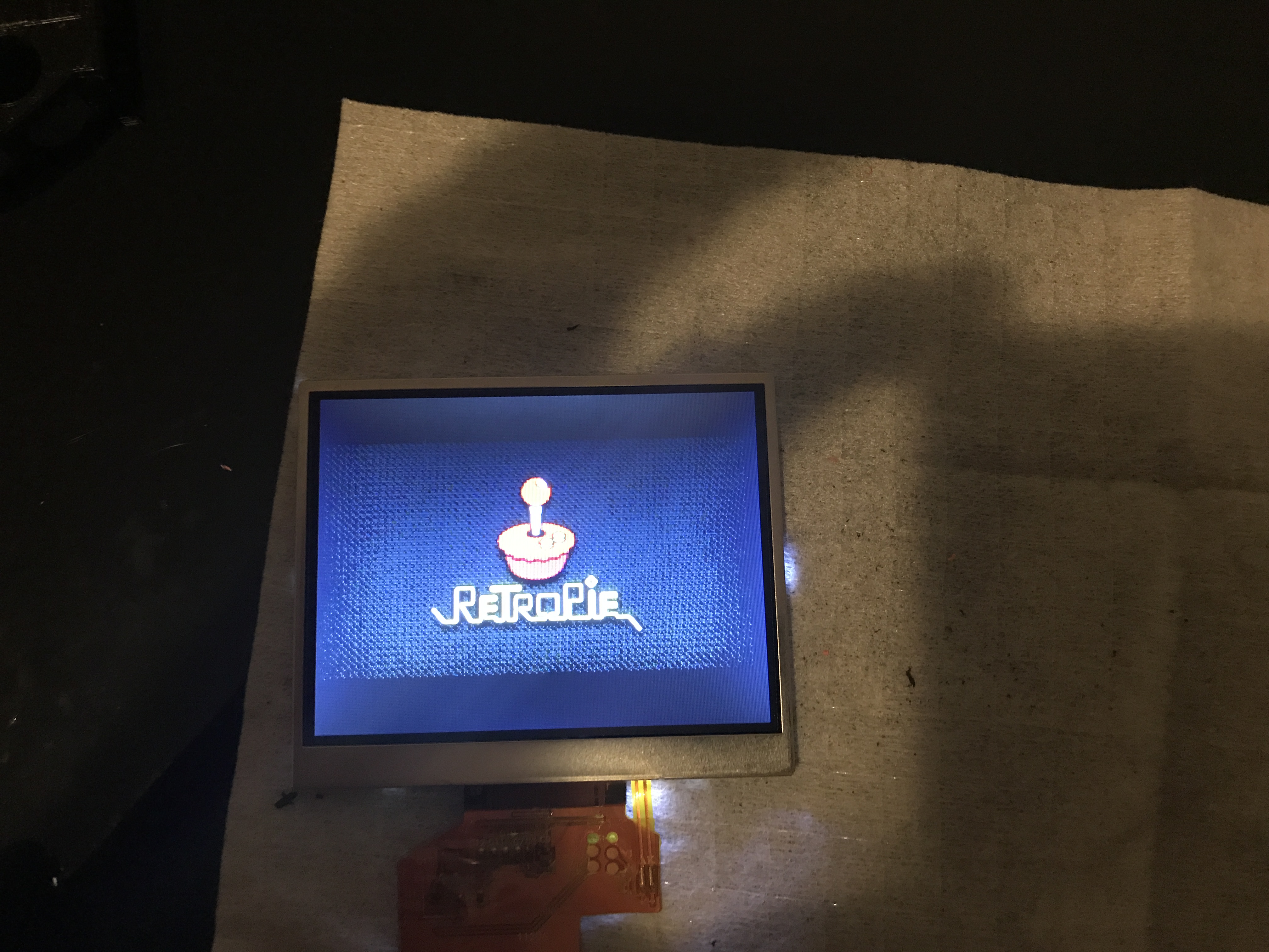

Amazon screen rear camera modified to 5V and hoolyloo's bracket with epoxy to case

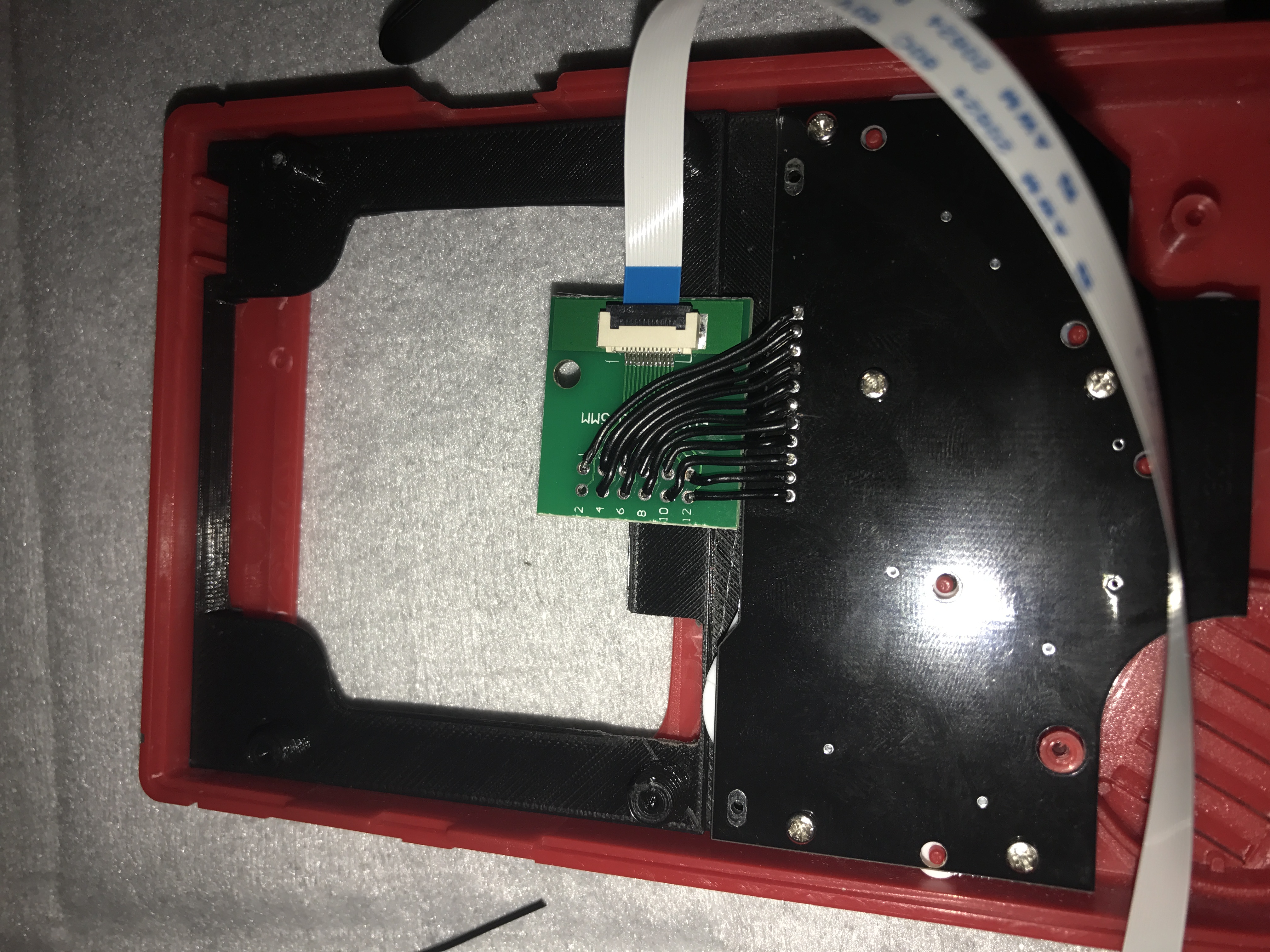

Buttons connected via FPC to arcade USB decoder:

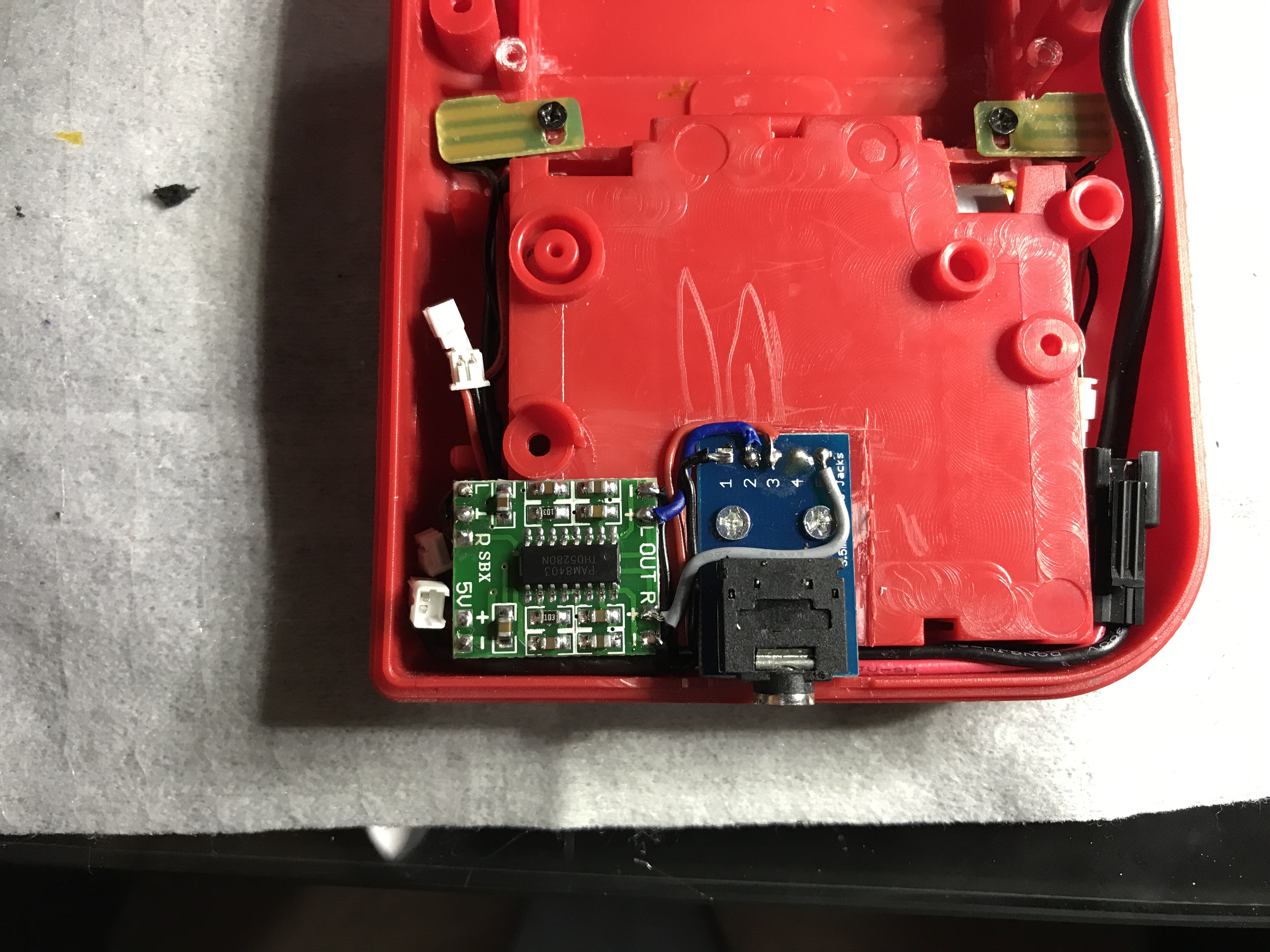

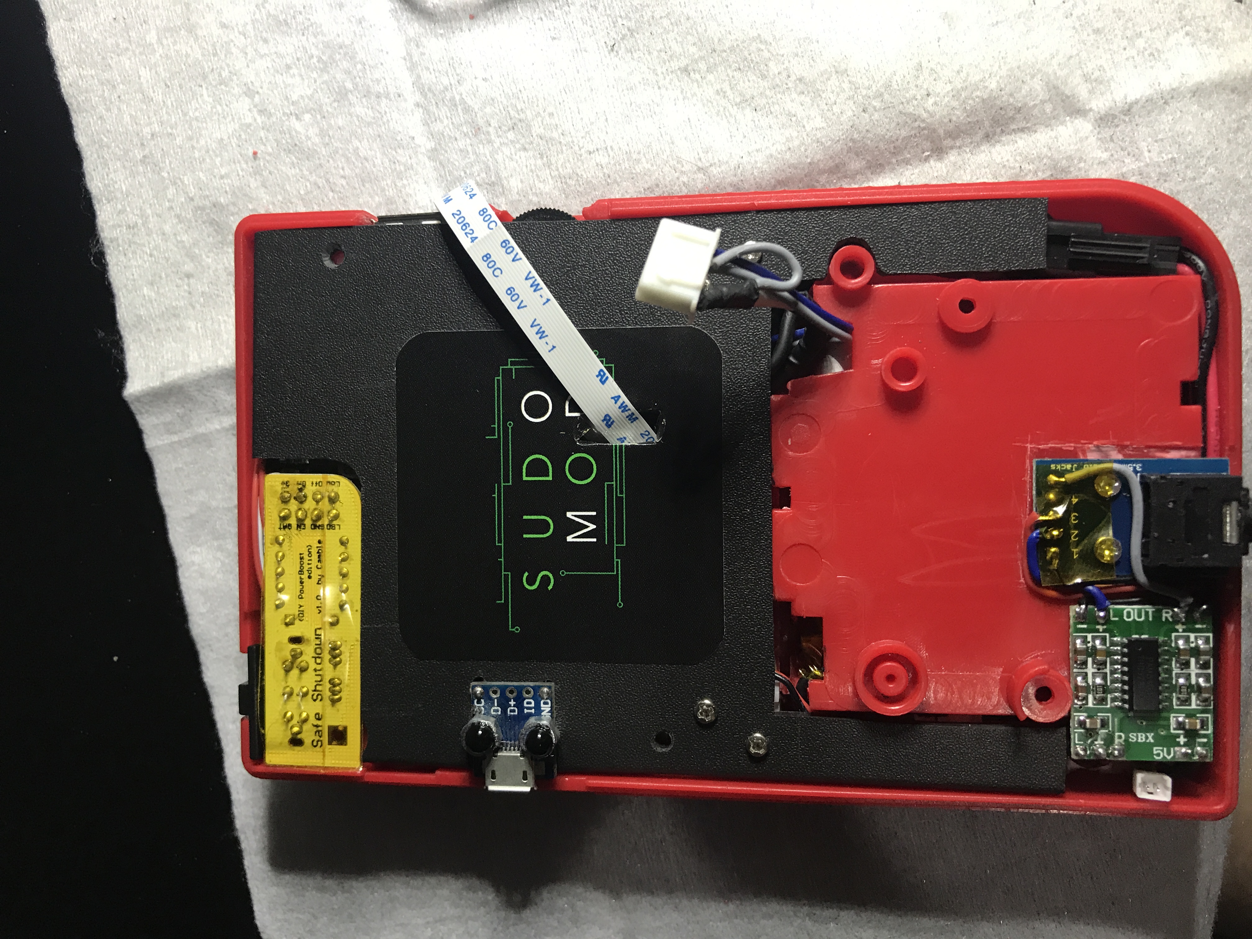

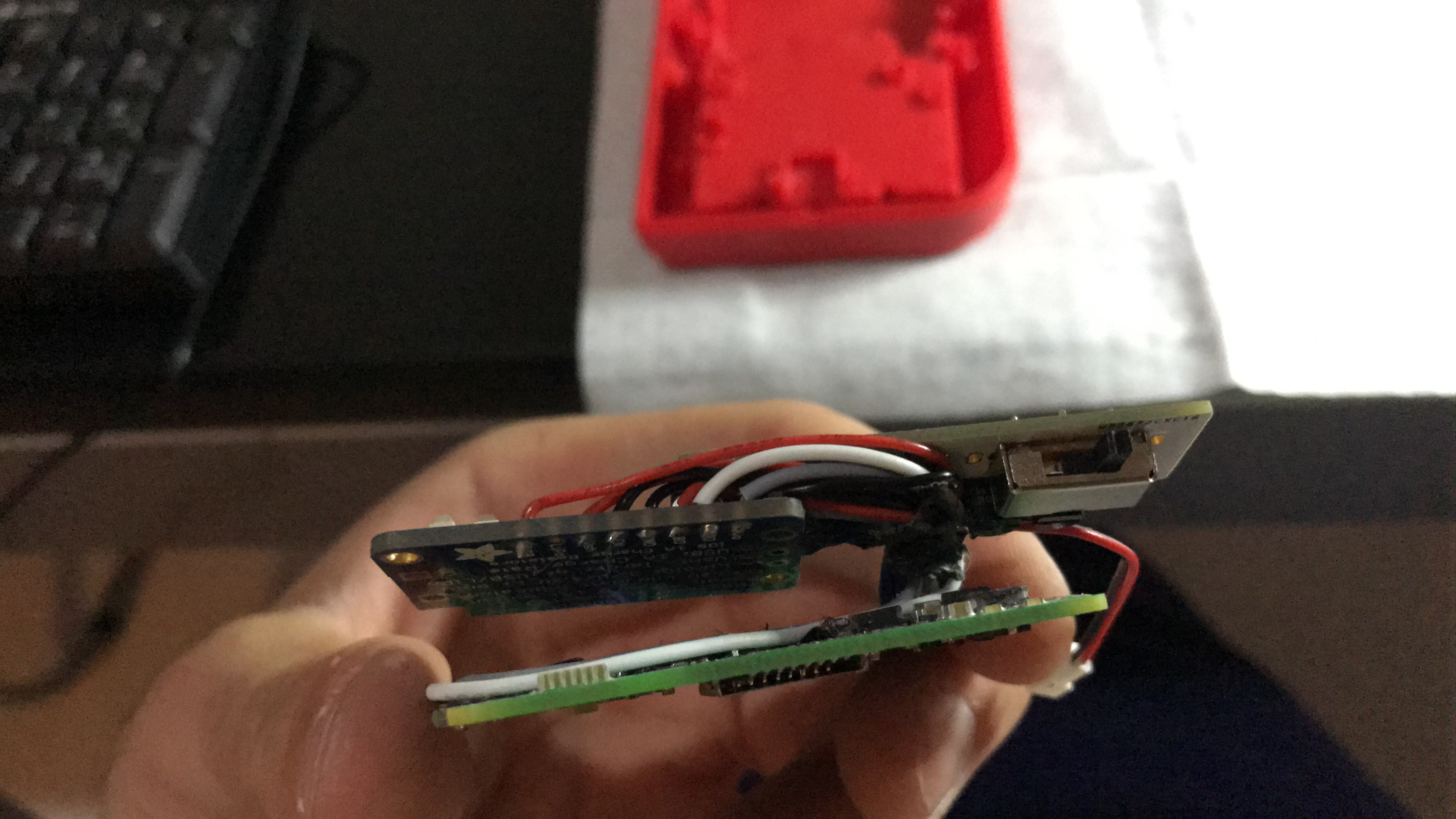

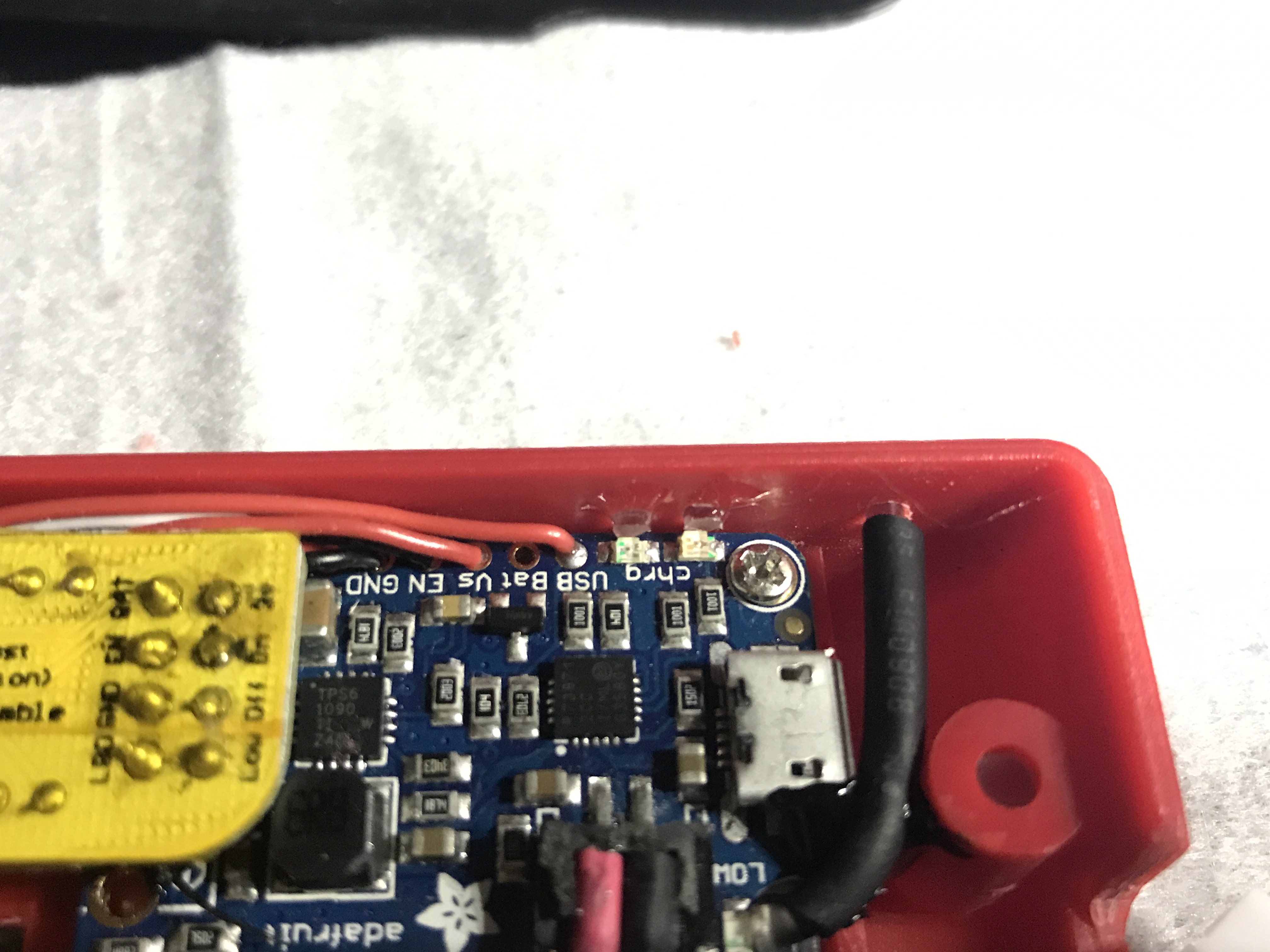

Raspberry Pi3 stripper, camble's diy shutdown, and Adradruit 1000C powerboost and modified cartridge:
USB sound card with potentiometer, amplifier and jack:

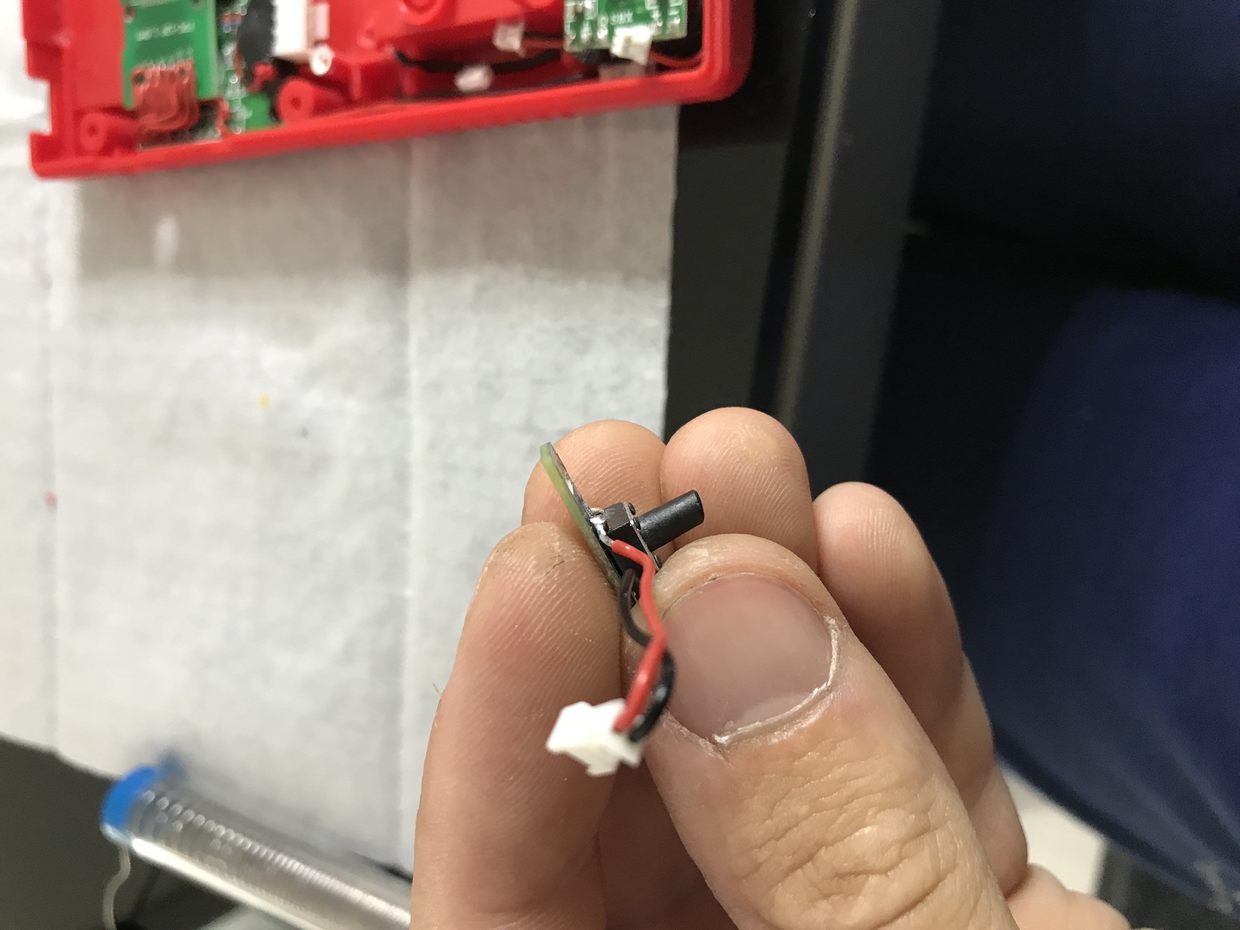

L/R buttons:
Plastic fiber optic to transmit the light of the powerboost led's to the top of the case:

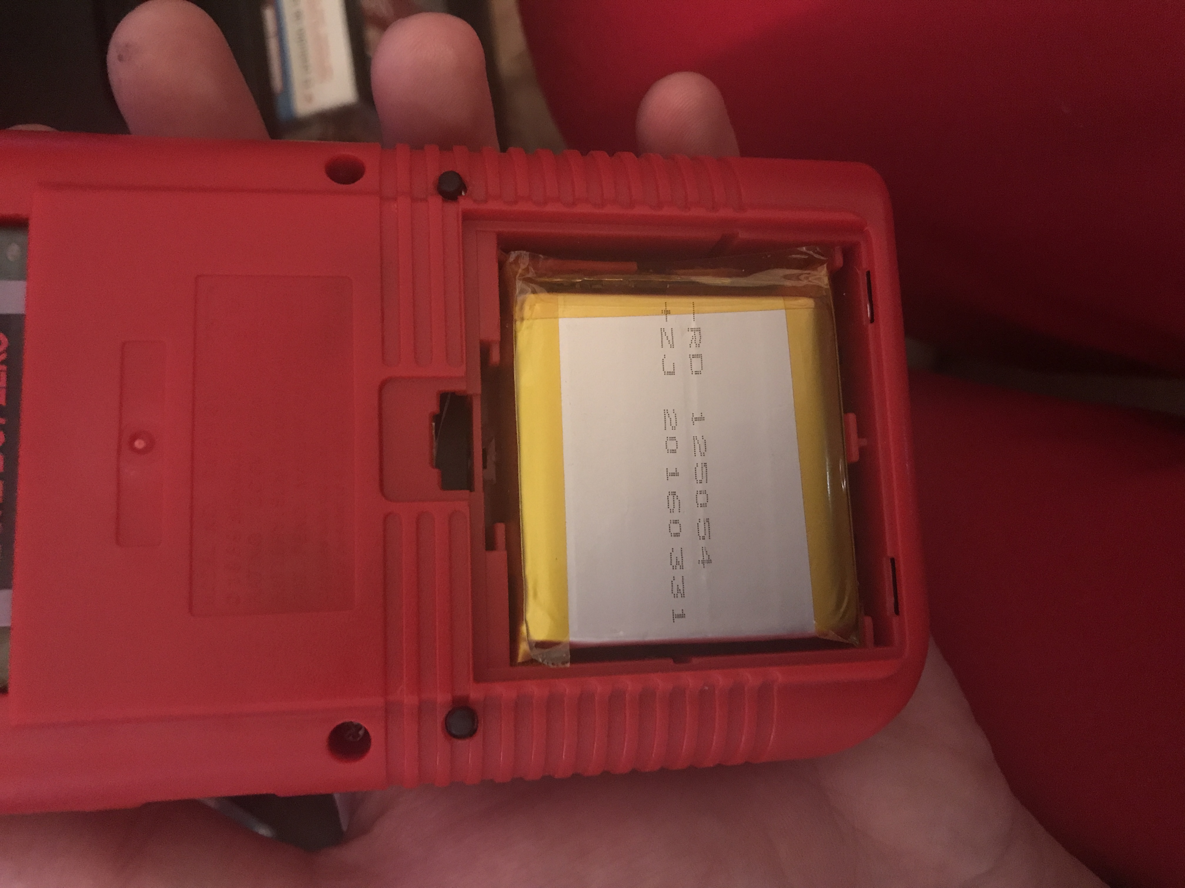

Assembling inside components, 4000mah battery:
Handmade separator case with the best sticker :D
Final assembly:

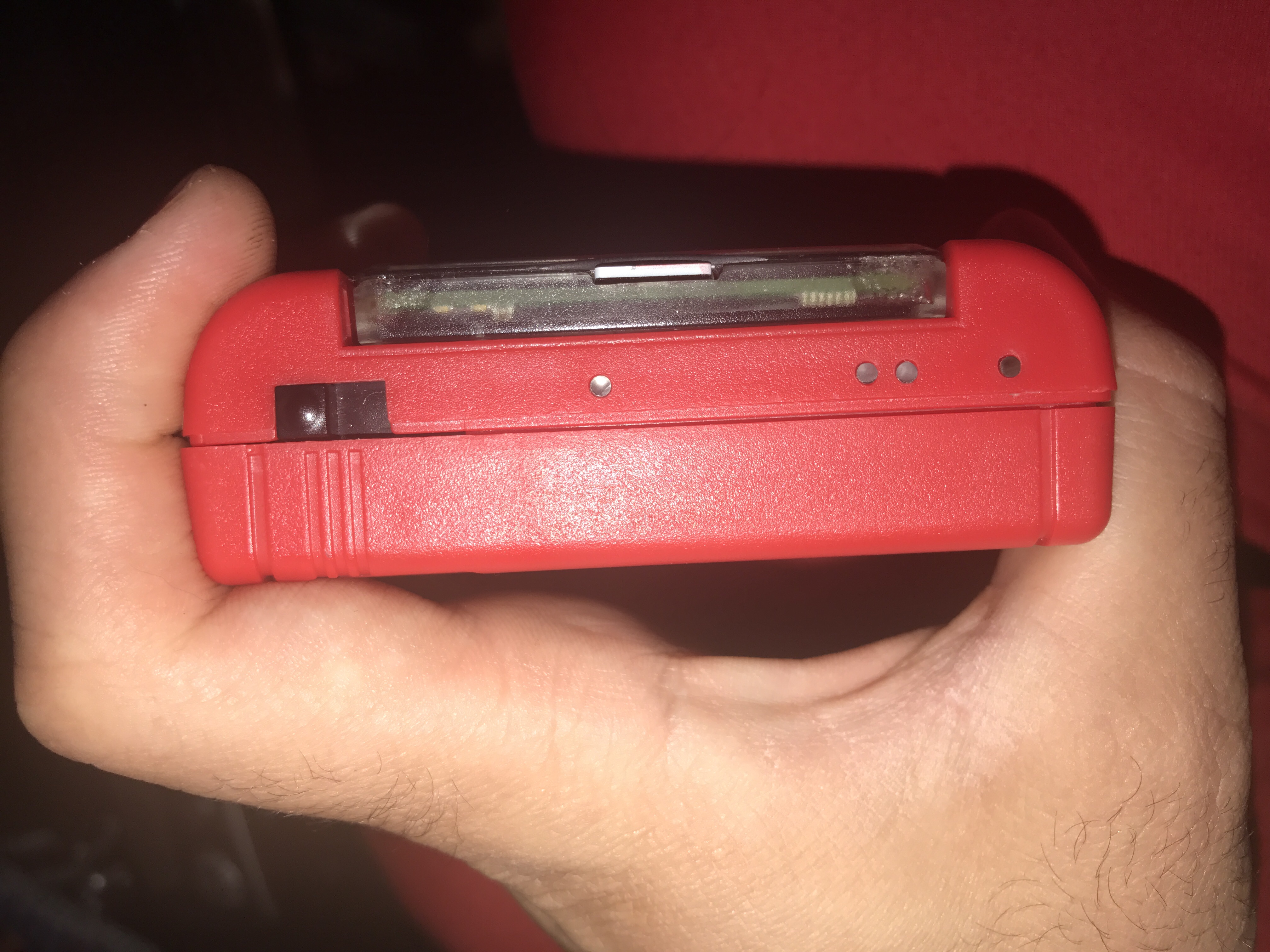

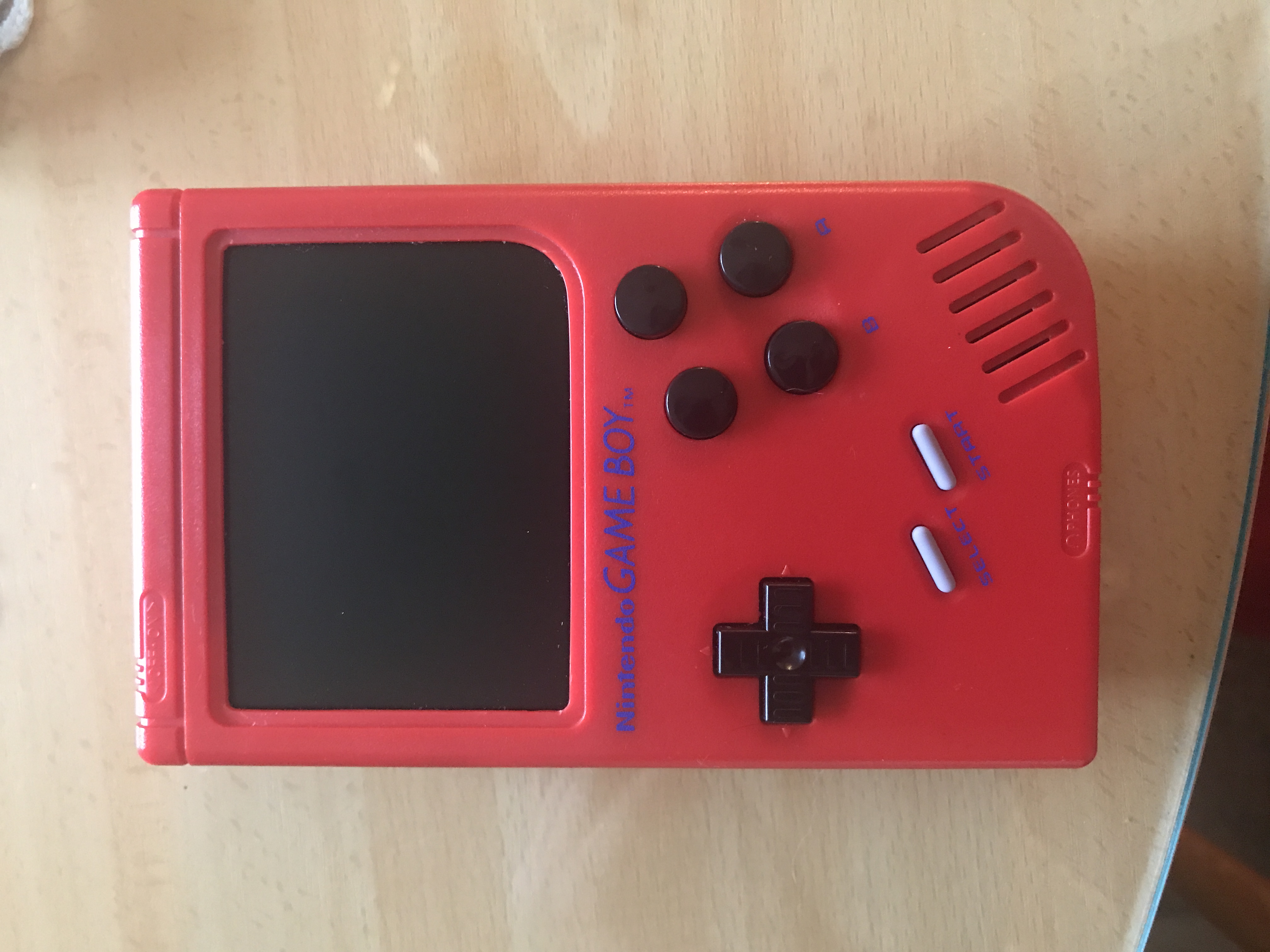

Final assembly ;)

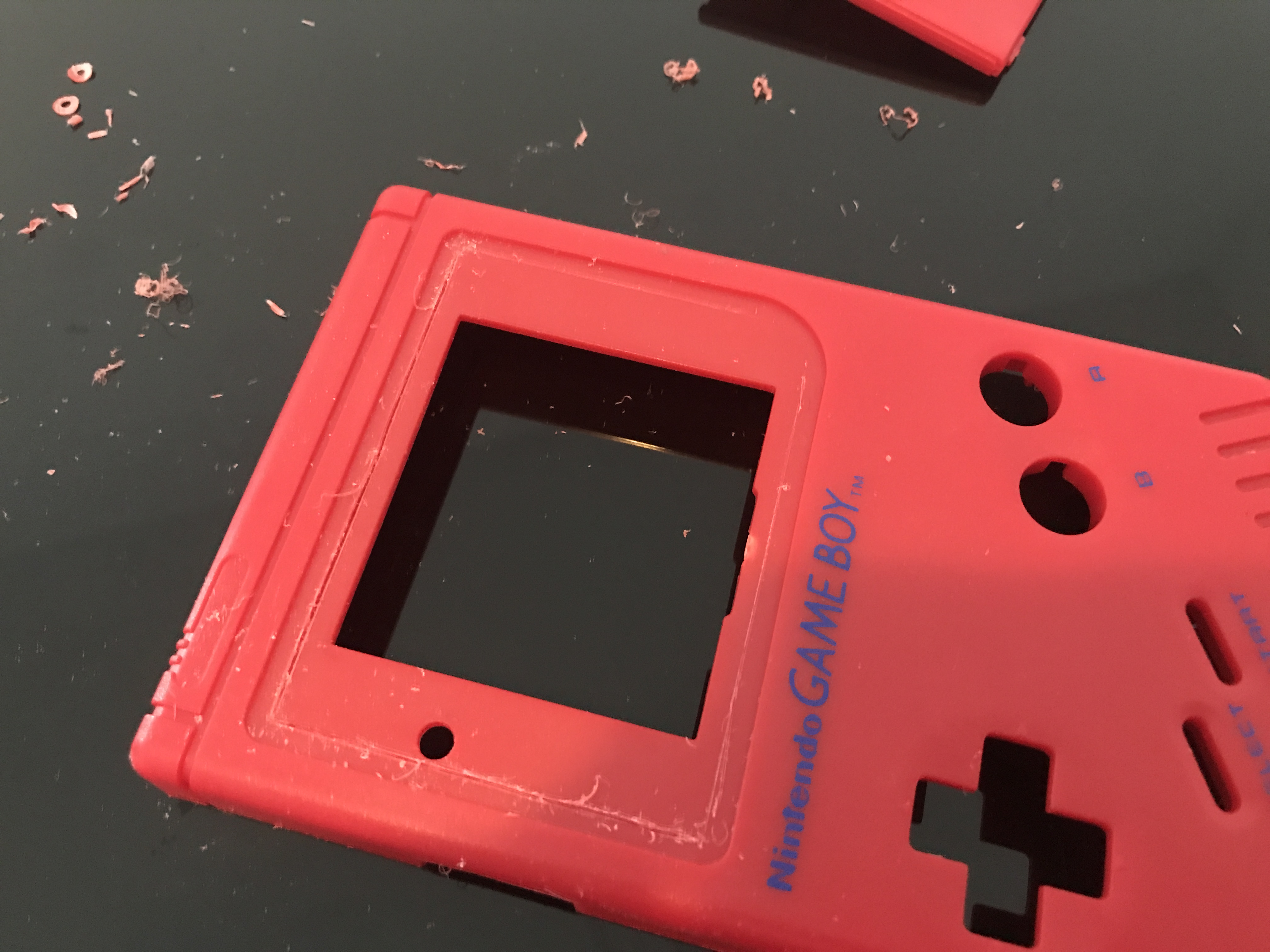

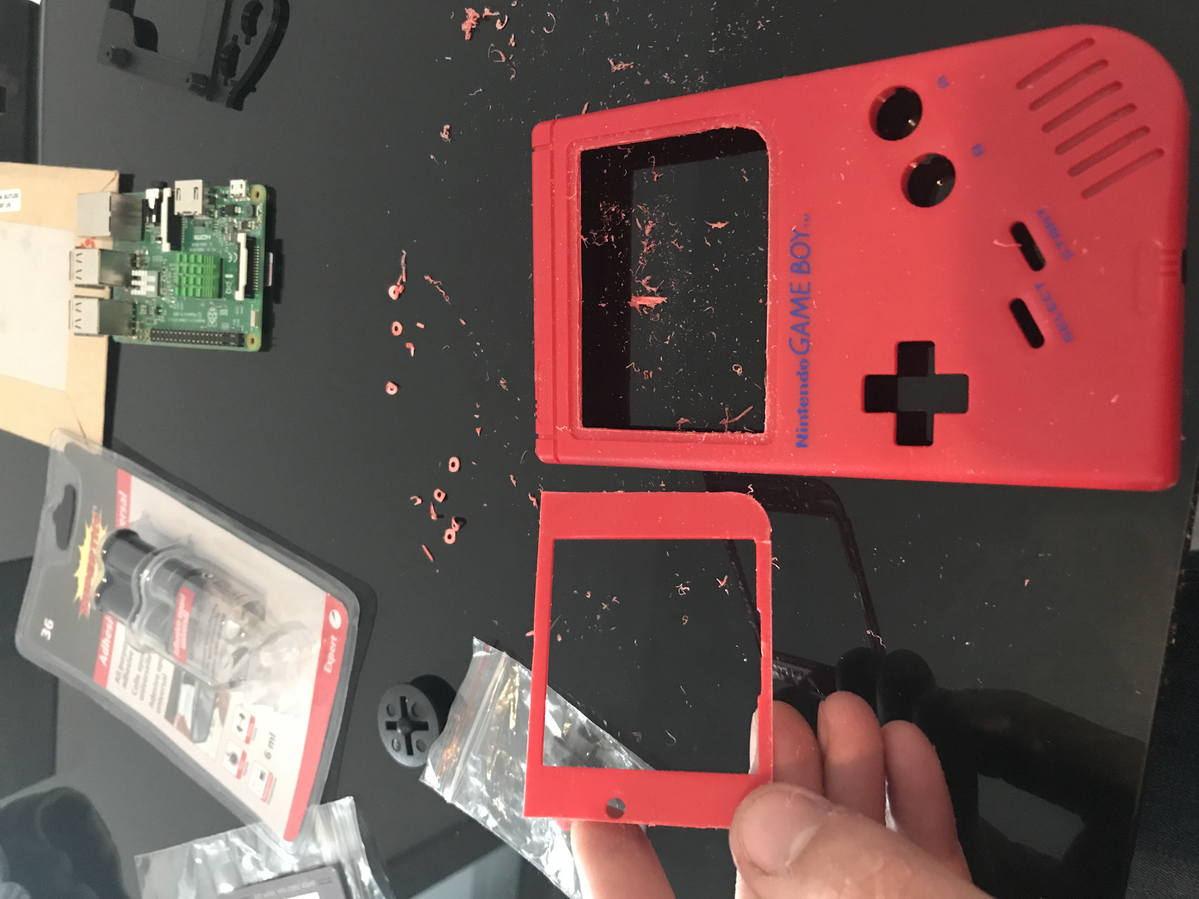

Nice build. If i may ask how dit you do the cutout of the screen,
Pitygsi
Posts: 32
Joined: Sun Feb 19, 2017 6:27 am
Has thanked: 10 times
Been thanked: 15 times
Re: Pity's #1 Gameboy Pi3
Post by Pitygsi » Sat May 13, 2017 10:31 am
cobramike wrote:
Sat May 13, 2017 9:41 am
With a Chinese cutter and patience :D , then pass it over with fine sandpaper.
Thanks for the comments :P
Jesús.

Do you have the link to the battery? @pity
Pitygsi
Posts: 32
Post by Pitygsi » Mon May 15, 2017 12:24 pm
hueblo wrote:
Mon May 15, 2017 9:18 am
Hello Hueblo,
Yes :) https://www.ebay.es/itm/182408478004
Jesus,
