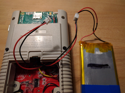

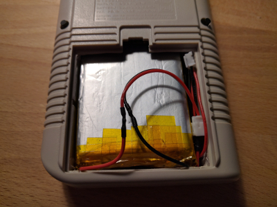

Here is a little tip that I did because I did not want to keep having to take a part my GBPi2 when I go to sleep or leave the house so I created a male to female extension cable from the powerboost to the battery bay that way I can unplug my battery without taking apart the GBPi2.
1. Created a Male to Female Connector Pin
2. Put in the battery
3. Make sure it fits and test
This way I can disconnect the battery whenever I need because I do not want my battery to catch on fire.
