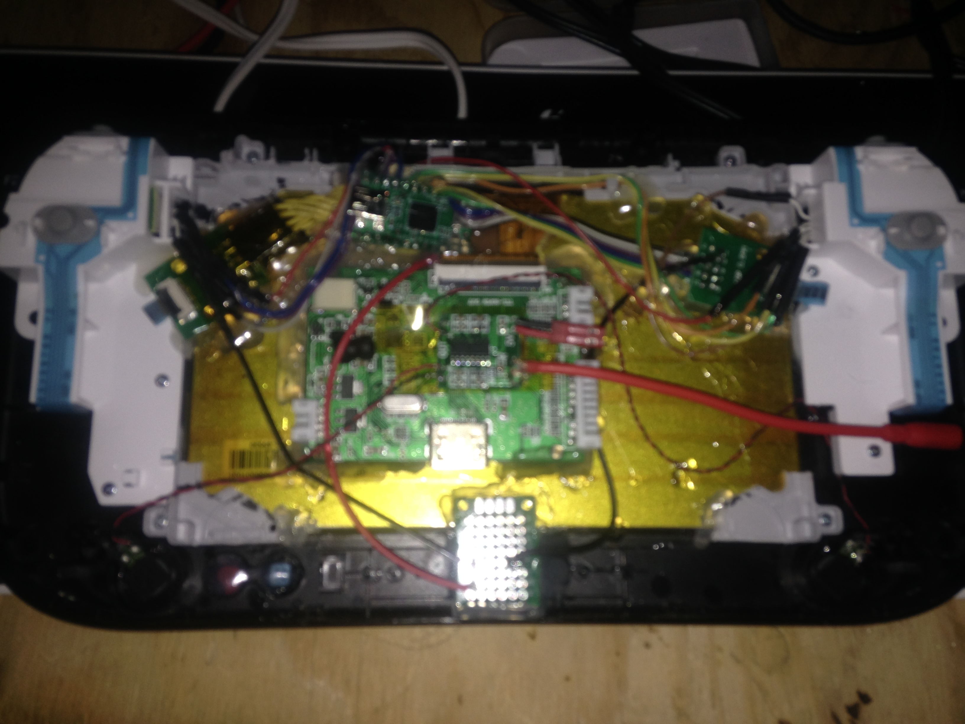

So I got the Teensy in, and started wiring it. I don't enjoy that, it's very tedious. I followed a guide here on sudomod Teensy 2.0 Programming
And used his built in "debug" mode to fix my wiring mistakes.
I wired a USB DAC and used a min stereo amp bought from amazon. I get a bit of static but otherwise get good crisp sound with just a bit of background static. The wii U speakers aren't that powerful, but enough to serve their purpose.
You'll notice I did not include a built in battery, I did this because I want to use my 12000 mah battery backup pack.
One thing I noticed is there is a yellow lightning bolt pretty consistently, but I check actual power draw from a USB power meter, it's saying max it's only pulling 1.3a with everything on (screen/pi3/amp) so I don't think i'm going to worry much about it. This has been a fun project, Can't say I'd do it again lol.

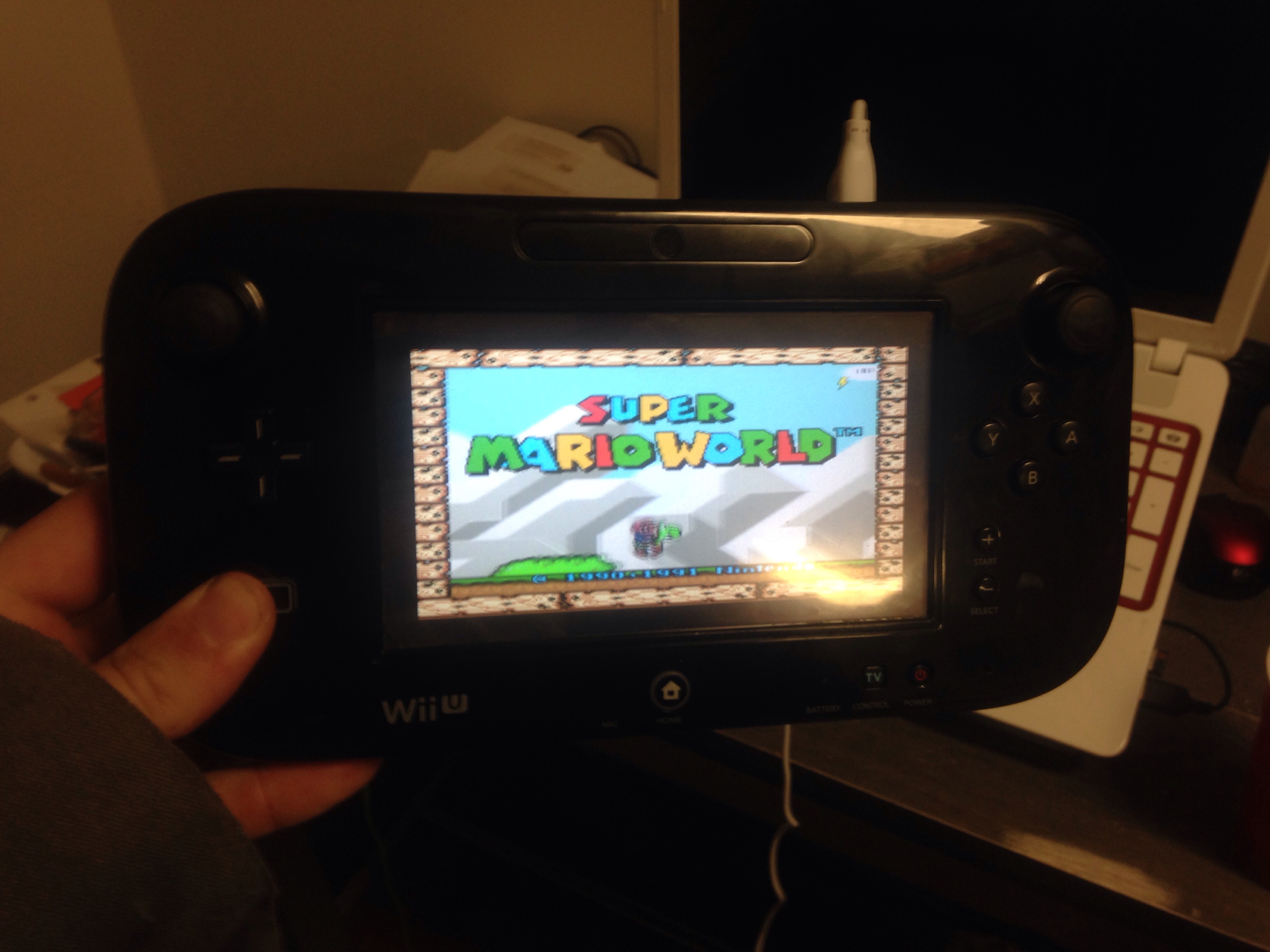

And, Last bit. A gif of a game i actually own. Ya know, copyright stuff.

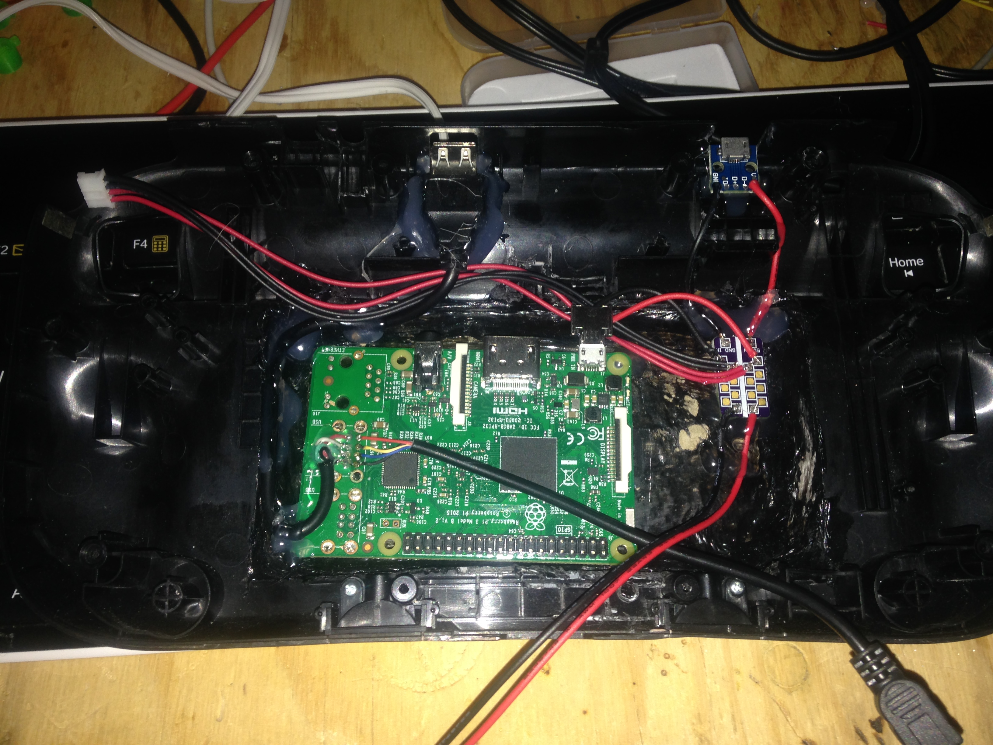

It looks awesome! To remove the lightning bolt, you need to add this to config.txt :
avoid_warnings=1
That will just remove the icon, however when the icon is shown the 'turbo' is disabled.. you can remove the icon AND KEEP turbo with this instead:
avoid_warnings=2
The cause is low voltage to the Pi, measure with a volt meter on the Pi power contacts (at the Pi end, not the power boost end) and make sure it's at or above 5v.. if it's 4.5 or lower then that's not great and means you're drawing too much 5v!
You might need to use thicker and shorter power cables, or a more powerful regulator, or a second regulator :)

Measured voltage at the pi, 5.12 volts. Used the avoid warning switch, no issues :)

Well, that's disappointing. Used for a couple hours and the rpi 3 apparently overheated and fried itself.
I may just go with a rpi zero and forget about trying for n64 or almost perfect snes emulation.

Did you have a heatsink in there?
I just got the wee skinny fan from Kite and I'm hoping that the fan and heatsink will be enough.
Were you running much of an over-clock?
