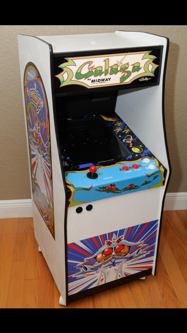

Post by HoolyHoo » Fri May 05, 2017 3:08 pm
Built this years back for my son. It's a scaled down version of a galaga cabinet. I used an ipac mini which is very nice. What Helder pointed out is cheaper in price and will work too
