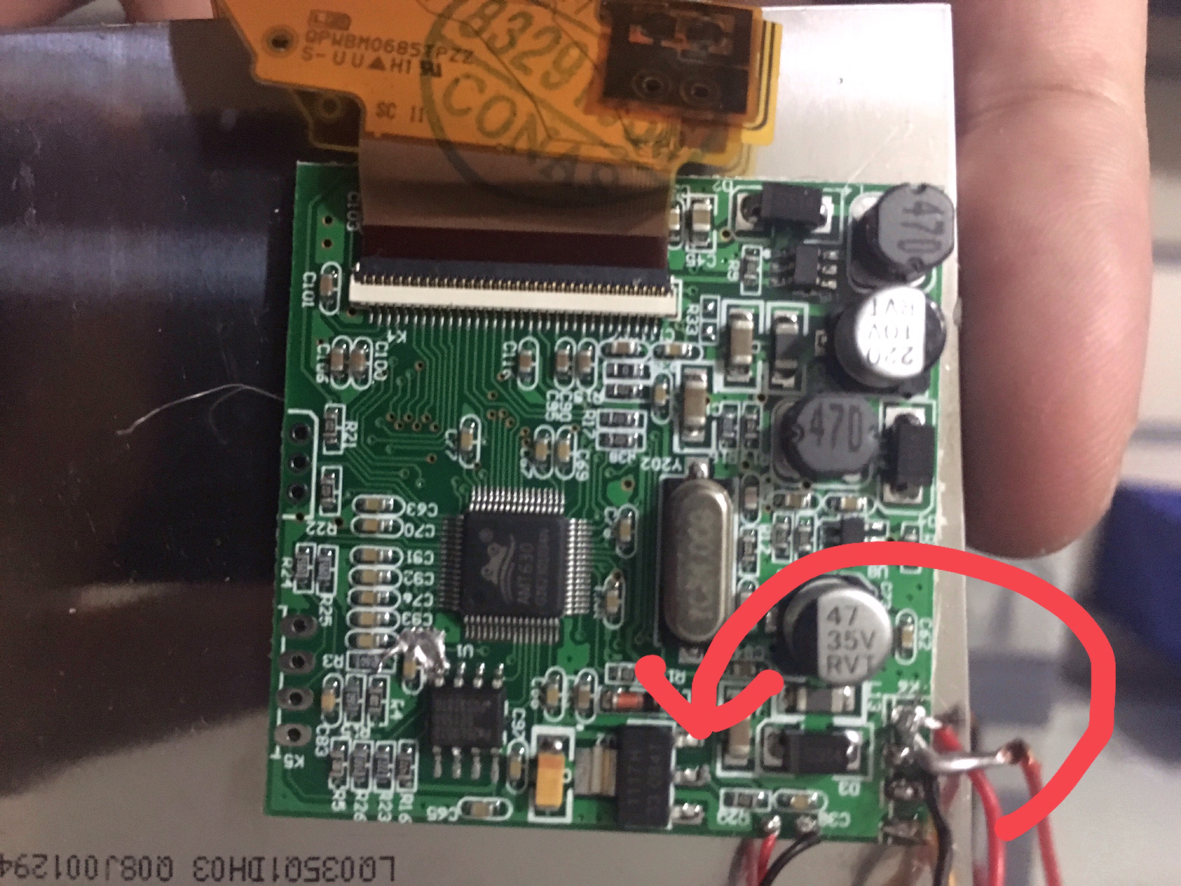

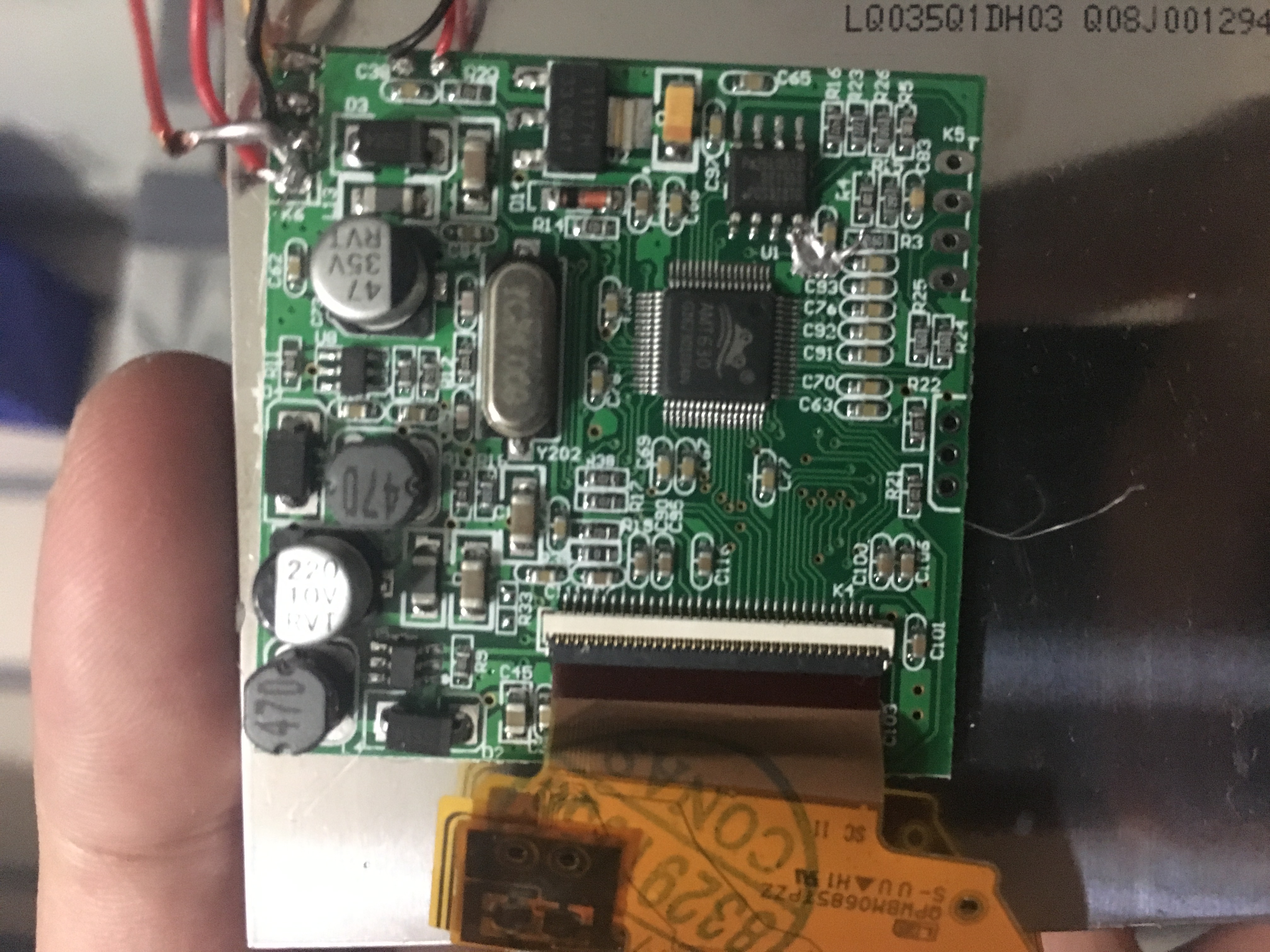

I have the same screen.
Please see picture on how to do the 5v mod.

Re: 12v to 5v mod
I believe you fried it , mate.
