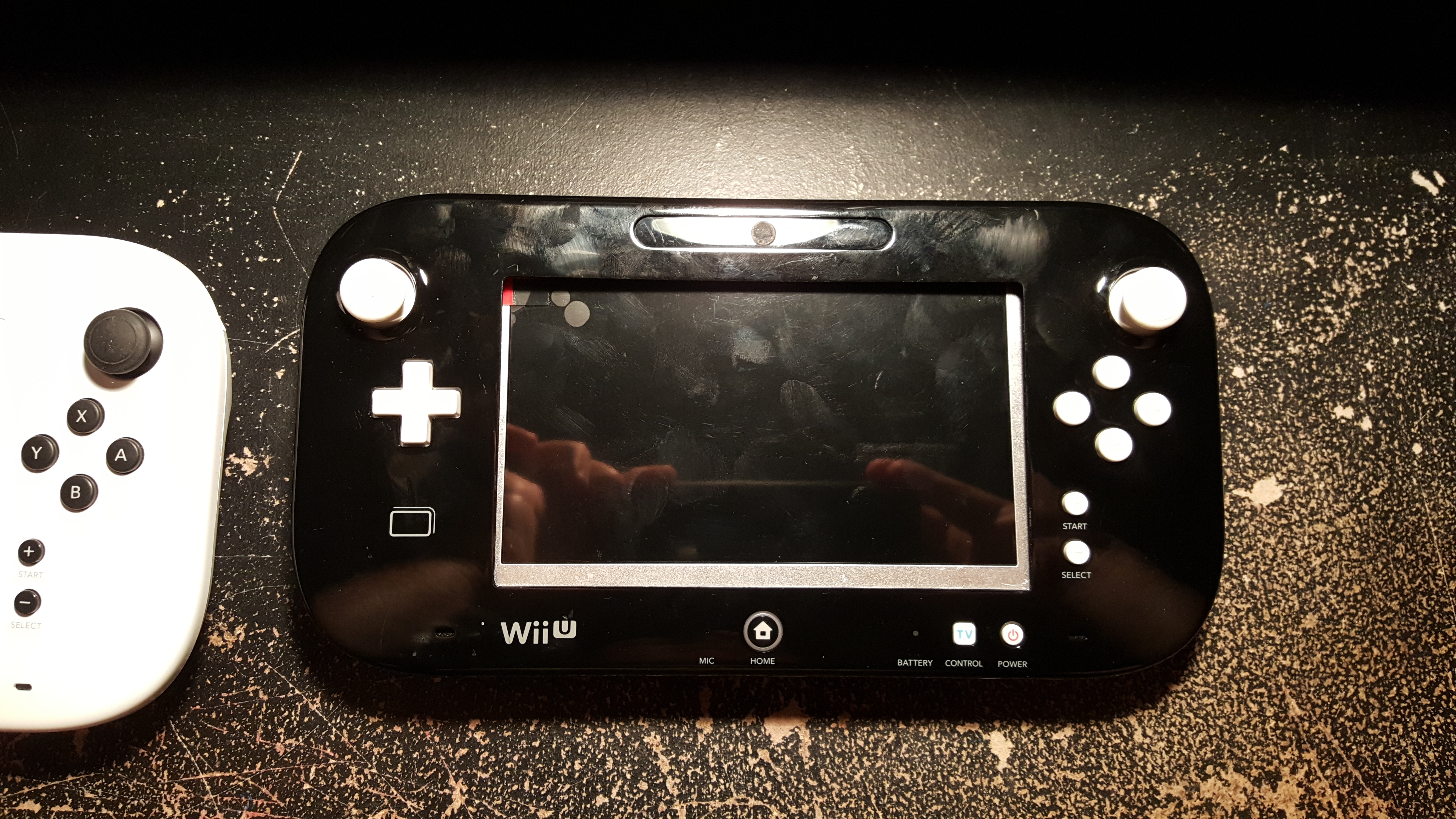

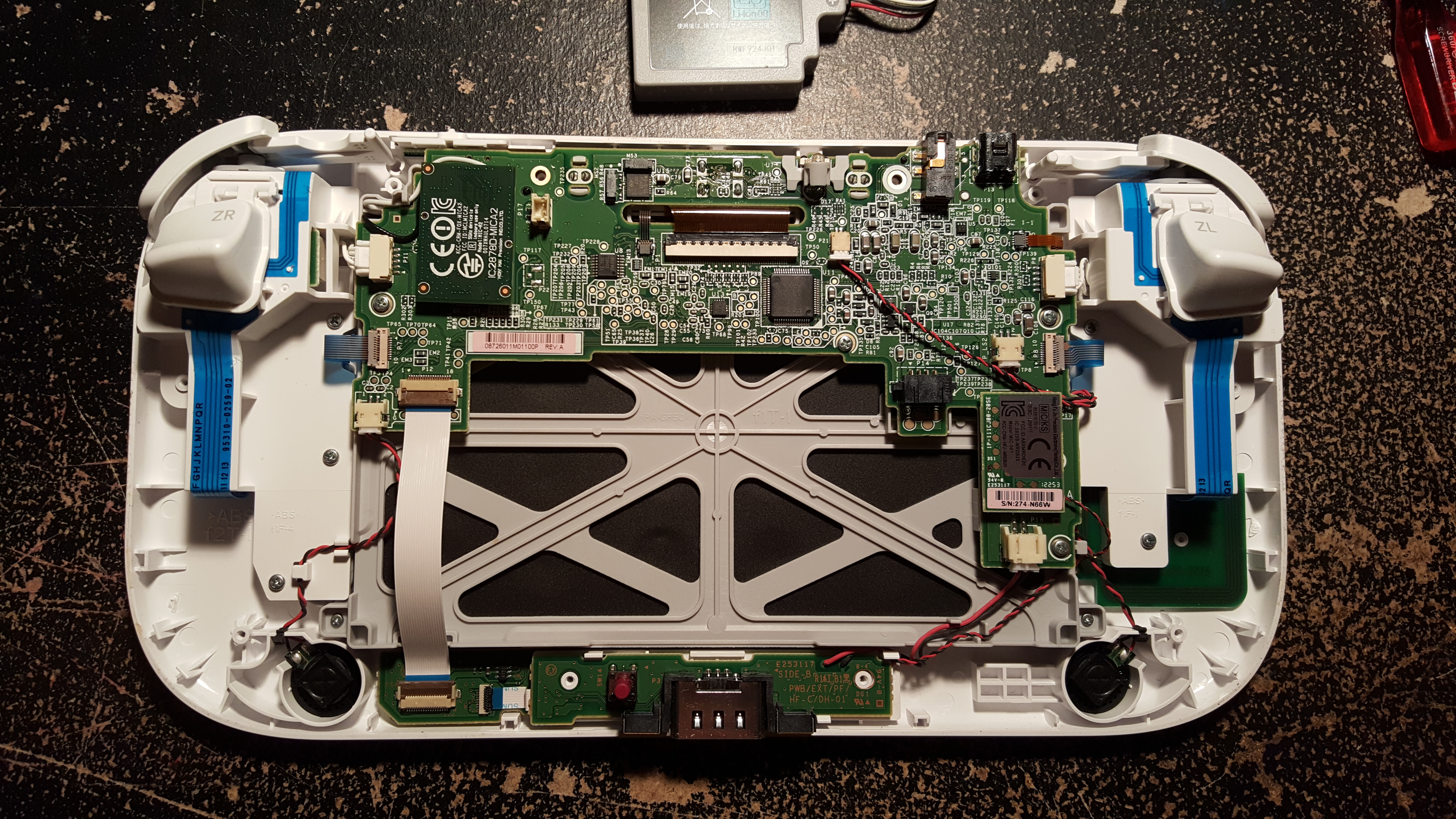

So I found a pretty cheap "for parts" white game pad on eBay and it just arrived today. I swapped out the buttons from it to my black one and I think it looks really sharp now. I also snapped a photo of the main board and it appears to have pads on it that may be able to be tapped into

Would you recommend buying a used gamepad? The only salvageable parts I could think of would be the charging port, audio potentiometer, and audio jack (along with the black plastic insert around them). I'm also just going to solder another FPC connector board for controls so thats taken care of.
Also do you think that big light grey display holder could be of any use or would it just take up space?

Racerboy wrote:Would you recommend buying a used gamepad? The only salvageable parts I could think of would be the charging port, audio potentiometer, and audio jack (along with the black plastic insert around them). I'm also just going to solder another FPC connector board for controls so thats taken care of.
I don't see much value in buying a used one, mine was a little more expensive than just the shell, generally they're around $50 unless you can find a deal. The only benefit is like you stated, sourcing some original hardware from the board. The volume potentiometer is just a standard slide switch, the plastic part that is interacted with outside the case probably can be bought separately.
The holder around the display seems to only have 2 purposes, hold the display in place and to be a mount for the main board. I don't see much use in migrating it to this build as it'll just take up space that we probably don't already have. Again, that display driver issue needs to be solved first. If not, some major case modifications need to be done to gain more space in there.
