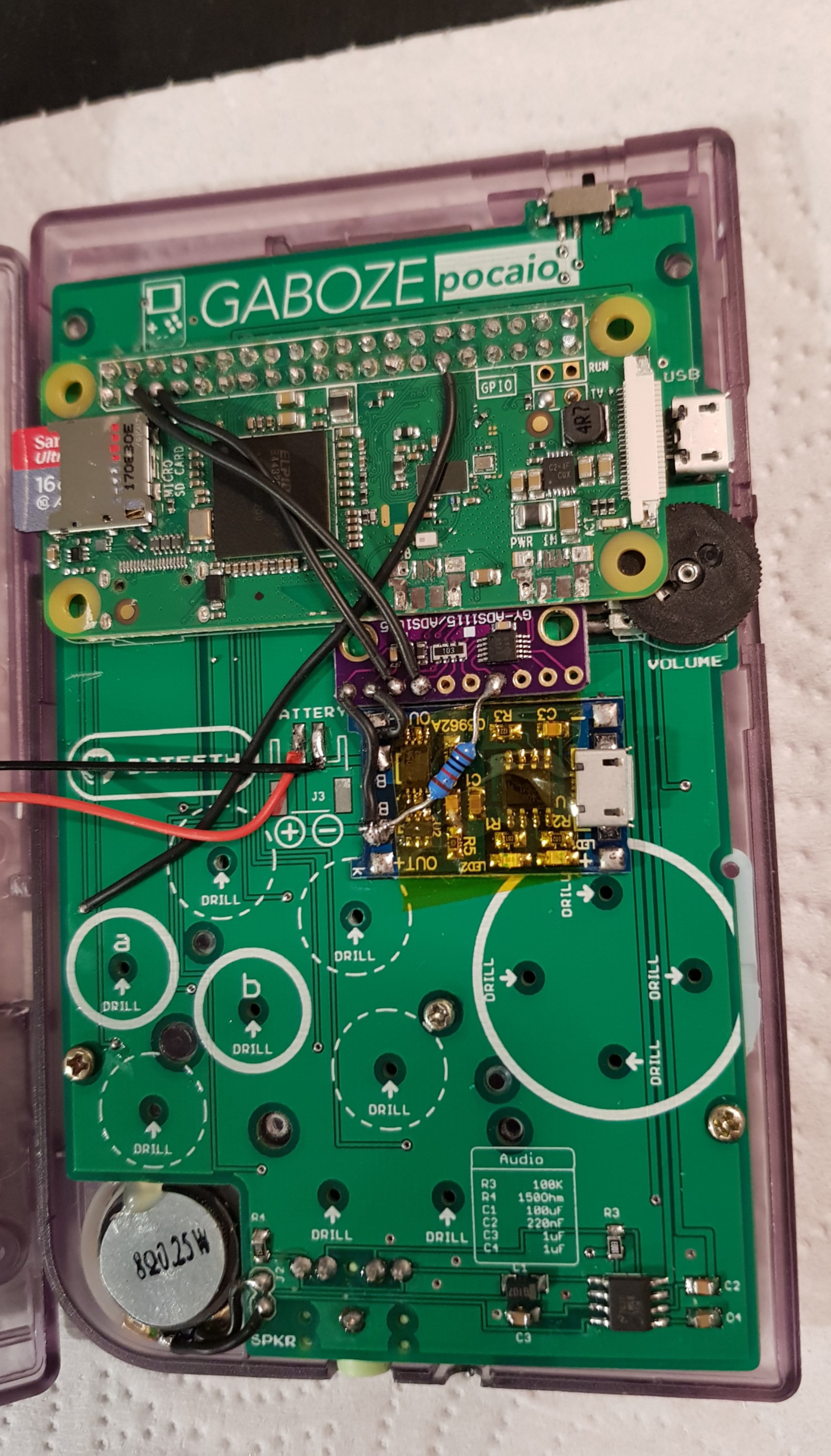

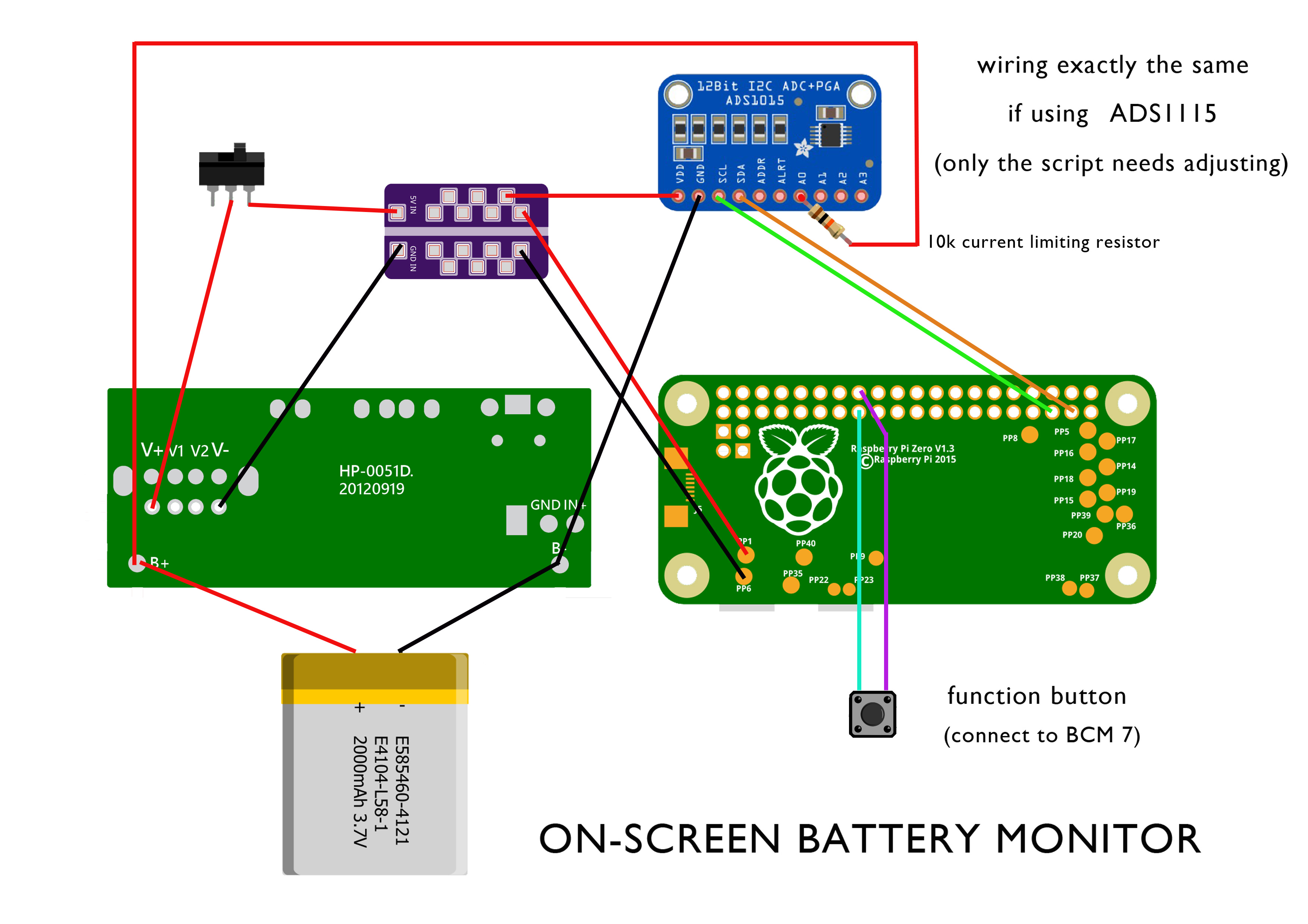

To add this into your Gaboze build, you can wire the ADS in much the same way as below:
batt mon gaboze.jpg (966.89 KiB) Viewed 18420 times

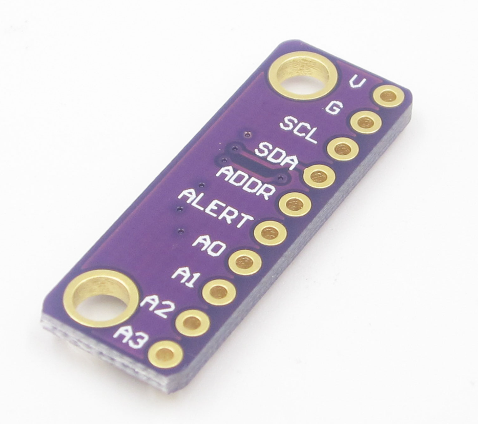

As for the ADS1015 this is the pinout:
To wire the ADS:
You'll definitely need the 10k resistor and this will go from A0 of the ADS1015 to the B+ on the TP4056
V and G will hook into the TP4056. (B+ and B -)
SDA and SCL will need to go to GPIO 2 and 3 as per:
https://pinout.xyz/pinout/io_pi_zero#
There are no alternative points on the Pi Zero for these so GPIO 2 and 3 are fixed.
**Subject to review - Bluup recently advised that changing SDA and SCL might be possible**
By default, the Gaboze image uses GPIO 2 (SDA) for the 'A' button and GPIO 3 (SCL) for 'L1'. To get around this you'll need to do the following:
1) Solder a wire from the breakout point on the PCB for the 'A' button and choose a free pin on the Pi Zero.
Pin 29 (GPIO5) is ideal for this but choose a free one as you see fit.
You will also need to physically cut the 'A' trace above the breakout point to ensure there is no unwanted power draw and interference with GPIO2 afterwards.
2) You will also need to cut the 'L1' trace above it's breakout point. I would recommend doing this even if you do not planning on using triggers. You do not want inference on that pin else the battery monitor script may not work.
Be sure to test the cut traces with a multimeter as I had an issue where pressing 'A' was sending the Pi into manual shutdown when pressed.
Thanks to Wermy we identified that the trace had not be completely severed and thus pressing 'A' caused power draw on Pin 2 causing the Pi to think it was at critical battery and as such, triggering the shutdown.
See below for an example of how it all comes together. Note the wiring as above and trace cut.
You should be able to fit everything in and close the shell without an issue.
batt mon gaboze comple.jpg (880.19 KiB) Viewed 18420 times
