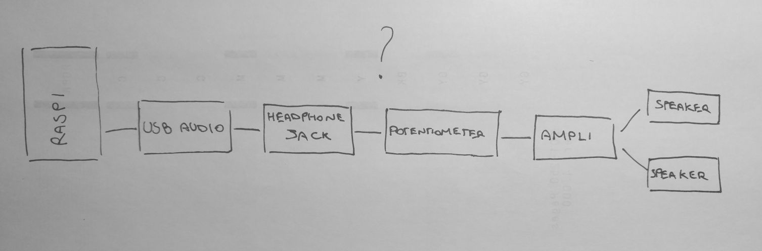

Hello thank you for that information. I just order a 6.5" LCD and controller board. Price wasn't that bad But not good either LOL coming from China will take 3 or 4 weeks to here in the US. Also i notice in your images you have the micro SD card in the bottom of the gamepad. I was thinking of doing the same but still keeping the 2 side pins for charging pins like in the Original Wii u gamepad.

Anyway i'm sorry but I don't understand well how audio circuit work... so i post an image on my doubt So the potentiometer is after or before the wii gamepad headphone jack? And the potentiometer is after of before the ampli?
Another question is: how do you made the usb connection with raspi? Are you soldered cable direct on 4 pin?

1. Lipopi works with any powerboost. Powerboost 1000 basic can output up to 4A, low battery indicator, boosting from 1.8V and enable function so no brainer here. I'm pretty sure there is no better solution so far.doggerx wrote:@banjokazooie: Thank you for the link to youtube. Very intresting......I saw lipopi script. This unfortunatly i think it's only for the Powerboost 1000c. I found this voltage booster to connect to the batteries that support 3A of output current:
Last but not least: How did you connect the board of home, power, tv buttons, and charge led?

2. The best position for pot is after usb card and before audio jack so you are not loosing volume regulation. Don't forget to use shielded cables.
3. All connection are soldered directly to board.
4. All buttons are connected to Teensy except power button
5. Led are connected to powerboost and charging circuit.
