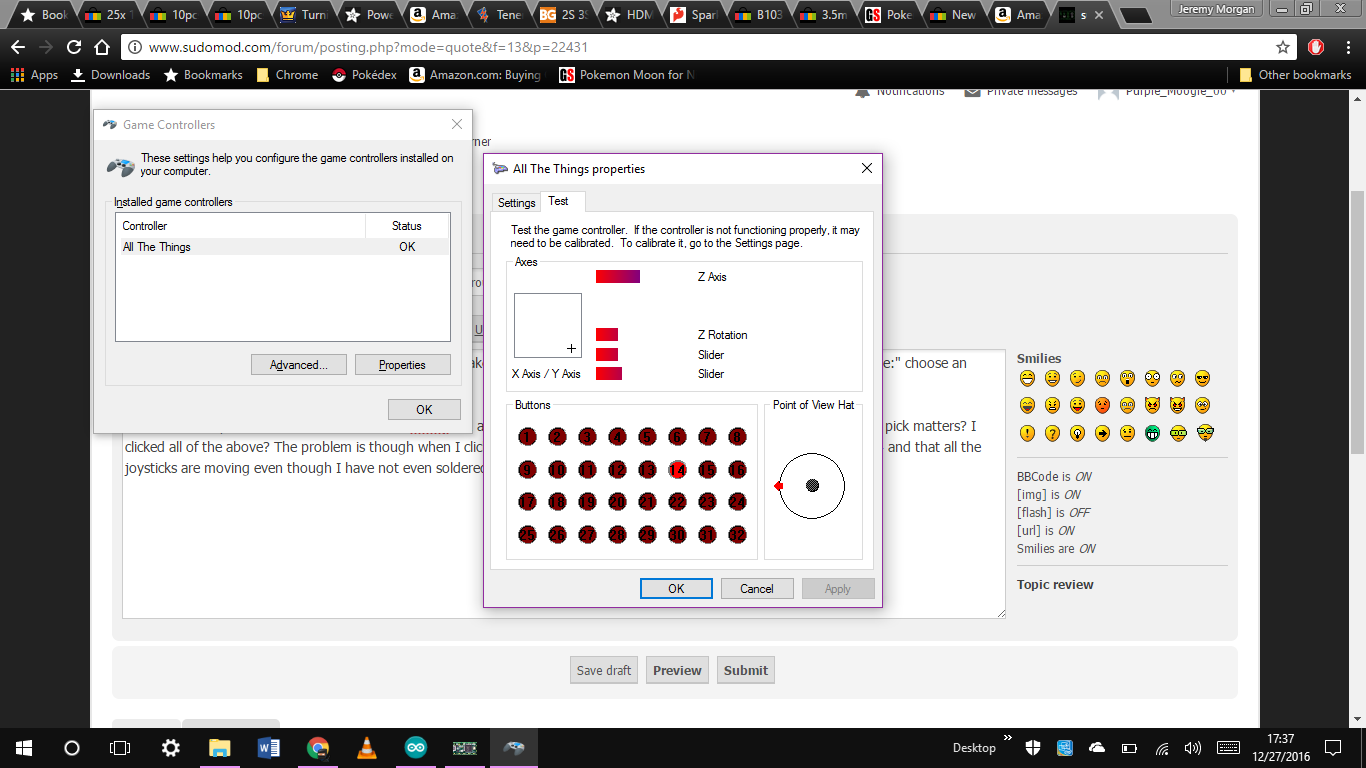

I have done as you said, make sure it is set to teensy 3.2 and make sure I use a usb joystick type. Do you think which one I pick matters? I clicked 'all of the above'? The problem is though when I click on joy.cpl I get random values. It thinks I'm pressing button 14 and that all the joysticks are moving even though I have not even soldered anything to it.
Screenshot (1).png (121 KiB) Viewed 6580 times
EDIT: I have changed the USB type to flight sim + joystick and it has not changed anything. The above problems still occur

Post by Camble » Tue Dec 27, 2016 4:03 pm
Sounds about right. The unconnected axes will be moving because the pins are floating.

Post by Purple_Moogle_00 » Tue Dec 27, 2016 4:47 pm
Camble wrote:Sounds about right. The unconnected axes will be moving because the pins are floating.
Thank you for this. I thought something was seriously wrong
