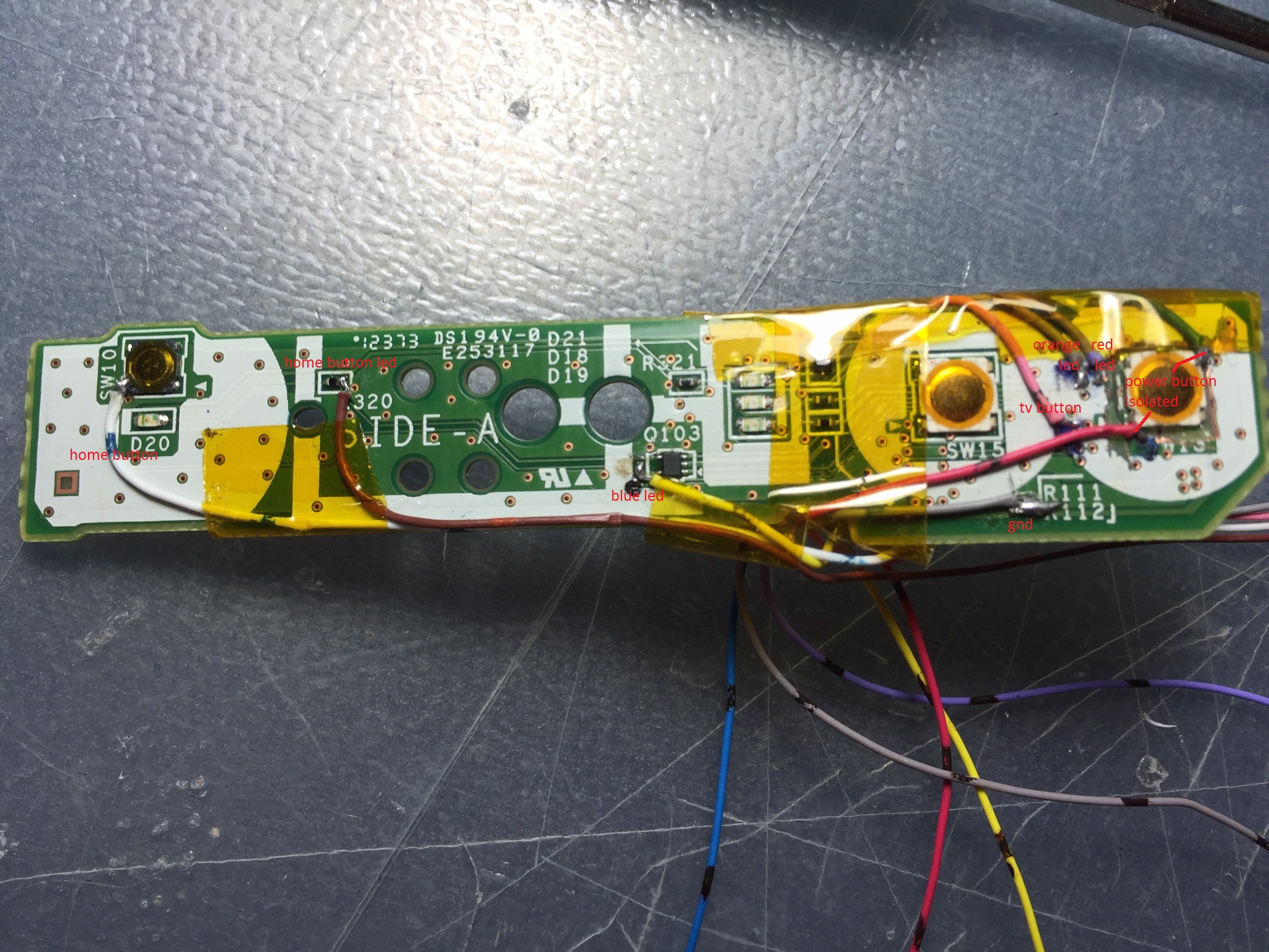

hi
I leave this to you if it works for you
it's my job:
* all leds common ground
* Tv button - Home button common ground
* power Isolated button "With patience and cutter"
- 01671524ab94403fcf6ec9c401f61110cbf58f46e3.jpg (1.02 MiB) Viewed 10886 times

Nice work. I was trying to avoid wiring to the panel. I wanted to control as much as I could via the 18pin FRC. I couldn't find any connections for the Home LED off the cable. I could only find the red power LED.cristiamp wrote: I leave this to you if it works for you
it's my job:
To avoid cutting the board, people could wire most of the button connections up to the FRC and then just wire the Home LED, or what ever LED they wanted using your post.
Thanks for the post, I am sure people will find it helpful.

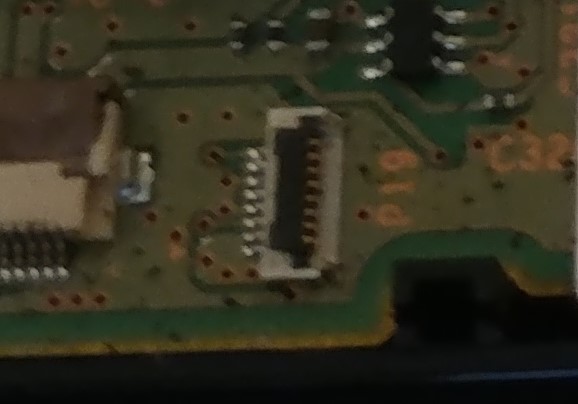

hi
led home, is for 8 flat, direcction to charge bay

Nice catch. I didn't even look at that cable. I'll have to add it to the pin post out above.cristiamp wrote:hi
Thanks.

Oh I wouldn't have thought to check the 8pin fpc slot for the charging board.ZarkWizard wrote:Nice catch. I didn't even look at that cable. I'll have to add it to the pin post out above.cristiamp wrote:hi
Thanks.
That will work with the FPC to DIP connectors right? Make it more convenient in a way
