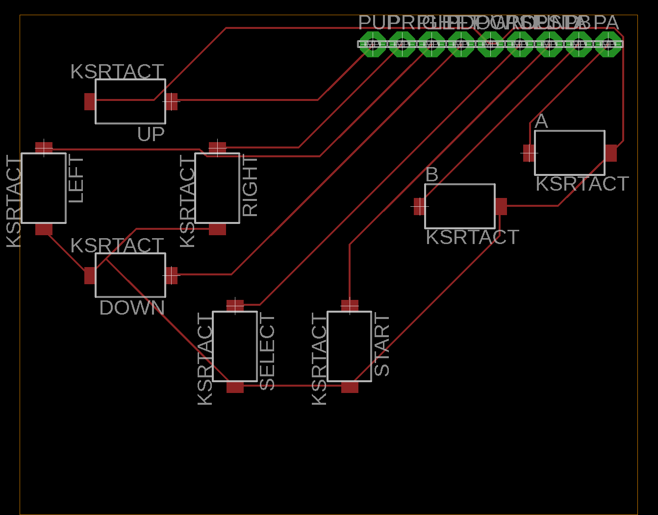

I'm the technician for Fablab Liverpool. Using this project to finally teach myself Linux and PCB design as we usually specialize in digital fabrication with the 3D printers and laser cutters.
It's a bit rough, but that should be the controller PCB, just need to check if the switches are correct as they're the first custom component I've made. If it's all good then I'll have to work out how to route it out on our CNC mill.

Are those omron smd microswitches?

We get all the Autodesk software free through work so started using Eagle rather than KiCad. Eagle also allows me to easily import the PCBs with components in place into Fusion 360 with makes it dead easy to design the case to fit around the controller PCB.
And Abrugsh, designing the PCB around C&K KSR series SMT Sumbiniature tact switches https://www.mouser.com/ds/2/60/ksr-1141284.pdf

Post by abrugsch » Thu Feb 15, 2018 8:06 am
ahh cool. careful with those activation forces. I did some side by side comparisons with lower AF tacts and the "standard" (as in what the generic bags of 6mm tacts come as) 160gf usually feels too strong. I had some 100gf and 60gf and 100 felt just right while 60 wasn't tactile enough...
