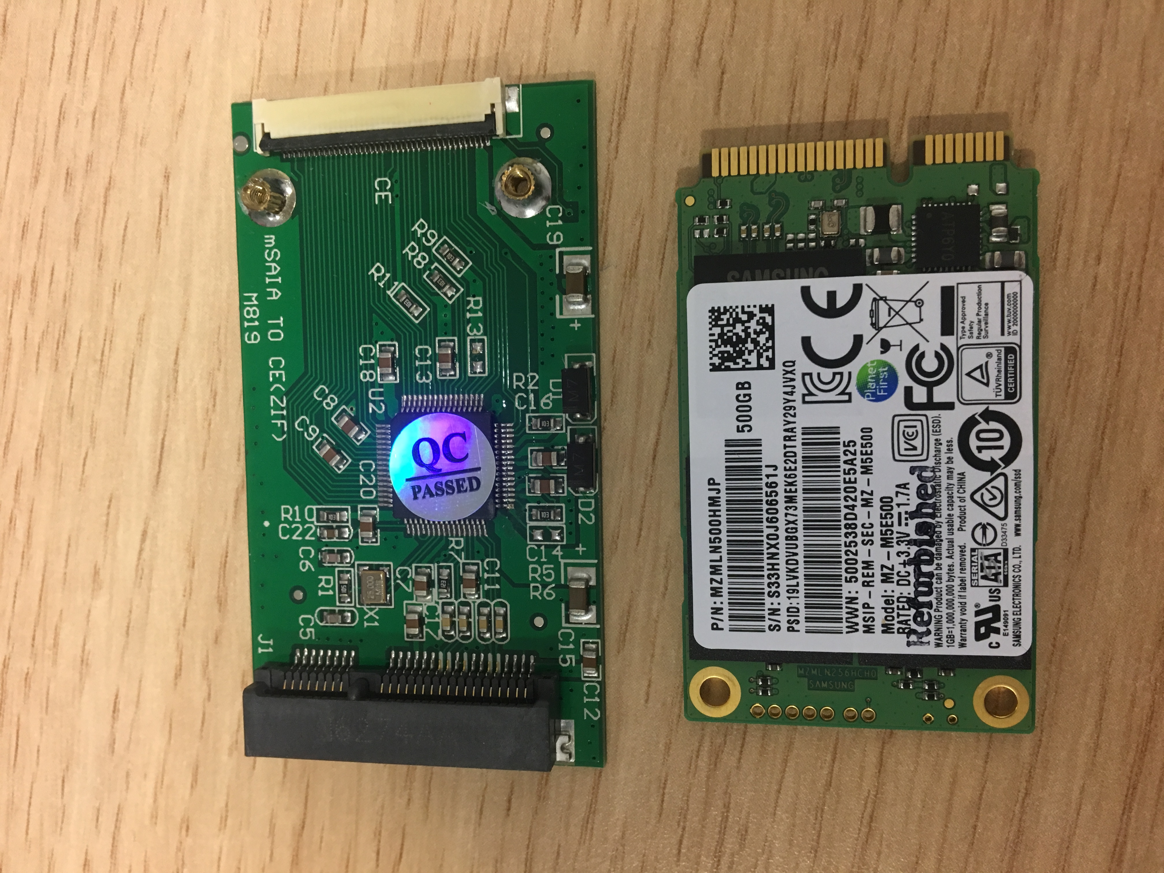

Hello, I wonder if you still monitor the thread..
My Ipod is 5.5 64mb (80gb- model)
I bought a similar SSD from amazon, where it was sold as MZ-M5E500BW. What I received did not have the last two letters BW though. I can see in your post, yours lacks them as well. Hope it's not a problem? and all PN SN PSID are all different. But model is the same. It's attached. Still no luck getting to work. I have iPOD's sad face on the screen, then - PLEASE WAIT VERY LOW BATTERY. and it kept restarting.
Did you format the SSD before installing it? Get any issues/errors like these? Did you try installing Rockbox?
How is the battery life compared to HDD version?
Hope you will hear me.
Thanks,
Serge
Chedda
Posts: 151
Joined: Fri Sep 16, 2016 3:11 pm
Location: USA (for now)
Has thanked: 29 times
Been thanked: 52 times
Re: iPod 480GB SSD
Post by Chedda » Tue Apr 23, 2019 8:37 am
I never saw the reply. My apologies.
I did not format the drive before hand. I only plugged the ipod into a computer and had itunes go through the format. The battery life is far better (2 solid weeks of playing music).
Builder and tinkerer
