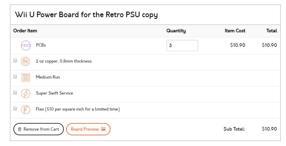

How should I buy?
Do I have to choose a version or does the base work well?
Post by Helder » Thu May 09, 2019 4:59 pm
The regular board should work fine, not sure the 0.8mm thickness is required here but I doubt it.
