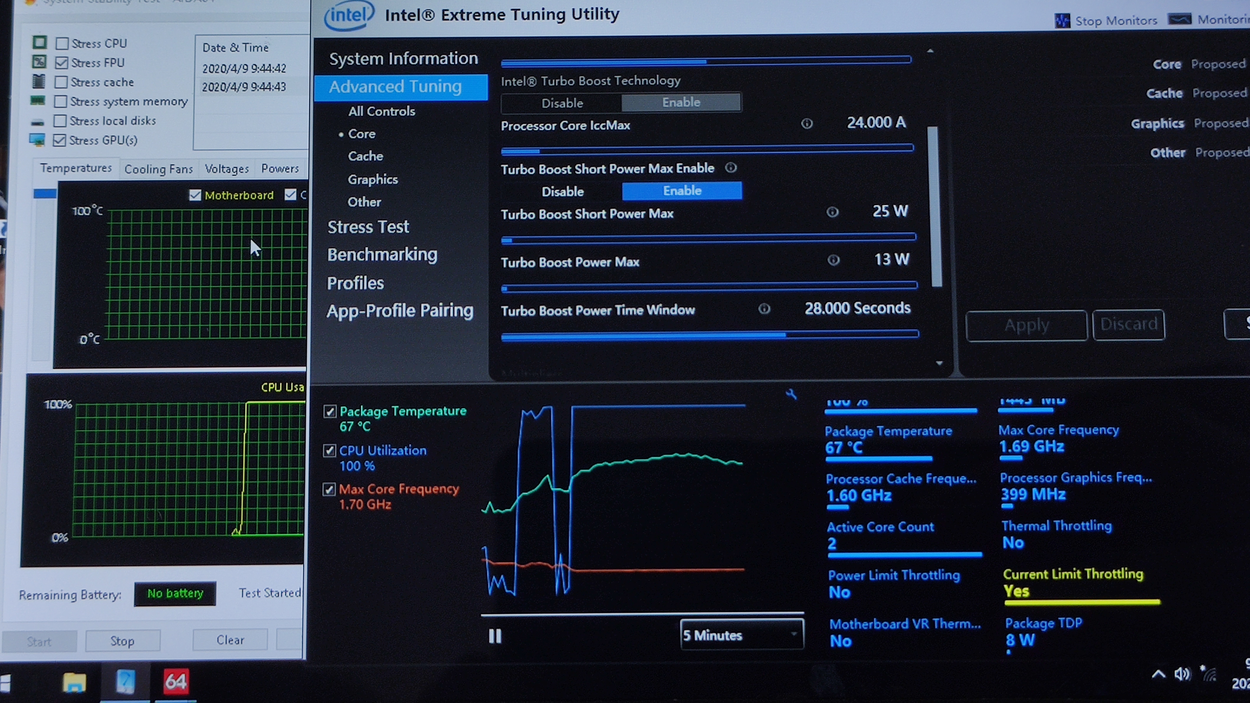

About the tdp i can confirm xtu works with the stick, and if you can keep the temps below 85º 7w and 8.5w make a great difference in performance. There is some apps for the gpd win2 for this and works with the stick.

After xtu configuration, the stress test can only be 8W for a long time, which will trigger the current limit. The peak value of 9W triggers the power consumption limit. In actual game applications, it can only maintain 6.4 ~ 6.8W instantaneous peak value 7W.
bios can't find any related setting options

Here is the batchfile for setting the undervolt+TDP for CPU&GPU, I used this for my GPD win2, I don't know if it needs any tweaking for the 6y30:
https://pastebin.com/yG5VKqcc
This needs XTU-Setup-6.4.1.25.exe version of XTU.
I would recommend to try undervolting, if you are lucky you can go down to -60mV, I actually could run some things at -80mV.
Just be careful, I would never do this without a proper heatsink solution (I would consider the default Stick case+minifan a nogo for heavy tweaks.) I mean set the TDP higher than 7W.
