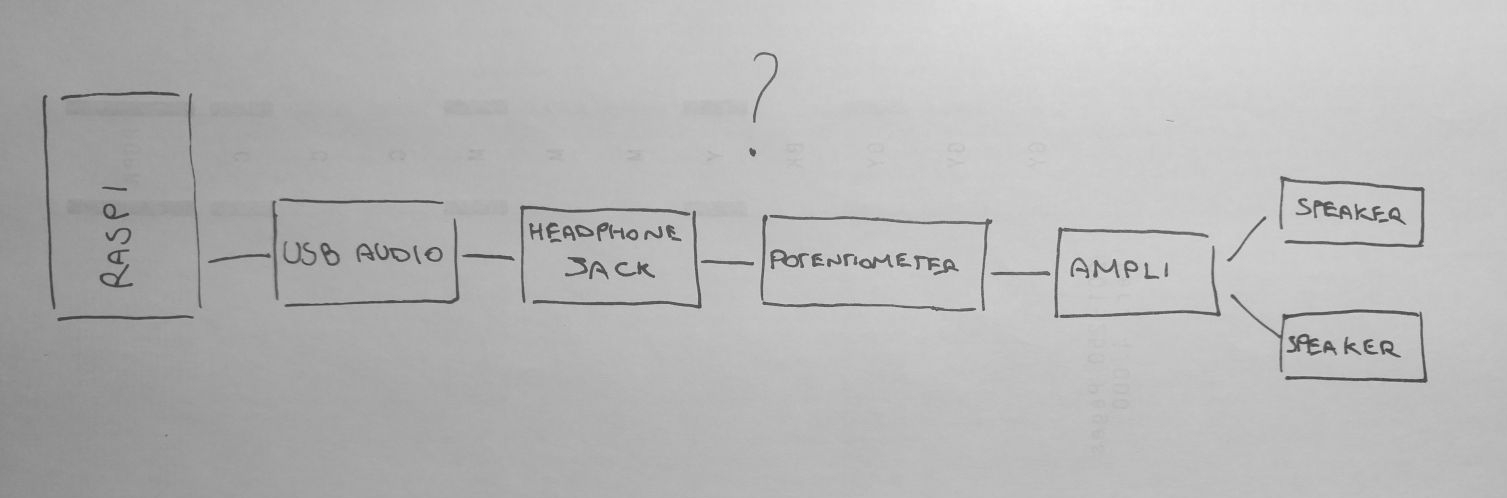

Anyway i'm sorry but I don't understand well how audio circuit work... so i post an image on my doubt
So the potentiometer is after or before the wii gamepad headphone jack? And the potentiometer is after of before the ampli?

1. Lipopi works with any powerboost. Powerboost 1000 basic can output up to 4A, low battery indicator, boosting from 1.8V and enable function so no brainer here. I'm pretty sure there is no better solution so far.
2. The best position for pot is after usb card and before audio jack so you are not loosing volume regulation. Don't forget to use shielded cables.
3. All connection are soldered directly to board.
