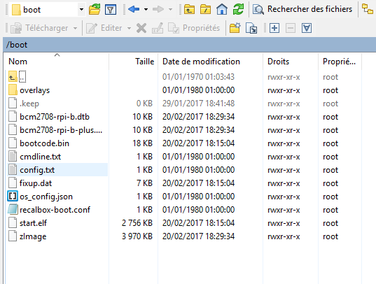

Hello,
I want to change some settings of my display to fit perfectly with my screen but when i use winSCP, i have an error "Permission READ ONLY" when i try to save the config.txt file.
When i see the file, i'm in root and i can read-edit-save the file
What are you using to edit this file ?
thanks

You can't edit it from winSCP because you logged in with the user 'pi' , which doesn't have permissions to edit that file! When you SSH (using PuTTY) you have to 'sudo <edit>' the file.. as far as i'm aware you can't sudo in winscp ;) take the SD out and put it in your PC, you can edit it on the fat32 partition!

Recalbox is read-only by default. (stops the sd card corruption due to improper shutdowns)
See this mini-how-to: https://github.com/recalbox/recalbox-os ... e-%28EN%29
Basically, connect via ssh (click the link and READ!, then just mount /boot as read&write, then edit the config.txt normally. Easy peasy.
