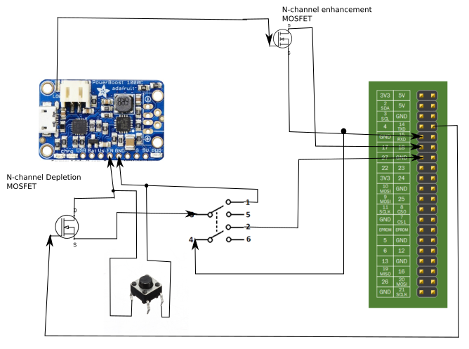

Well, I've been to my hackerspace in my area and asked if it was possible to do it with mosfet and the answer was yes, because the mosfets are voltage based and not current based like the transistors, so you can just hook the gates to the pi0 output and the battery low. This is so much simpler then the pololu, the only thing is to find a n-channel depletion mosfet because there not that commonly used.
Without pololu.png (135.52 KiB) Viewed 9308 times

Felix wrote:Well, I've been to my hackerspace in my area and asked if it was possible to do it with mosfet and the answer was yes, because the mosfets are voltage based and not current based like the transistors, so you can just hook the gates to the pi0 output and the battery low. This is so much simpler then the pololu, the only thing is to find a n-channel depletion mosfet because there not that commonly used.
Nice one, but also typical! I now have a useless Pololu :lol:

Does anyone know if n-channel MOSFETs are used in computer power supplies and such? I've got plenty stuff lying around I could cannibalise if that was the case.

You are just building your own Polulu switch :lol:

What you need to look for is mosfets with a low max gate voltage so that it is easily to be overcome by the pi or the battery low one
SidSilver wrote:You are just building your own Polulu switch :lol:
Not quite, if you think for a moment the powerboost is also a sort of a pololu but the on/off is different. I'm trying to do it only with the powerboost and not with the pololu.
