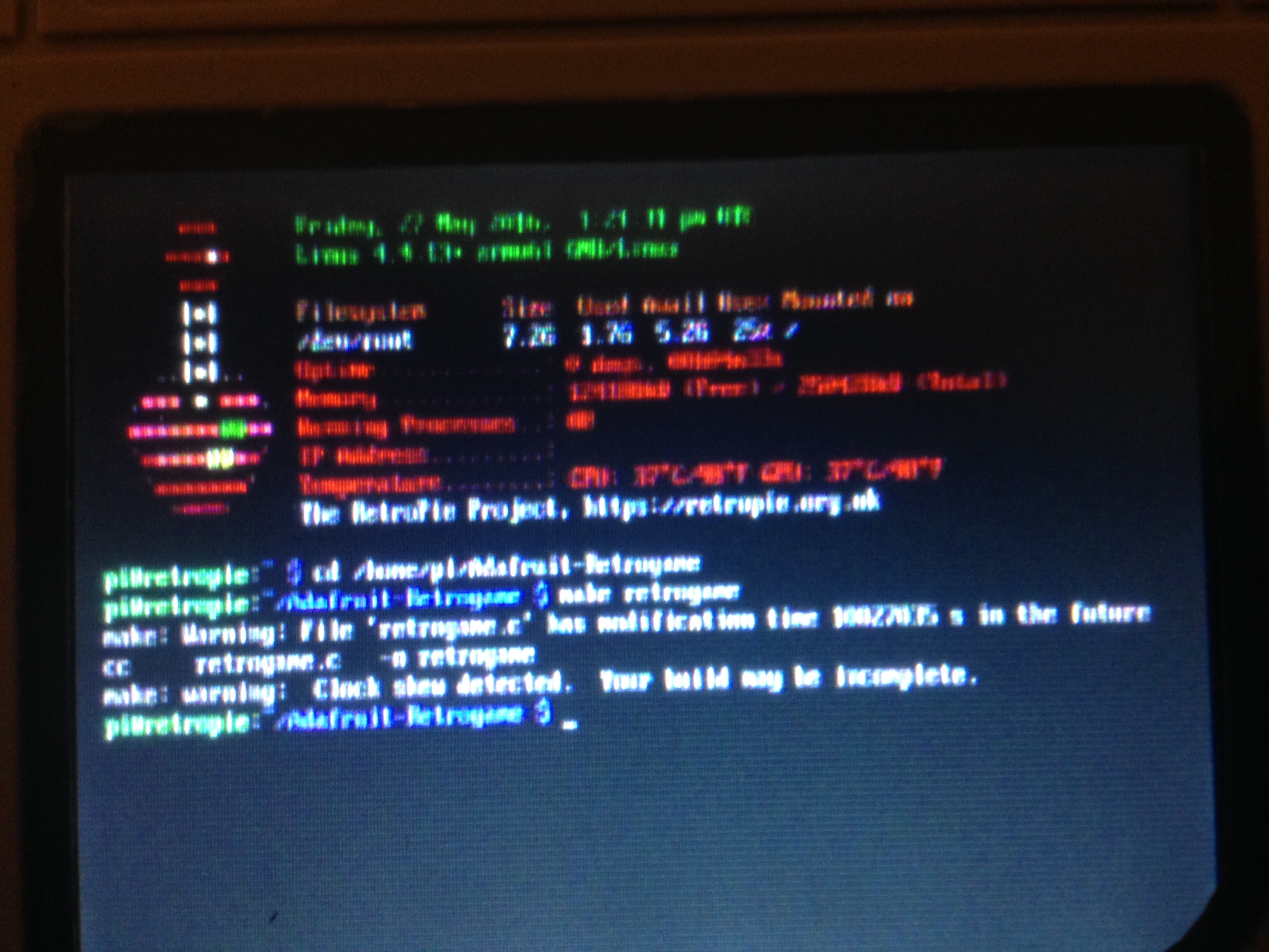

Hey guys,
i did the tutorial exactly as shown but on Retropie 4.0. Everytime i do
make retrogame
i just get an error message but i didn't change anything in the table so my problem can't be caused by this like it says in the tutorial. Can anyone please help me?

It says
make: warning: Clock skew detected. You build may be incomplete.

Post by myPiZero » Thu Sep 22, 2016 2:27 pm
I believe you can ignore this message.
stackoverflow
That message is usually an indication that some of your files have modification times later than the current system time. Since make decides which files to compile when performing an incremental build by checking if a source files has been modified more recently than its object file, this situation can cause unnecessary files to be built, or worse, necessary files to not be built.
However, if you are building from scratch (not doing an incremental build) you can likely ignore this warning without consequence.

Thanks! Got it working :D
