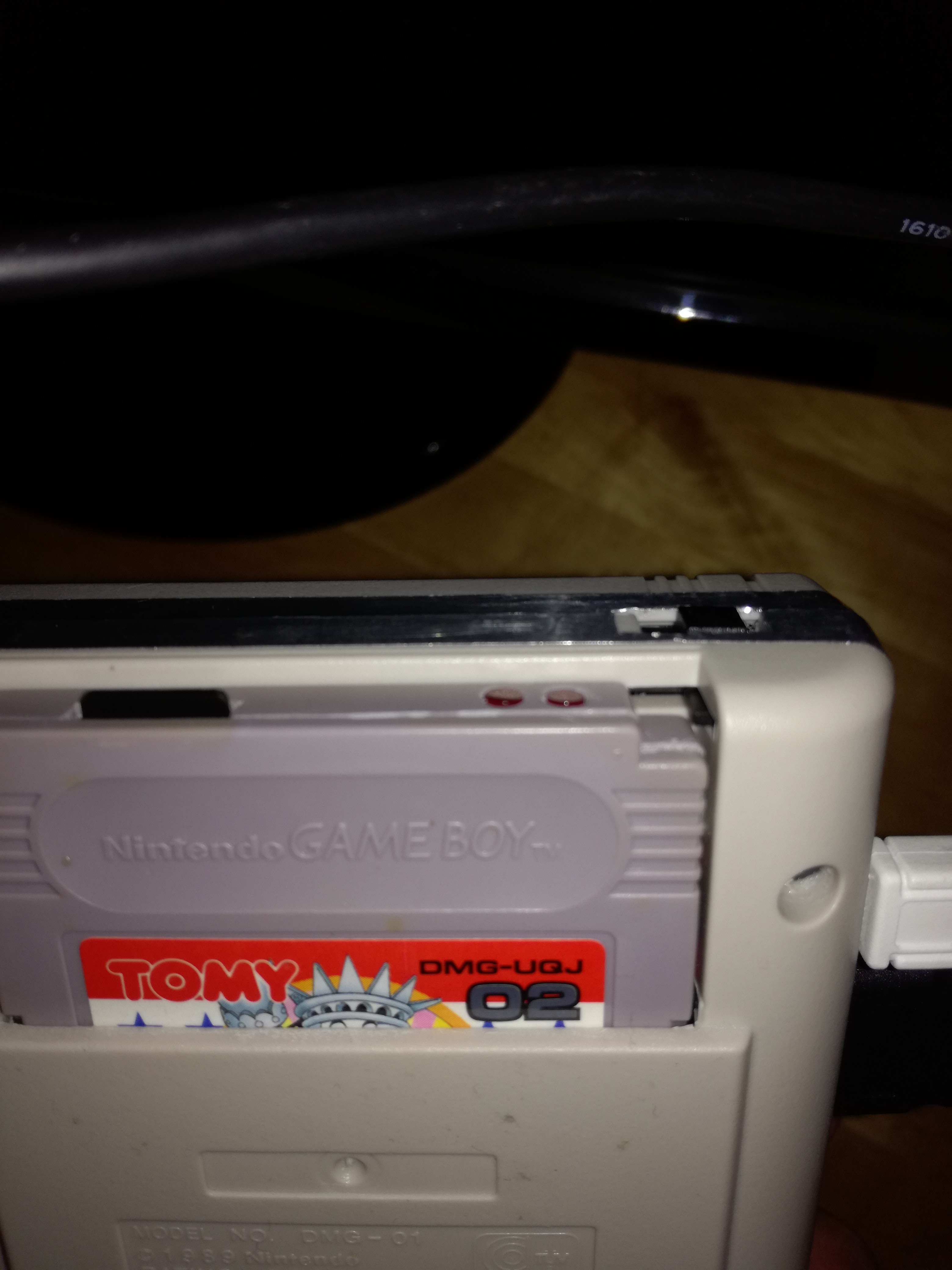

I placed low bat and charging LEDs in the rest of a cartridge. I used flat heat leds from ebay:
http://www.ebay.de/itm/140748947687?_tr ... EBIDX%3AIT
Finally another good idea I found somewhere was to put the Raspberry Zero into the cartridge shell to get access to the SD card from outside. Just wire up the external HDMI port was quite difficult to handle due to length and connector size issues but worked at the end.
