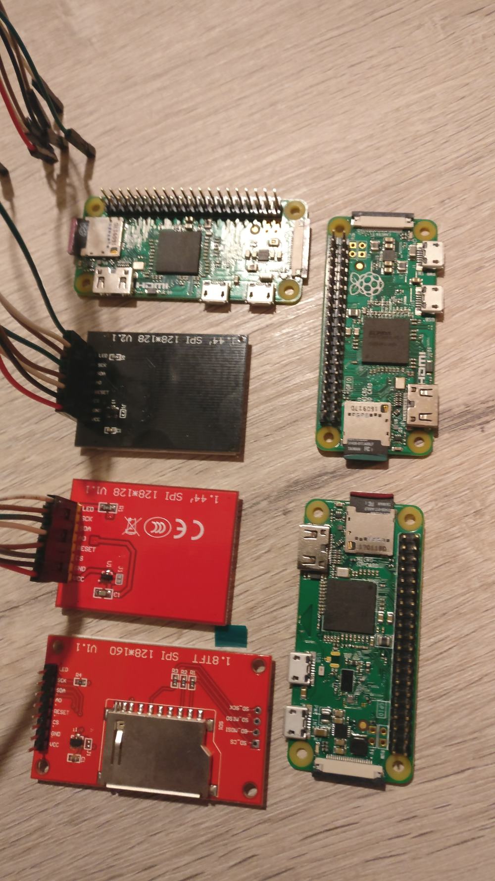

I would like some help, please.
I have a couple of SPI screens lying around, and would like to hook them up to a few of my Raspberry Pi Zeroes (W).
2017-09-21 21.26.26.jpg (231.74 KiB) Viewed 11076 times
My screens have the following text printed on them:
A red 1.44" SPI 128*128 V1.1
A red 1.8" SPI 128*160 V1.1
A black 1.44"SPI 128*128 V2.1
These screens, however, have slightly different pins:
I tried a few pinouts, but none worked... This was my latest try on the red V1.1:
Display Pin (GPIO)
LED 15 (22)
SCK 23 (11)
SDA 19 (10)
A0 16 (23)
RESET 18 (24)
CS 24 (8)
GND 20 (GND)
VCC 17 (3V3)
The command I entered was:
sudo modprobe fbtft_device custom name=fb_ili9341 gpios=reset:24,dc:23,led:22 speed=8000000 width=128 height=128
(I also tried different speeds and tried width=160, as I read somewhere that it actually is a 160*128 controller)
This gives me a black screen with some garbage pixels.. Backlight does come on.
Can anyone help me with a correct pinout and command?

Aha, your main problem is the driver on these smaller screens isn't actually ili9341
It will either be st7735r or ili9163, so try swapping the fb_ili9341 for fb_ili9163 or fb_st7735r
Also drop the speed to 40000000 the tiny screens don't like to go too fast.
Some of the v1.1 screens suffer from interesting issues with garbage pixels from a strange combination of screen and software configurations

Yes! Thanks so much!
I followed your instructions on https://retropie.org.uk/forum/topic/917 ... ld-wip/117 and combined it with your advice here :)
So now my pinout is:
Display Pin (GPIO)
LED 16 (23)
SCK 23 (11)
SDA 19 (10)
A0 18 (24)
RESET 22 (25)
CS 24 (8)
GND 20 (GND)
VCC 17 (3V3)
The contents of /etc/modprobe.d/fbtft.conf is:
options fbtft_device name=fb_ili9163 gpios=reset:25,dc:24,led:23 speed=40000000 bgr=1 rotate=1 custom=1 fps=60
I'm gonna write a little guide soon :)
