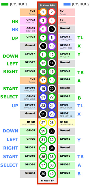

hi all, i have a problem with my setup on my GBZ (recalbox, usb audio).
i want to try this config, but i have a question.
for the input i used the gpio in this way:
gpio contact.jpg (82.31 KiB) Viewed 27273 times
can i used 2 free gpio pins or i must to use 13 and 18? on 18 there is Y button
ty far all

As you red in the post you quoted, there is a config in order to define the two audio pins dtoverlay=pwm-2chan,pin=18,func=2,pin2=13,func2=4. It allows to change the stardard ones, but I don't know if all pins are suitable.
Another possibility would be to use a usb-audiocard.
