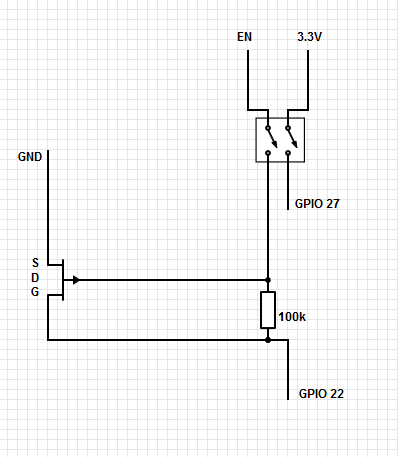

I have a problem:
when I use the switch my Pi reboots instead of shutting down
I got the Siliconix JFET
Here's my wiring:
Using the wiring shown in the first post my Pi shuts off immediately
Reversing Source and Drain works, but I'll get Kernel panic when the Pi tries to shutdown :(
The label on the backside of the JFET reads:
Image2N
5460
T8630
Camble

@fdeluxe Your diagram shows the gate as being connected to the EN pin, where it should be connected to GPIO22. The gate may be pin 3 on the JFET, but it's the one with the arrow on the symbol.

Camble wrote:@fdeluxe Your diagram shows the gate as being connected to the EN pin, where it should be connected to GPIO22. The gate may be pin 3 on the JFET, but it's the one with the arrow on the symbol.
Yup, I know that the gate is the one with the arrow. Sorry, my diagram is faulty. For my diagram just pretend that the arrow one is drain.

@fdeluxe Test it without the 100K resistor, then try it with the resistor between the Gate and Source.
