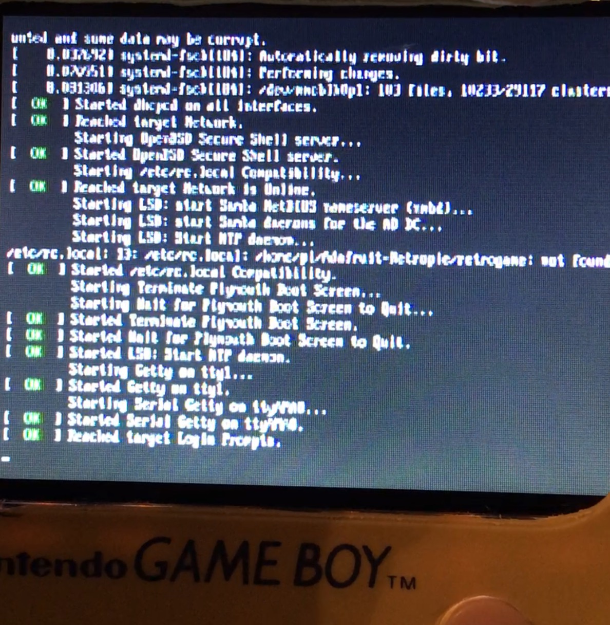

When I input the command to see if ./retrogame is working I just get a blinking underscore below the text am I doing something wrong should I see some code or config populate? I enclosed what shows up when i boot Retropie, says :Not Found, please help me. Thanks for your time.
- FullSizeRender.jpg (390.75 KiB) Viewed 21487 times
- IMG_0332.JPG (2.09 MiB) Viewed 21487 times
