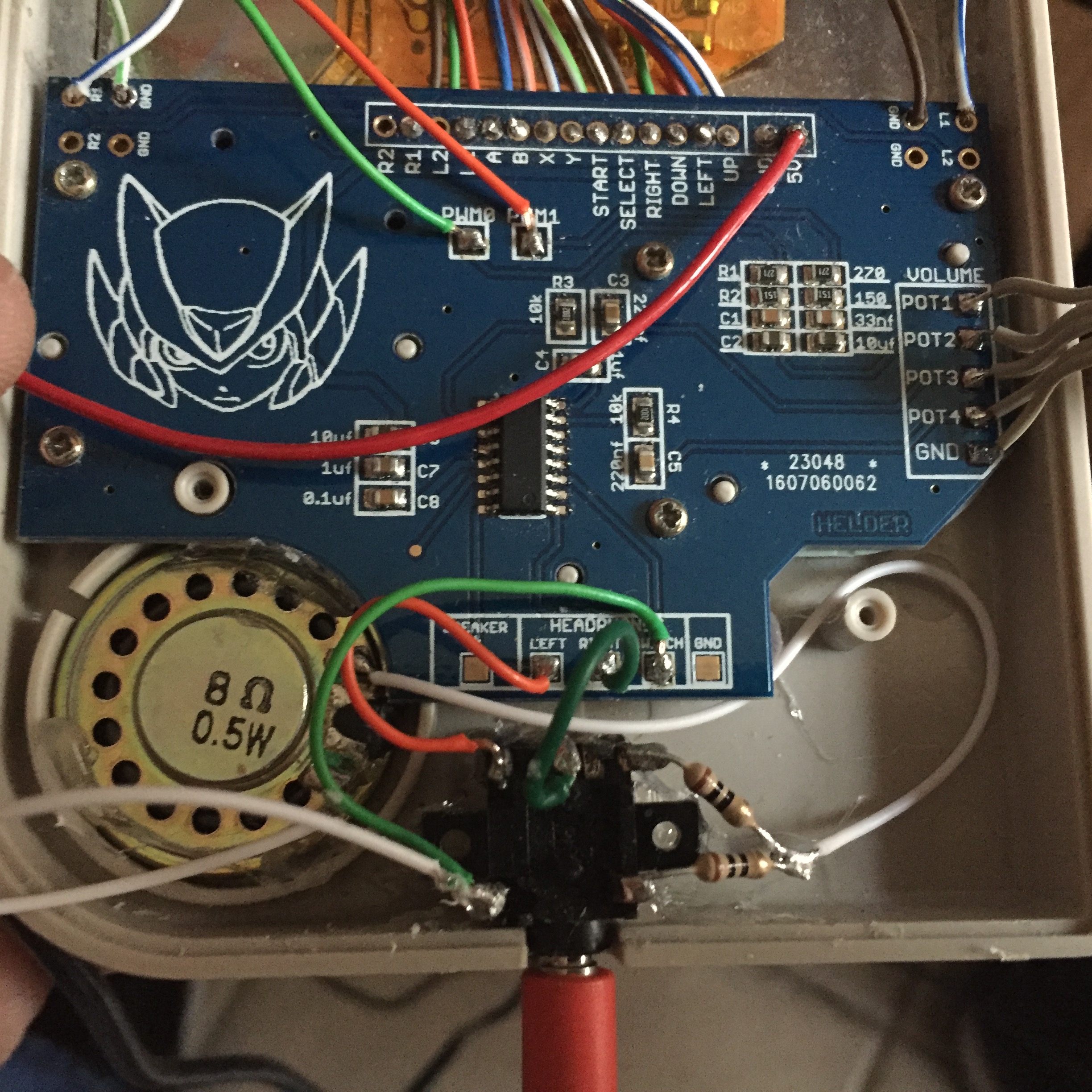

Hey guys I've been trying to follow this guide to get audio working and I get nothing but air
Seems I have it connected right

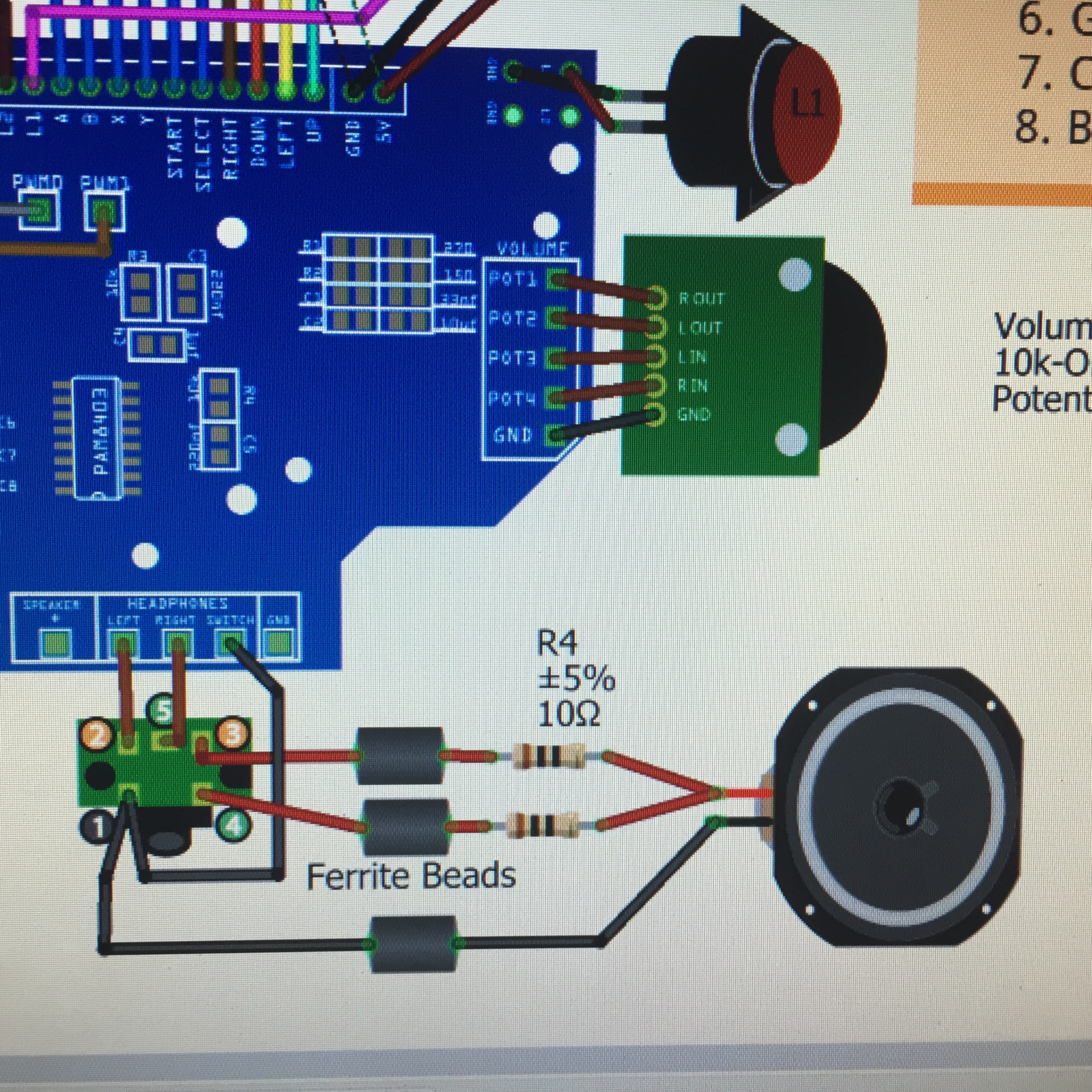

I'm not super familiar with the original headphone socket but to rule that out just hook up the Speaker and skip the headphone socket. Put the Switch pad to the Negative terminal and Either Left to Right to the Positive and see if that works.
Most audio issues are the wiring and that people don't set up the PWM audio in the Config.txt file, also you volume wheel might be upside down and the wiring is wrong but you don't have an image of that so I can't comment.
Another thing I notice is that there is no GND connection next to the 5V connection, I see GND on the L1/R1 but I doubt those are connected to the GND of anything else.

I got the ground wired, but it's from the other side like the rest of the wires going to teensyHelder wrote:I'm not super familiar with the original headphone socket but to rule that out just hook up the Speaker and skip the headphone socket. Put the Switch pad to the Negative terminal and Either Left to Right to the Positive and see if that works.
I'll try what you said and rewire things to test out the speaker. The wheel is connected correctly as well

PWM Audio configured in the config.txt?skrapps914 wrote:I got the ground wired, but it's from the other side like the rest of the wires going to teensyHelder wrote:I'm not super familiar with the original headphone socket but to rule that out just hook up the Speaker and skip the headphone socket. Put the Switch pad to the Negative terminal and Either Left to Right to the Positive and see if that works.

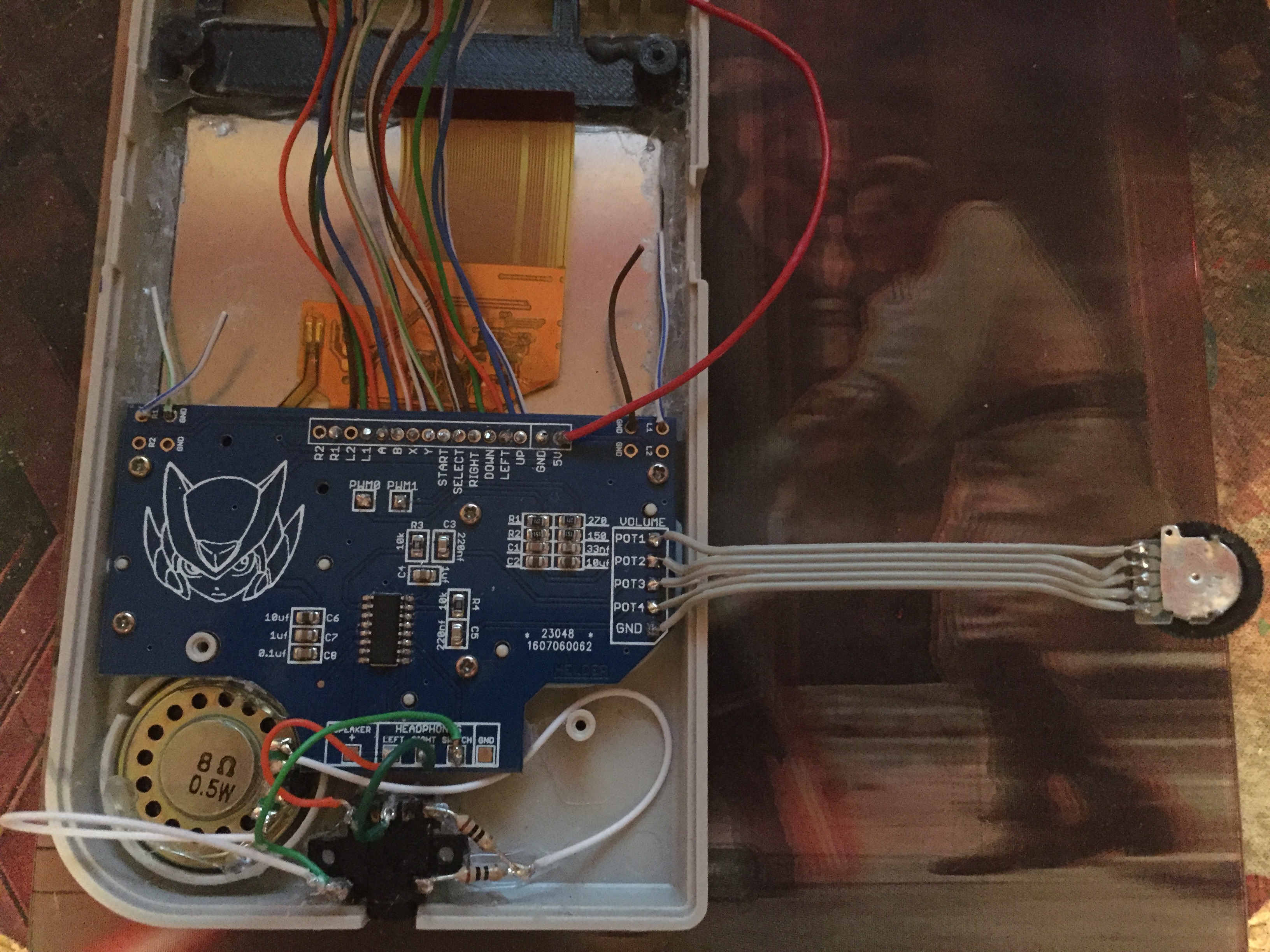

you know, i dont think i did that..and im not sure how to.. haha. Here's a pic with the volume wheelHelder wrote:PWM Audio configured in the config.txt?skrapps914 wrote:I got the ground wired, but it's from the other side like the rest of the wires going to teensyHelder wrote:I'm not super familiar with the original headphone socket but to rule that out just hook up the Speaker and skip the headphone socket. Put the Switch pad to the Negative terminal and Either Left to Right to the Positive and see if that works.
edit:. i enabled pwm audio by adding the line at the end of config.txt, was able to get sound only through headphones. left side has more volume than right side. when i removed the headphones, no sound came through the speaker going to try swapping wires on speaker, maybe i have L/R mixed up
edit2: it appears my dmg jack is messed up. i tried swapping wires, had the same result.. i pulled the headphones out half way, and got full volume in the headphones on both sides. speaker still does not work when the headphones are removed fully.
- image.jpeg (1.82 MiB) Viewed 17608 times

Just buy one of the cheap alternative jacks (easier to wire up).skrapps914 wrote: edit2: it appears my dmg jack is messed up. i tried swapping wires, had the same result.. i pulled the headphones out half way, and got full volume in the headphones on both sides. speaker still does not work when the headphones are removed fully.
