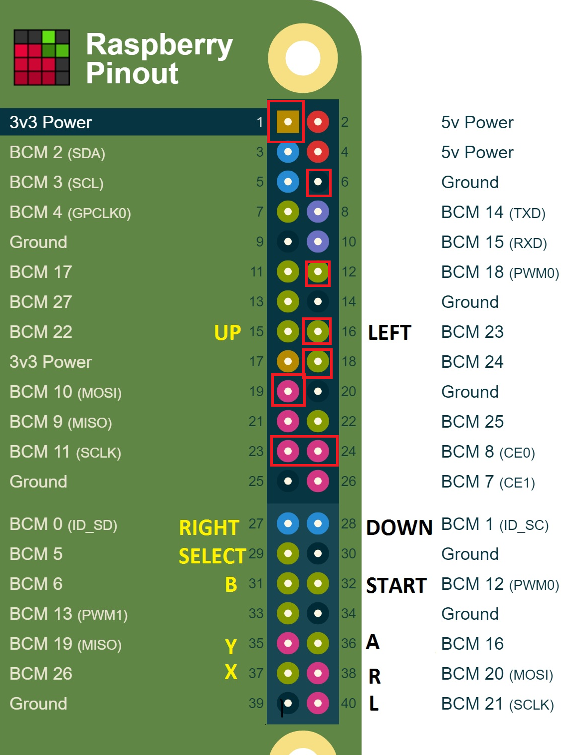

Hello! I'm hoping to use this plan in order to connect up a SNES controller to a Pi Zero, but a question - I assume I can use a different BCM pin, and define that in the retrogame.c file if need be? Attached is a diagram of which pins my screen needs boxed in red - I assume I can move LEFT from pin 16 to 22, define it as such, and done?
