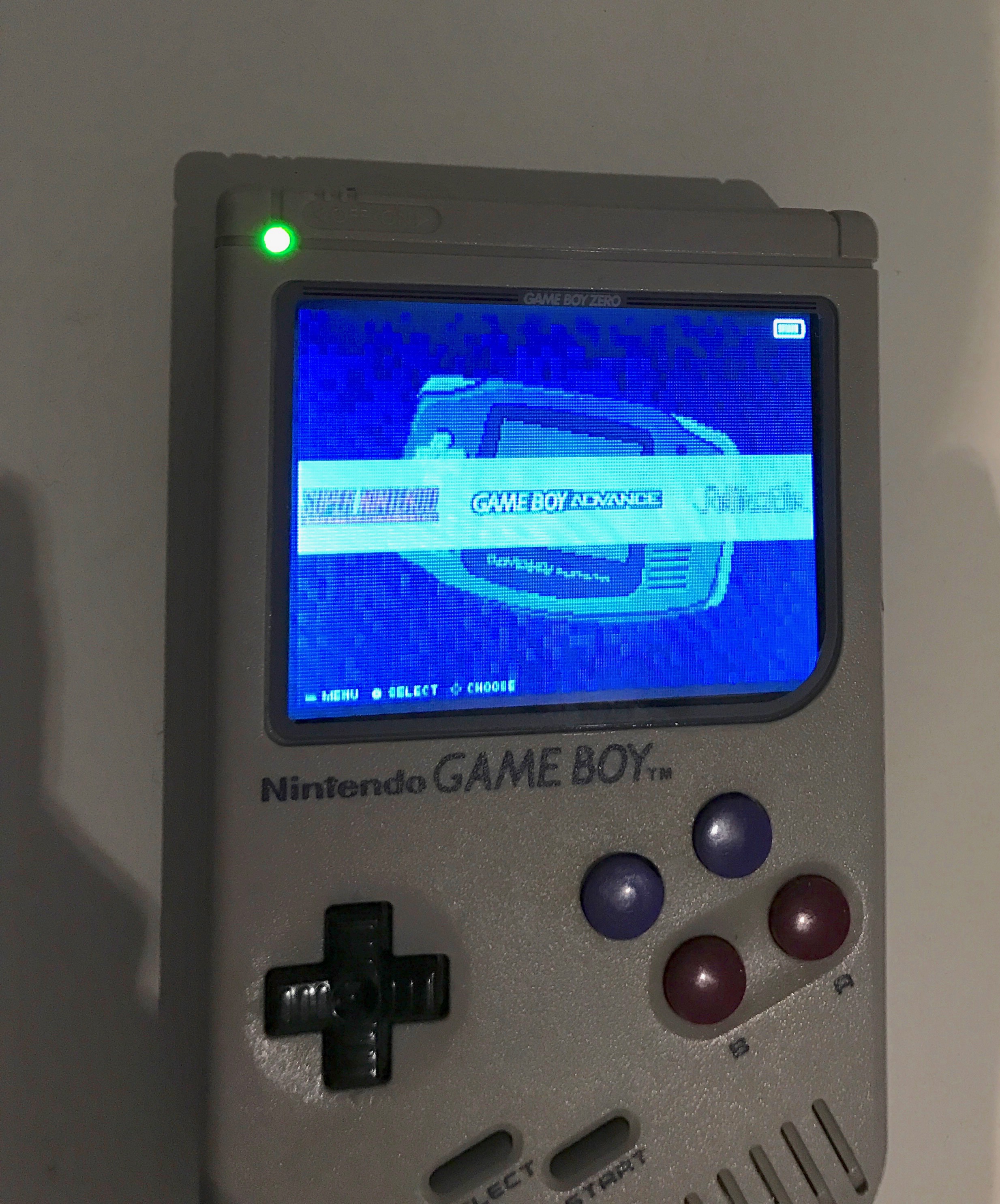

Hi all!
I'we finally found some spare time to do a short rough guide on how to add a battery indicator on your GBZ with a MCP3008.
This guide include the hardware installation of the MCP3008 chip, hardware/software part for using LEDS, software part for using videoclips for warnings and shutdown, and software part for having a onscreen battery icon.
Some skills with hardware, and software is required for getting this to work properly!
https://github.com/joachimvenaas/gbzbatterymonitor
It's very rough, so if you have some problems, let me know!
Also, modify as you like! And if you make it better, make sure everyone to post it here so everyone can take advantage of it!

- IMG_0308.jpg (1.62 MiB) Viewed 34971 times
