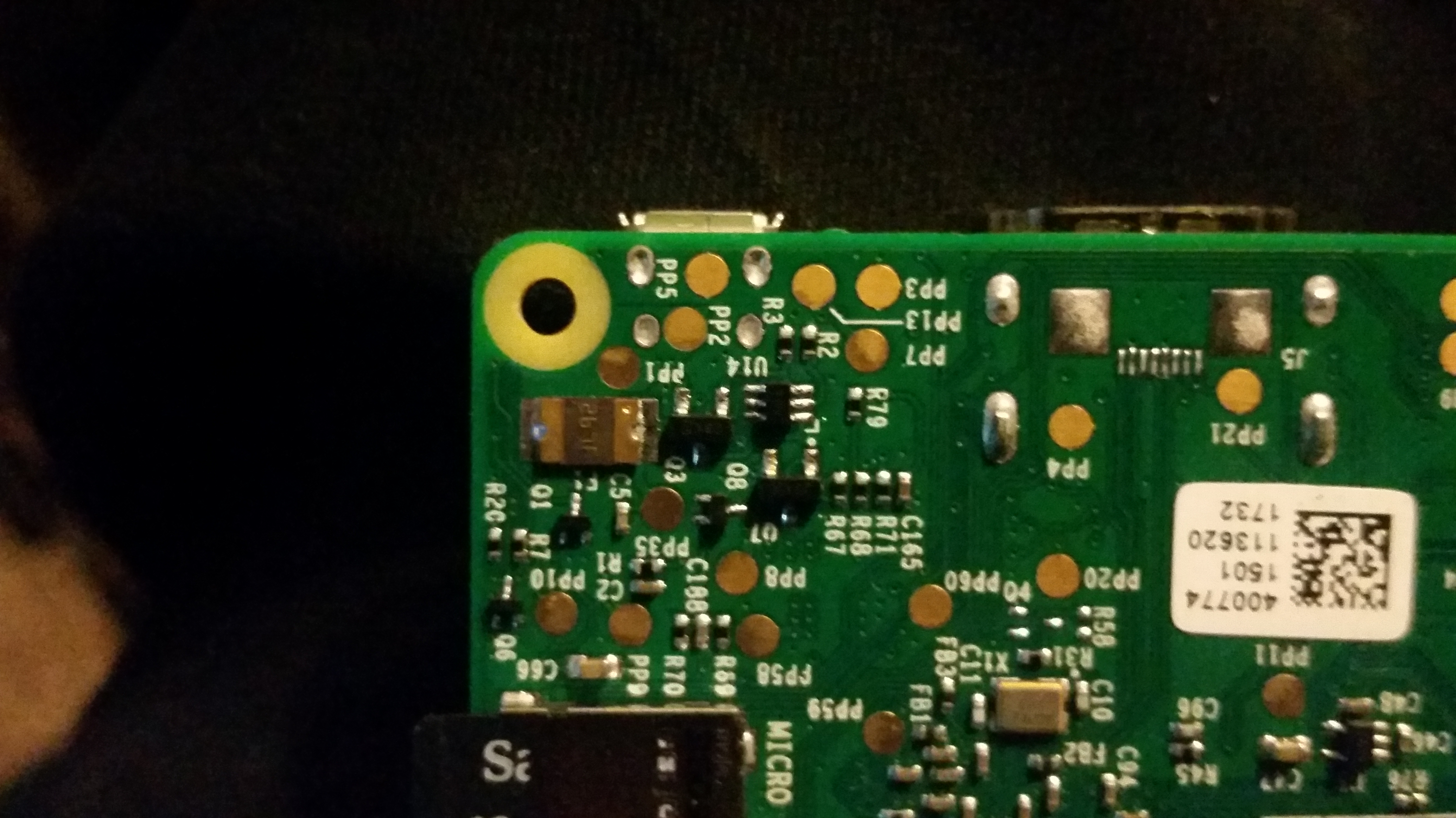

So I bought this nespi case:
https://www.amazon.com/dp/B075R4D7F6/re ... BAb5NY5XAC
The only thing I don't like about it is the fact it powers the pi threw the GPIO pins and it bypasses the overload protection circuit.
I got to looking and the micro usb power port and on the bottom side I noticed it had solder pads (pictured)
Pads under usb port
Am I able to solder my ground and +5v line to 2 of these and power the pi threw the protected circuit?

Post by tinkerBOY » Sun Jan 28, 2018 6:52 am
Yes those are the right pads for protected 5v and gnd.

Re: Pads under pi 3 power plug
Post by cainkirisgai » Thu Feb 08, 2018 11:28 am
yes you can I am currently doing that now with my project that i am building. Feel free to take a look
