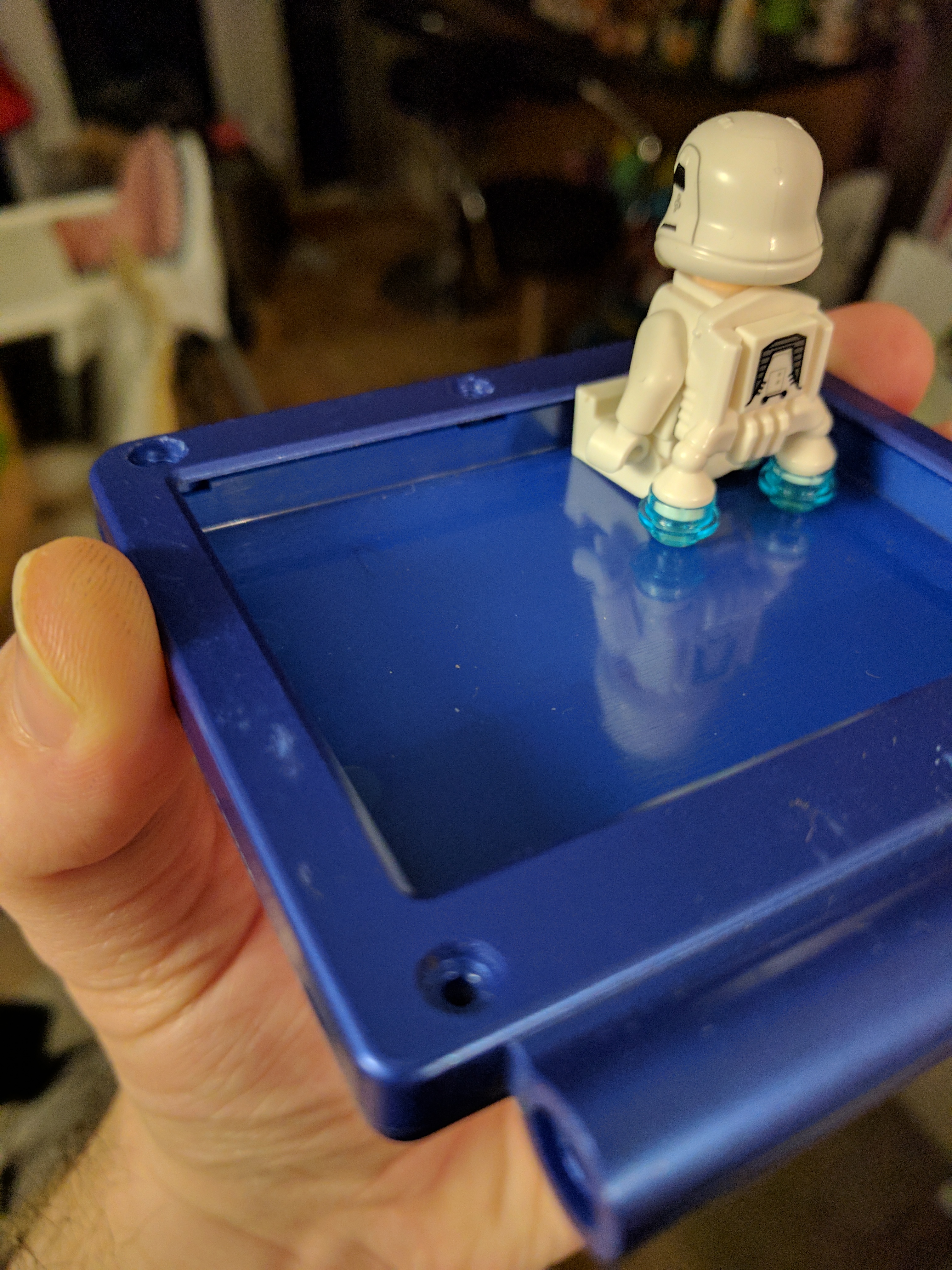

Ok I've checked out the SP case.
It's small. Really small.
The screen part only has about 6mm of clearance.
Less than a lego stormtrooper minifig foot...
And the lens fits under the lip there too... So that's another 3/4 mm gone

awwww i dont have my calibrated stormtroper foot with me :(
how about 'eraserhead from the new lego batman film?'

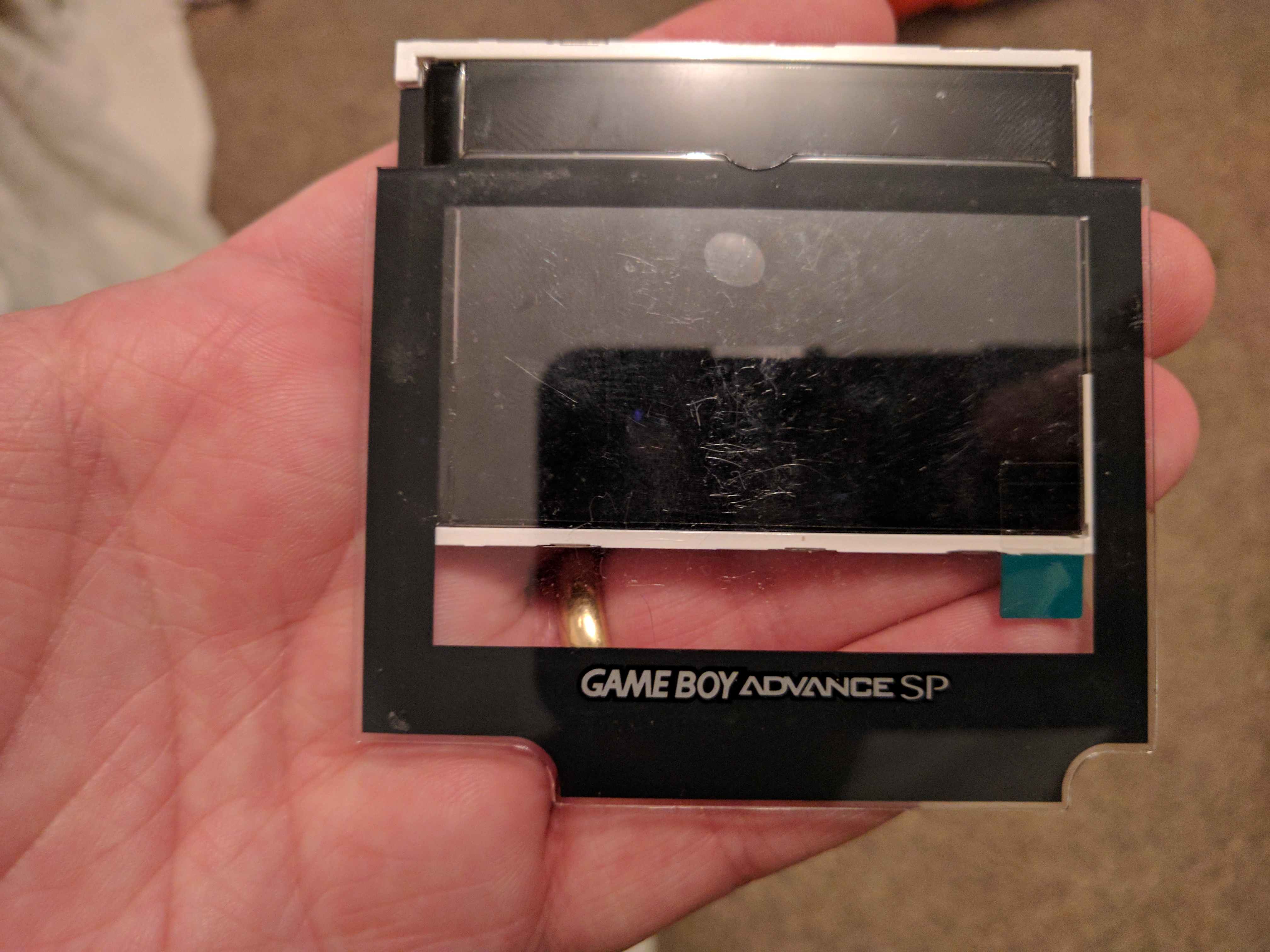

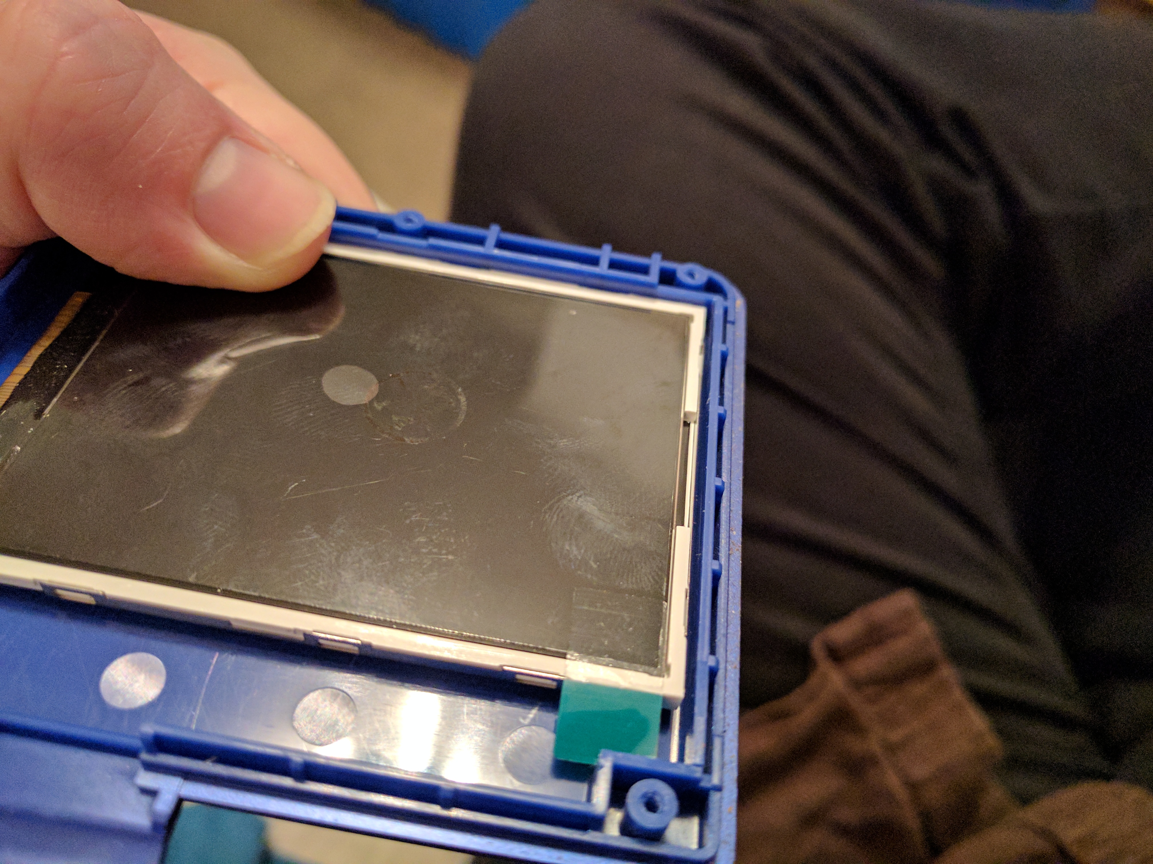

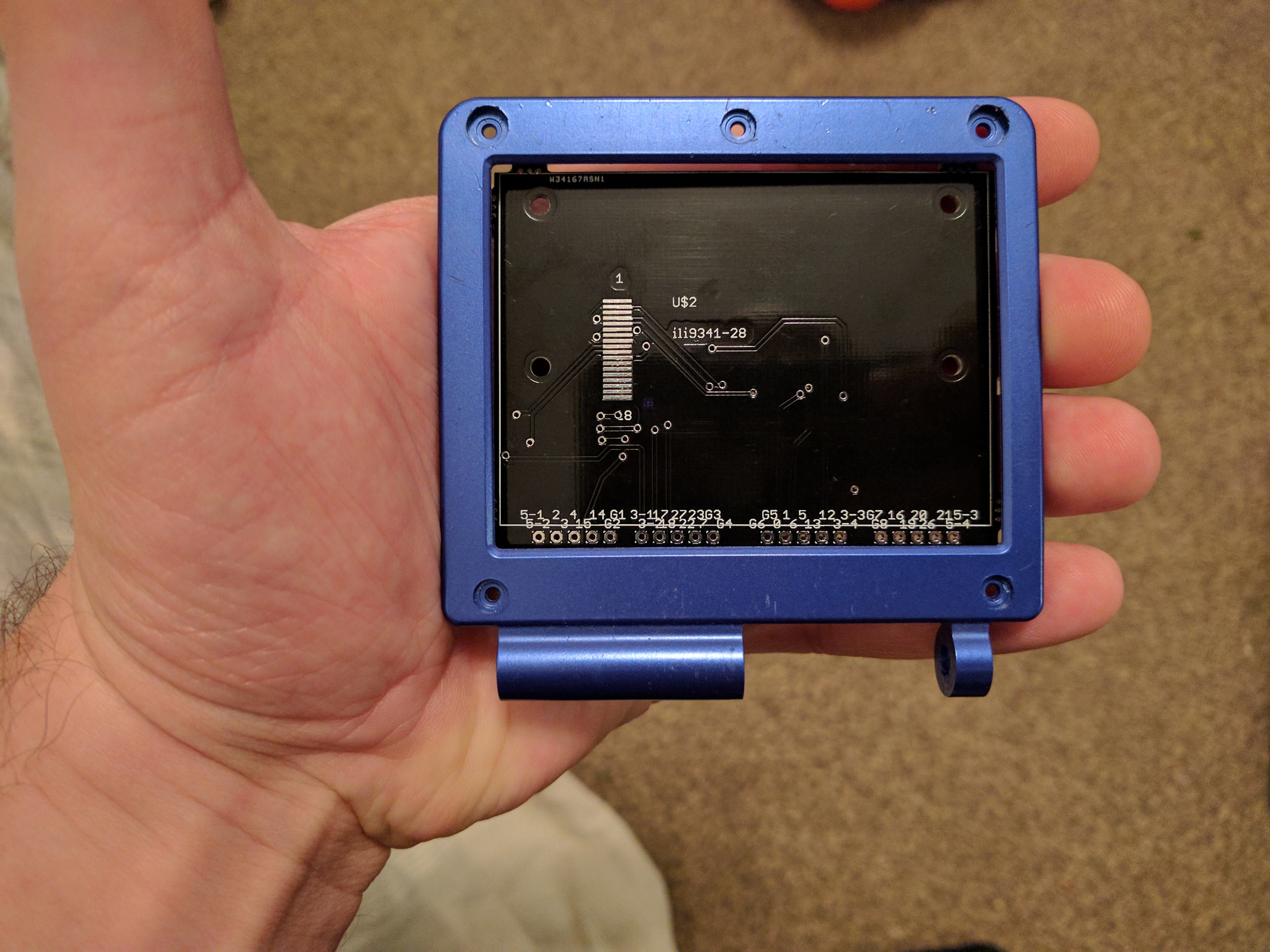

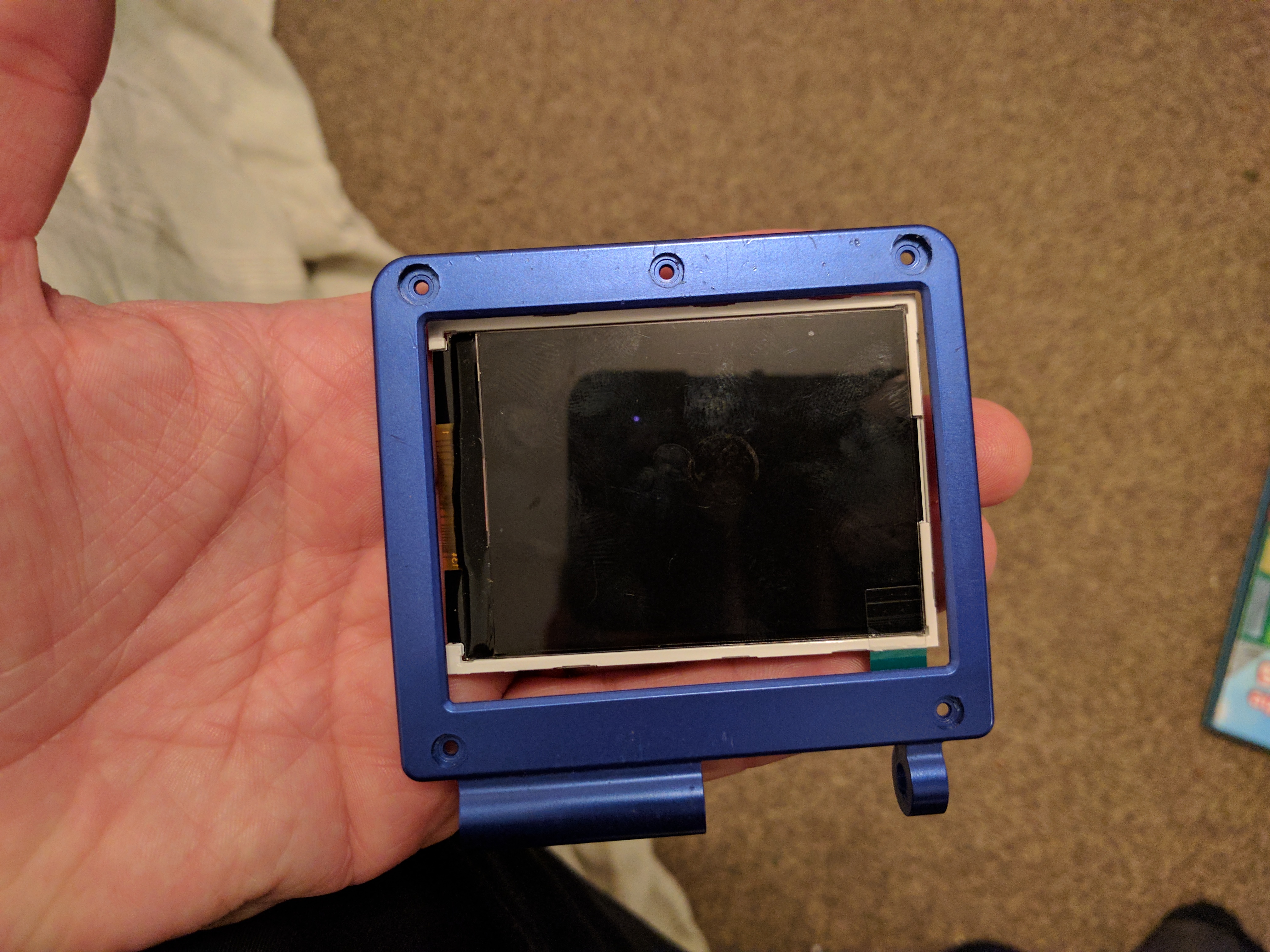

Post by abrugsch » Mon Mar 20, 2017 6:03 pm
Here's moosepr's carrier board for a 2.8" screen so you can see the outline:
and the screen itself
Screen compared to lens
The ridge is essentially the top of the space we have to play with as it holds the lens into the frame
So yeah, screen + 1 carrier PCB is about as much as we can get in there
