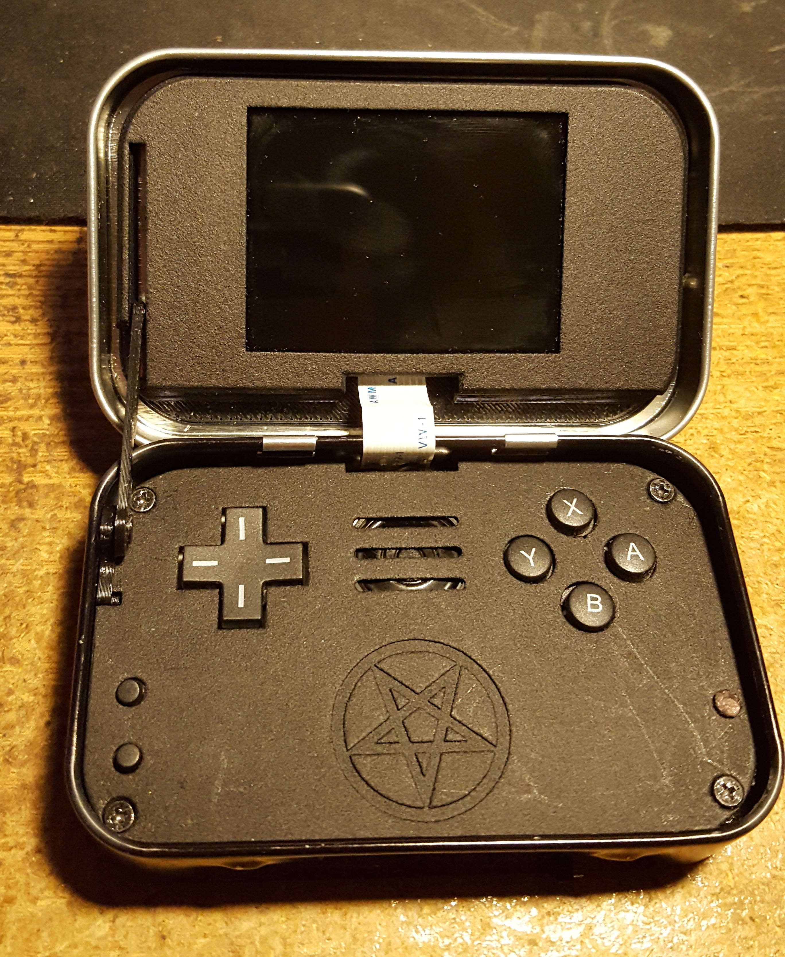

Here's a look at the finished tin:
All done!Show
spookypi closed.jpg (857.26 KiB) Viewed 7382 times
Check it out!Show
spookypi open.jpg (1008.4 KiB) Viewed 7382 times

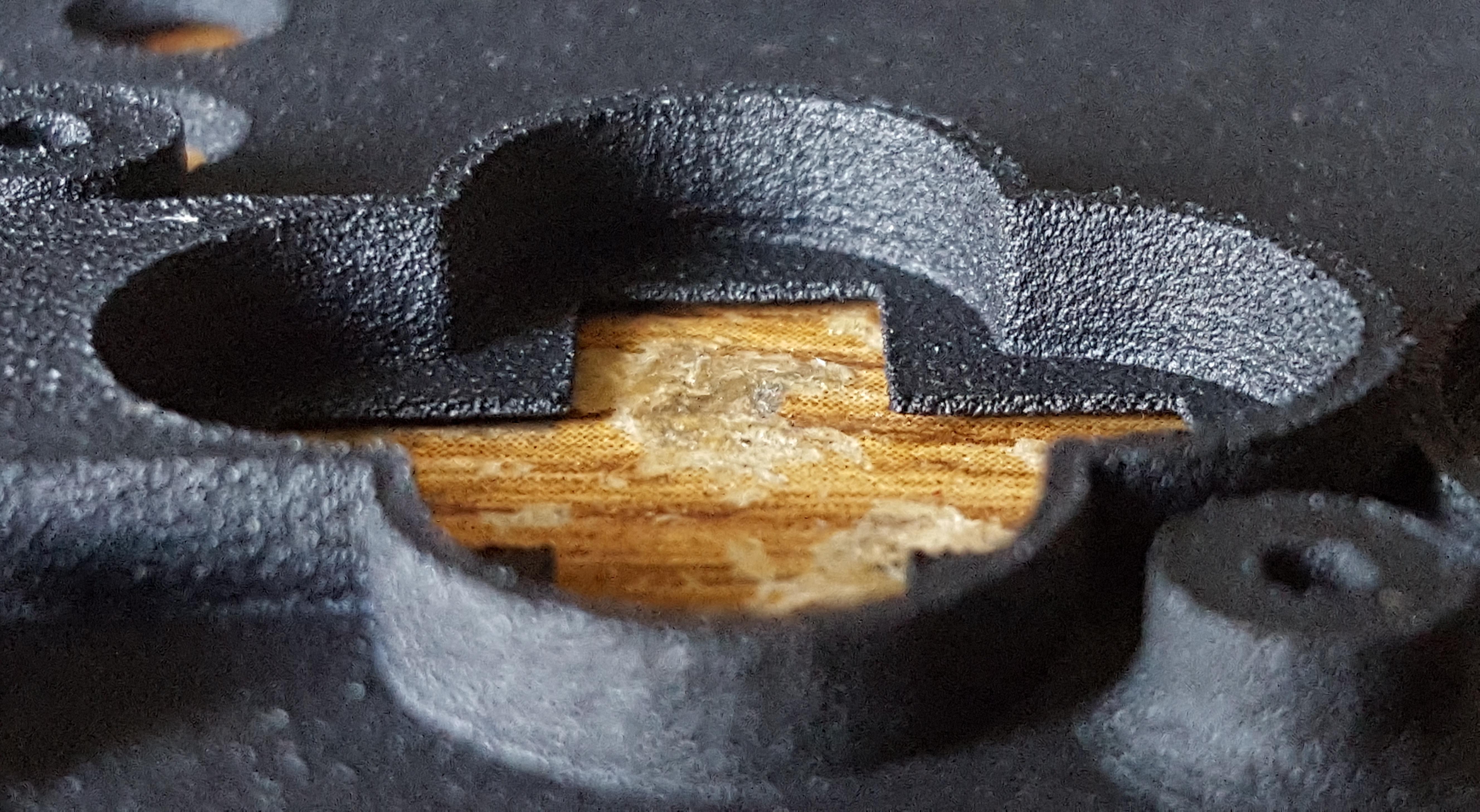

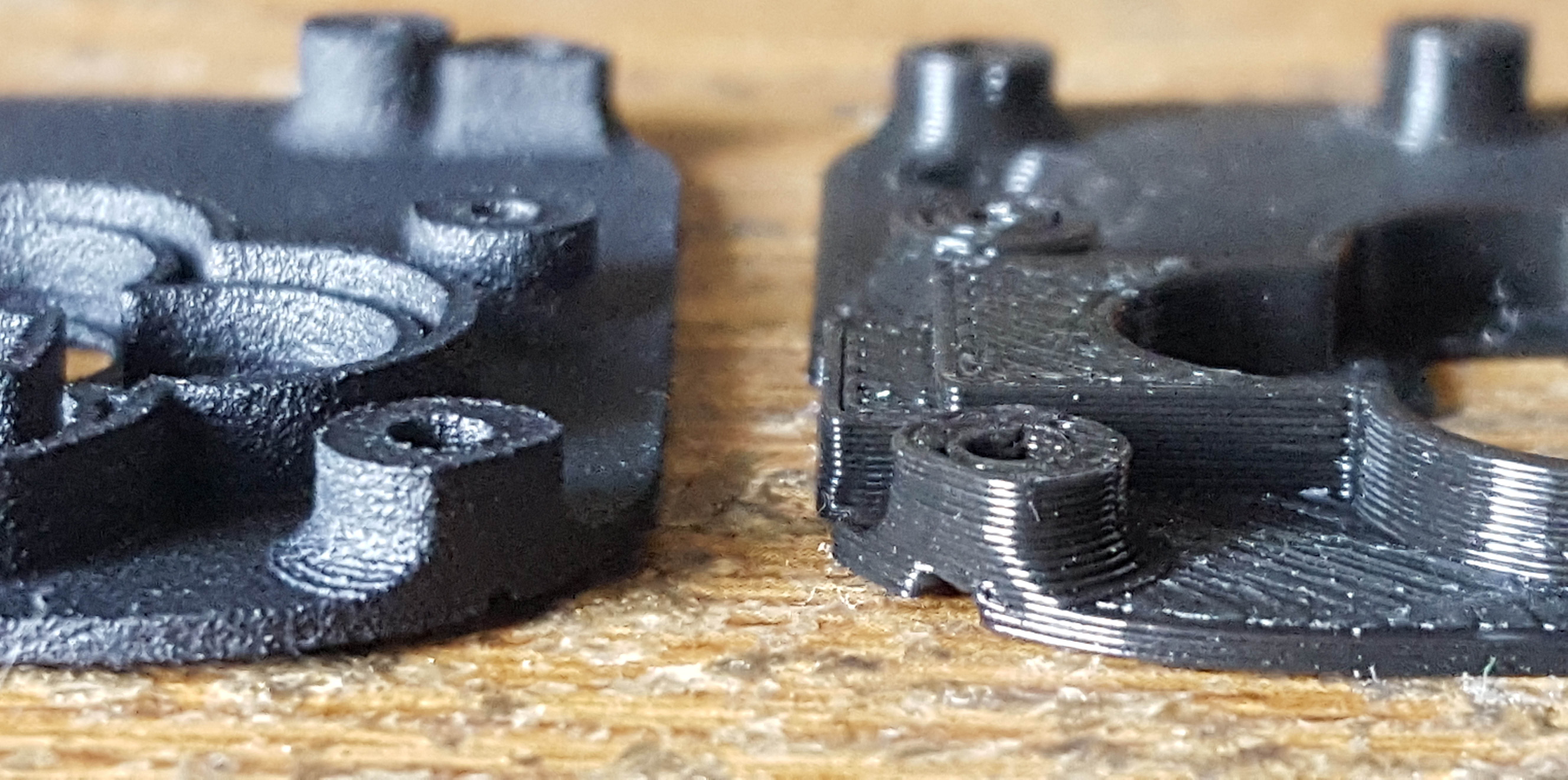

So I decided to go with nylon instead of plastic.
Nylon vs PlasticShow
nylon vs plastic.jpg (892.4 KiB) Viewed 7382 times
As some of you might have discovered in your own builds, those ridges caused by extrusion printing can make the buttons stick like crazy! I tried sanding the bumps down on my first build, but I went overboard and ended up sanding too much. So I decided to go another way. Horray for SLS printing!
Look ma, no ridges!Show
d pad goodness.jpg (1.25 MiB) Viewed 7382 times

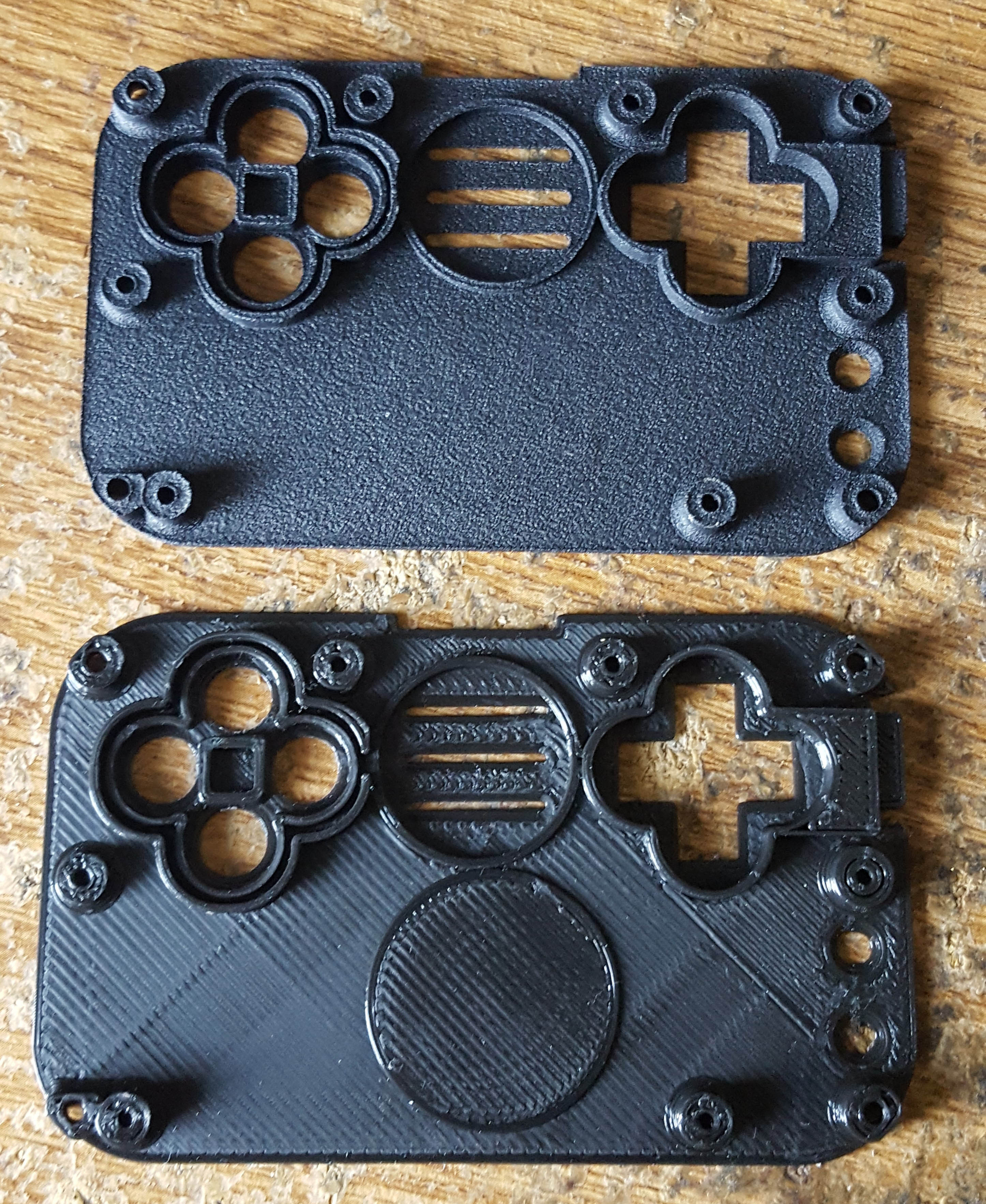

I got a batch of Wermys prints, so I could use the screen and faceplate brackets, as well as the screws. Hoolyhoo helped my change the mintypi logo to a pentagram (thanks again!) I sent the modified file off to Shapeways for printing, as well as the screen bezel (so they'd match.)
Faceplates frontShow
faceplate comparison frontside.jpg (1.13 MiB) Viewed 7382 times
Faceplates backShow
faceplate comparison backside.jpg (1.22 MiB) Viewed 7382 times

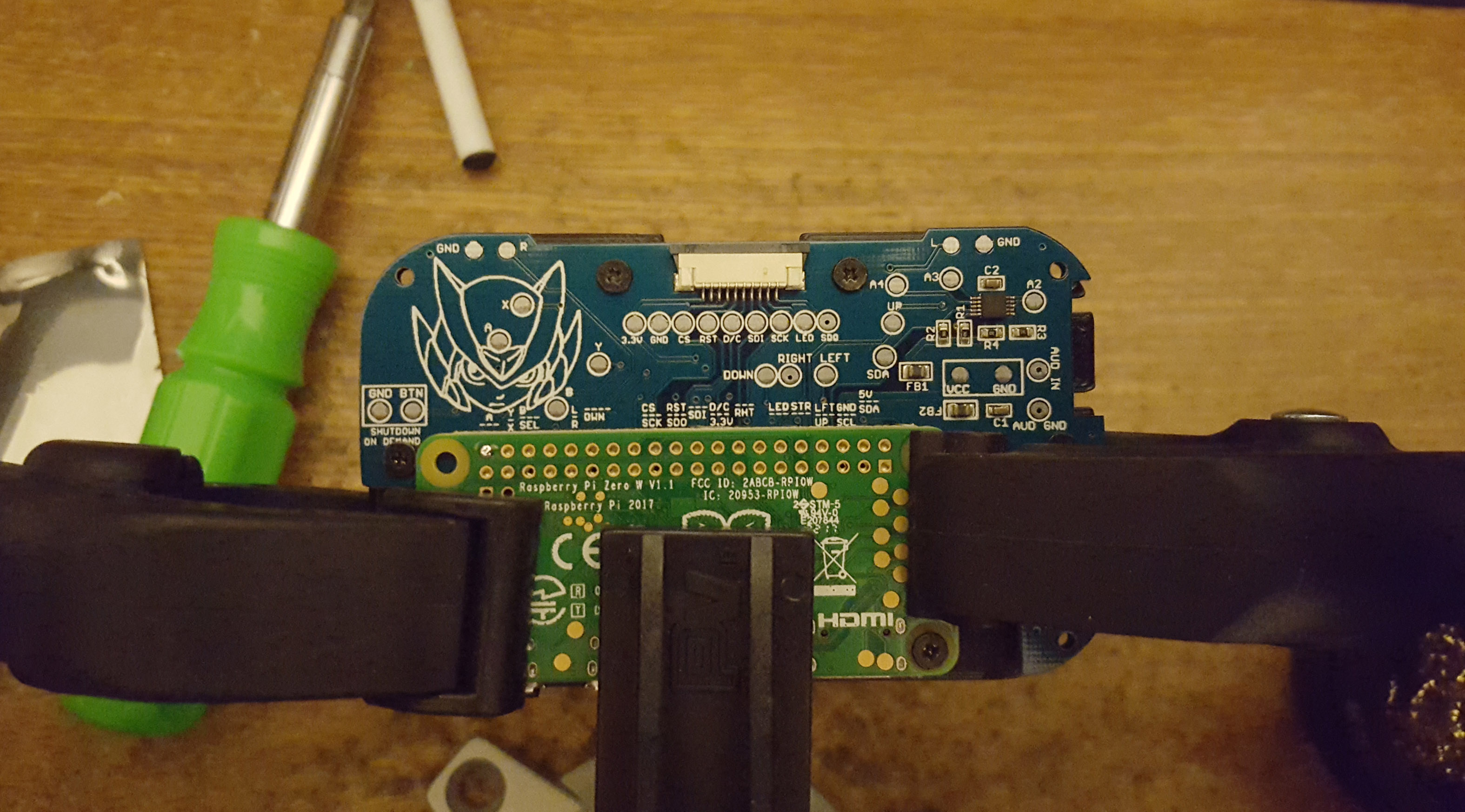

I used the plastic faceplate to screw down the pi zero w for the purposes of soldering all the GPIO pins.
Clamped up and ready to solderShow
one down thirty-nine to go.jpg (810.06 KiB) Viewed 7382 times
Is it necessary to fill all those holes? No.
Was it easy? This time around it was!
Do yourself a favor and get some nice thin solder. I got some Kester "44" 63/37 0.015" solder off Amazon, and it made all the difference.

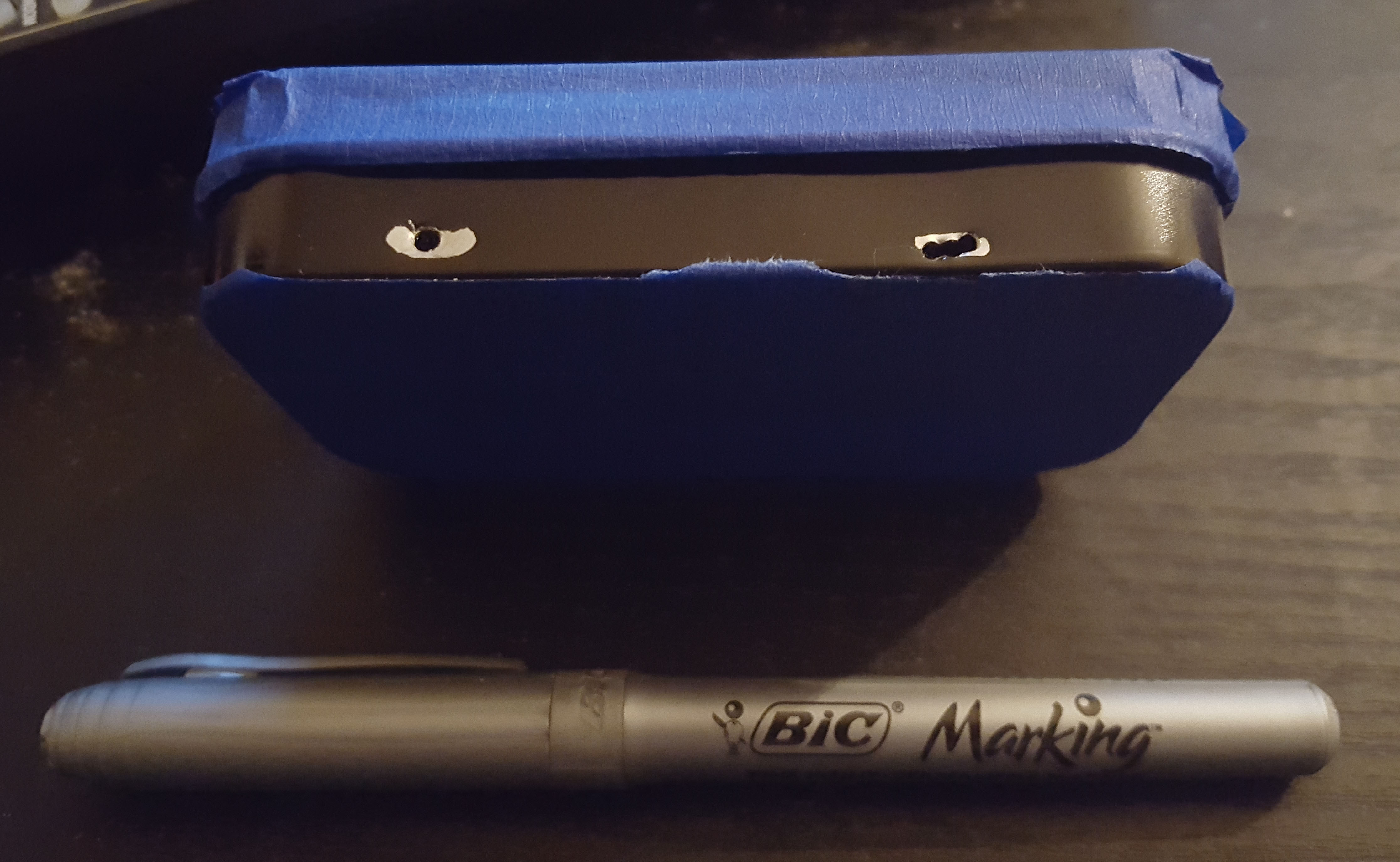

I know some people have been having issues with the drill guides on a black case. I was too! My solution?
How to mark the spots on a black caseShow
silver sharpie to the rescue.jpg (839.8 KiB) Viewed 7374 times

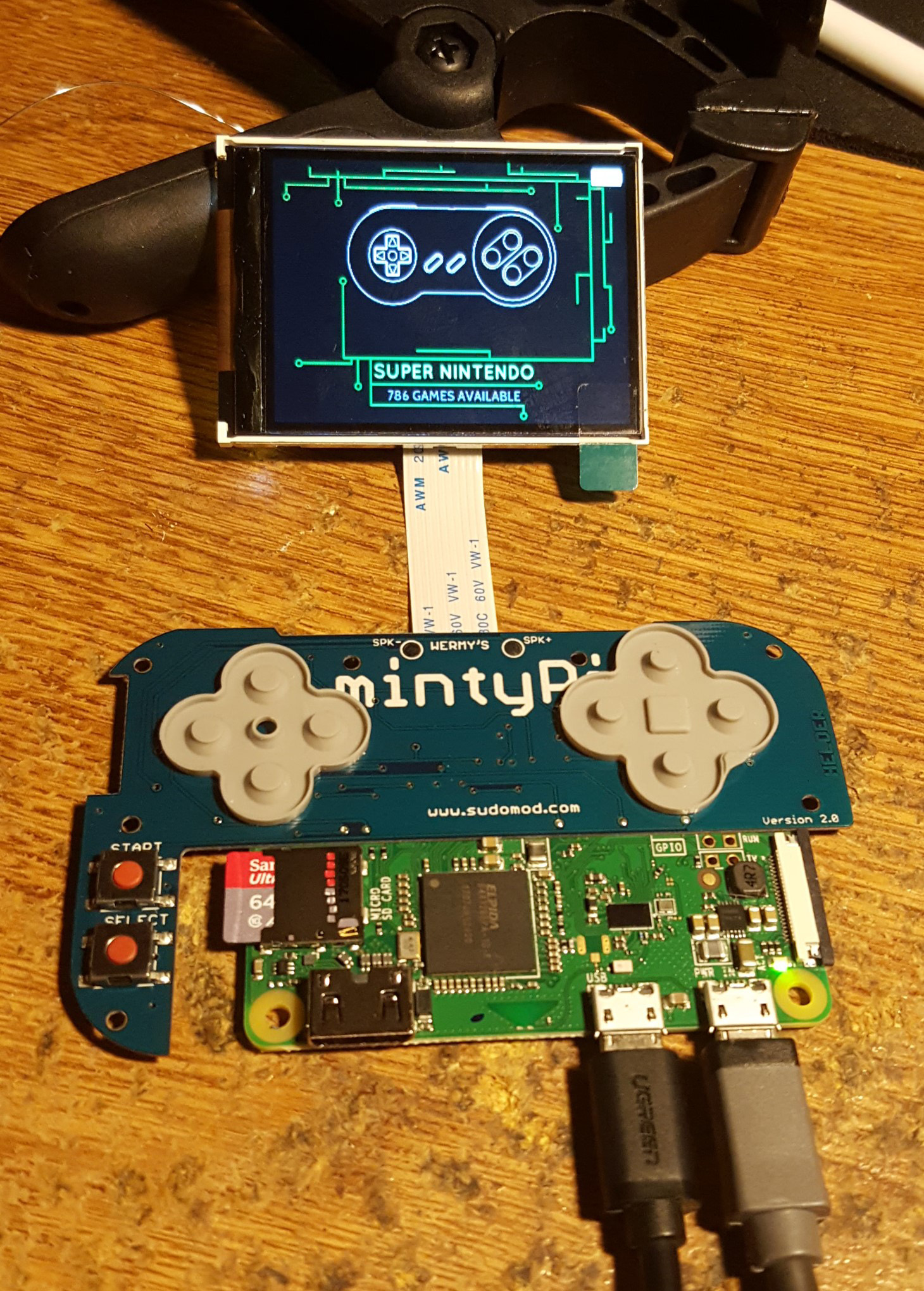

Silver paint pen did the trick!
After all that soldering, I had to take it for a test run.
It's alive!Show
its alive.jpg (897.34 KiB) Viewed 7374 times

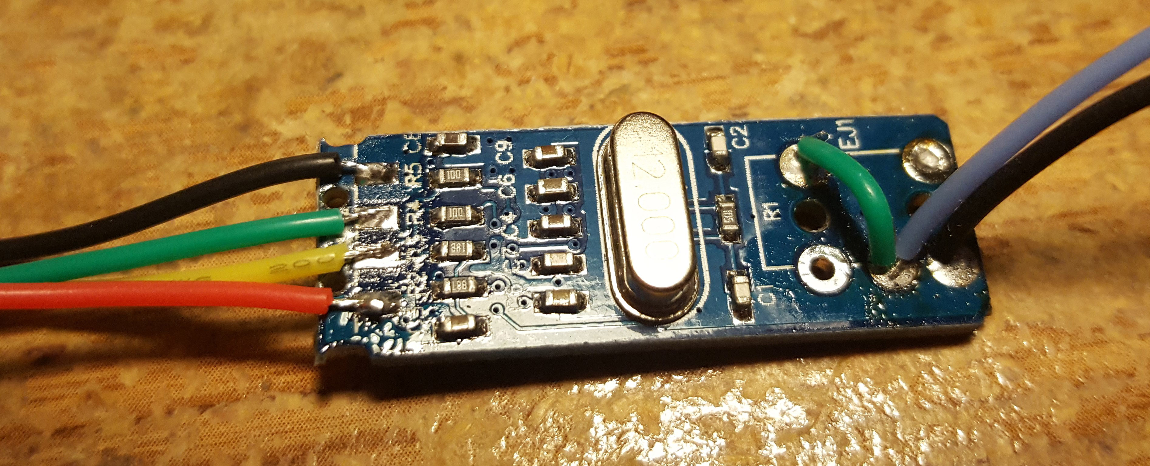

Here's a tip - this stage is the PERFECT time to get the software side of things done. Get a USB OTG adapter and a USB hub. Plug in a keyboard and a USB to ethernet adapter, and plug that in to your router. Trust me, transferring gigs of files across a wired connection is a whole lot faster than wifi!
This time I was super careful not to pull off a pad on my sound card.
Sounds good to meShow
sound card all wired up.jpg (1.1 MiB) Viewed 7374 times

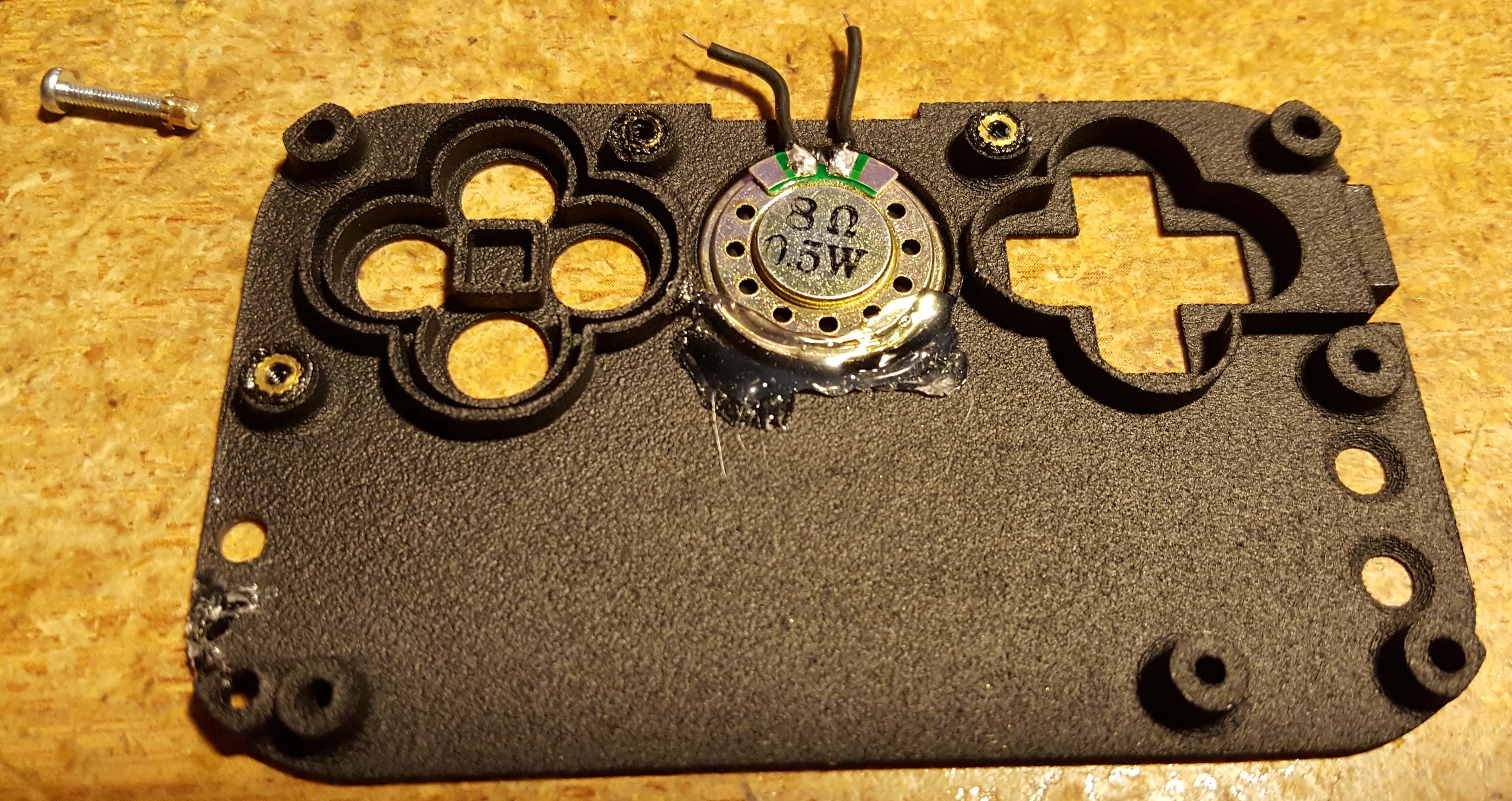

So, the biggest hurtle I ran in to during this build turned out to be the nylon print. It looks cool, and the buttons are no longer an issue. The problem with the material? It's soft! I went to screw down the board to the bottom of the faceplate, but the screws weren't carving threads. They pulled straight out with barely any effort.
I was stuck. I didn't know what to do. Dark days were upon me. But then, I remembered a thread on the For Sale/Trade section of the forums, "HoolyHoo's AIO bracket for Kite's SAIO Board" viewtopic.php?f=38&t=2553 Hoolyhoo was using brass M2 inserts in the bracket, and was selling loose brackets and screws. I ordered eight inserts and waiting patiently for them to arrive in the mail.
brass M2 insertsShow
brass insert.jpg (1.33 MiB) Viewed 7374 times
These were exactly what I needed! I don't have a chisel tip for my soldering iron, so I carefully pressed them in to the print with the tip of my soldering iron directly, then used a small flathead screwdriver to hold the insert still while I lifted out the iron. Here's a pic of three installed.
Inserts installed!Show
brass inserts to the rescue.jpg (1.16 MiB) Viewed 7374 times
By the end of the build I had put those in every screw post. They saved my project for sure.

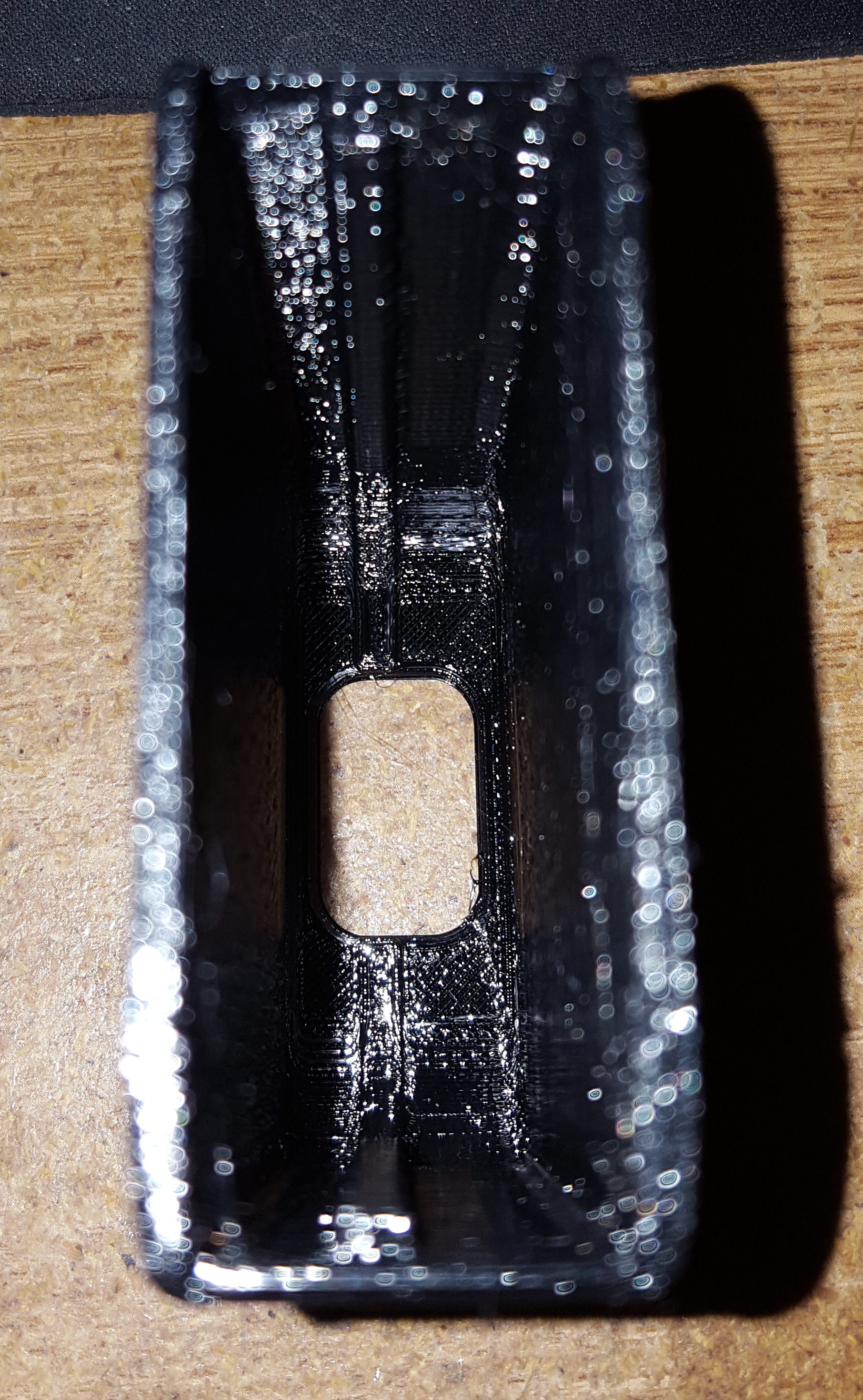

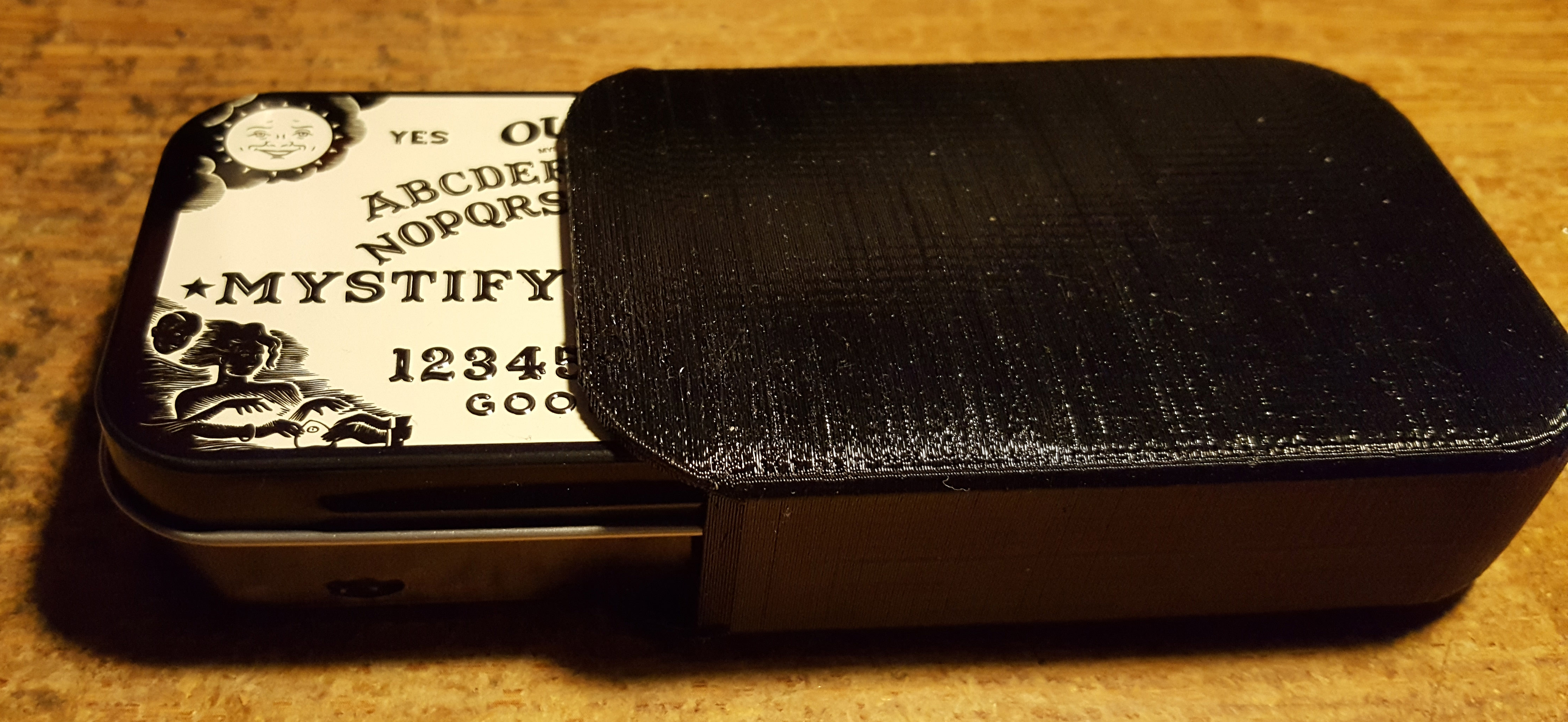

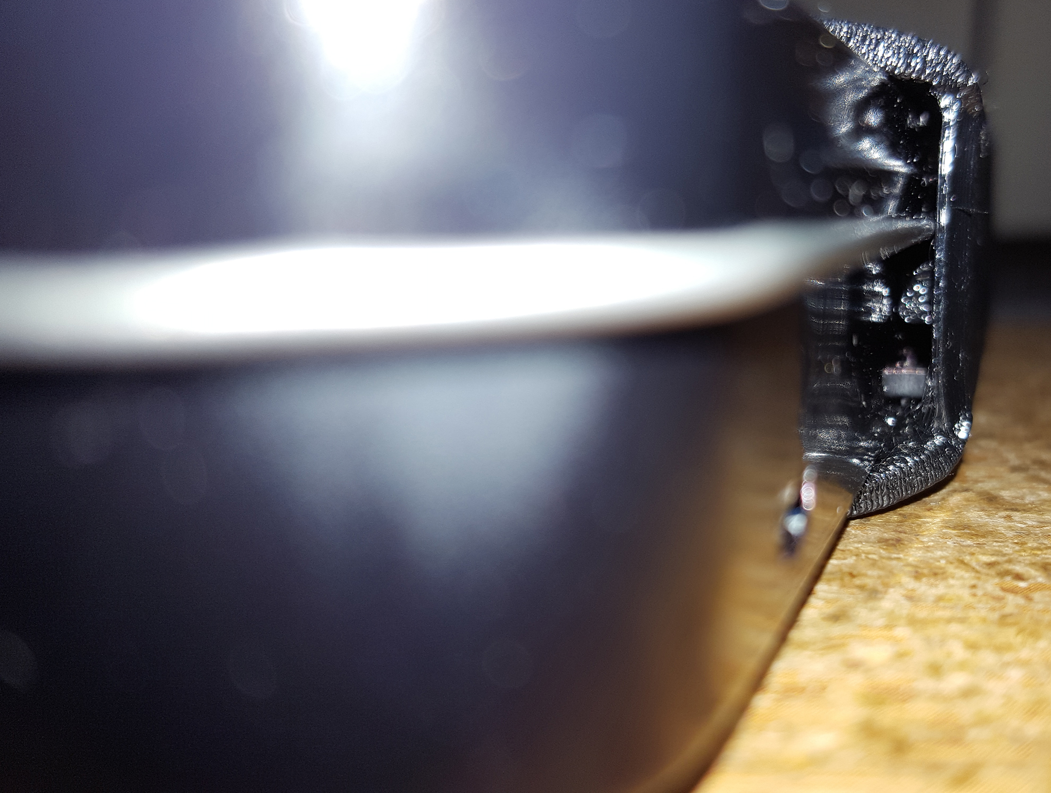

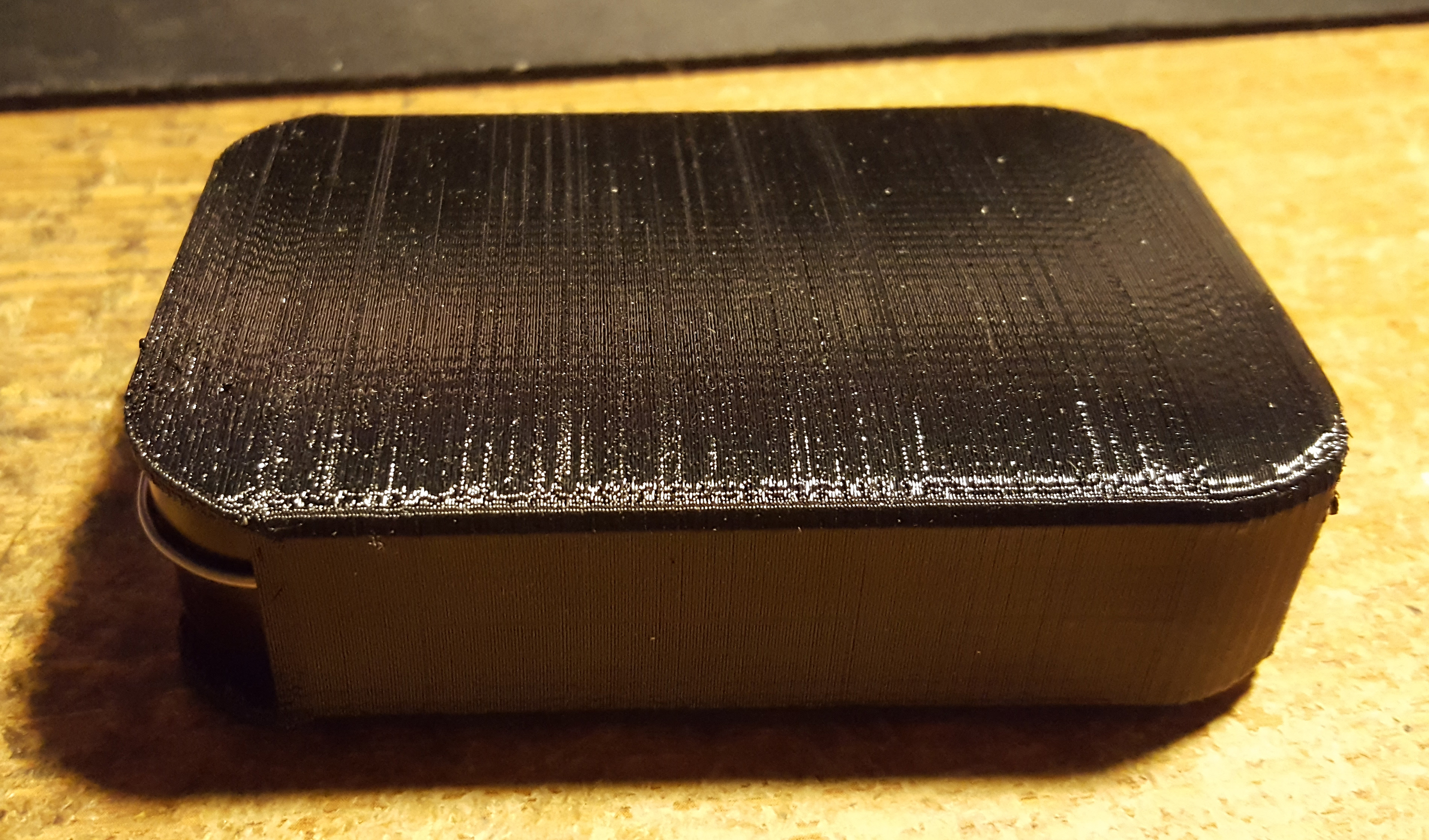

Speaking of saving the Spooky Pi, I had Wermy whip up a custom protective sleeve for my build. If you're going to go thru all the time, effort, and cost to build one of these beauties, you should definitely protect it from loose change and keys!
There's another problem, the top of the case is way deeper than a standard altoids tin. The lip comes about halfway down the case. The regular transparent case that Wermy designed and sells http://market.sudomod.com/mintypi-protective-sleeve/ wouldn't work in this instance. The groove needed to be moved to make room for the top half of the case. Lucky for me, Wermy was on the case!
sleeve insideShow
custom sleeve inside.jpg (3.24 MiB) Viewed 7374 times
This next pic shows how the groove sits below the top half, but above the power switch and charge port.
side shotShow
offset groove.jpg (1.64 MiB) Viewed 7374 times
Here's a pic from above.
Nice!Show
sliding in to a custom sleeve.jpg (1.25 MiB) Viewed 7374 times
And of course, it all nice and cozy.
Protected in it's new sleeveShow
