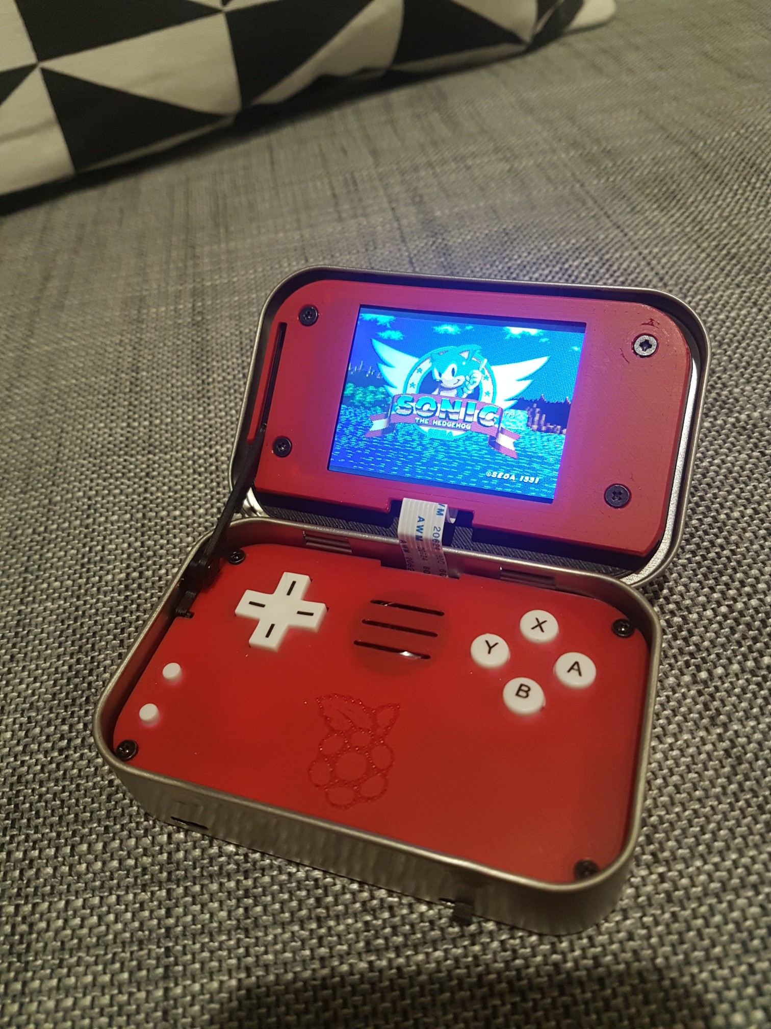

Re: LPs mintyPi [COMPLETE]
All I want to do is play it now but the battery is low....knew i should have added those diodes as advised by Helder...
Maybe in due course.
- 20170728_003355-1512x2016.jpg (712.4 KiB) Viewed 9856 times

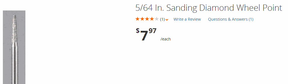

I'm going to pick up one of these diamond sanding bits after work. 5/64 of an inch is super tiny and should be perfect for precise cuts for power and the switch:
Edit: the bit measures 1.9mm.
I would actually suggest going with a larger diameter bit. Something more like this:
https://ae01.alicdn.com/kf/HTB1L1b_FVXX ... b-font.jpg
(again, not specifically that one. it's just the first image result with vaguely the right shape)
It will let you use it more like a drill bit - push it against the tin until your hole is the right size - which will give a cleaner, smoother hole. Kind of like the step drill for drilling out the GBZ button holes. Using a smaller bit, like the 1.9mm, you can't drill the full hole, so you'll have to 'trace' around to get your circle, and it won't be perfectly round.
Your bit will work okay for the slots, but it's less suited for the button holes.
