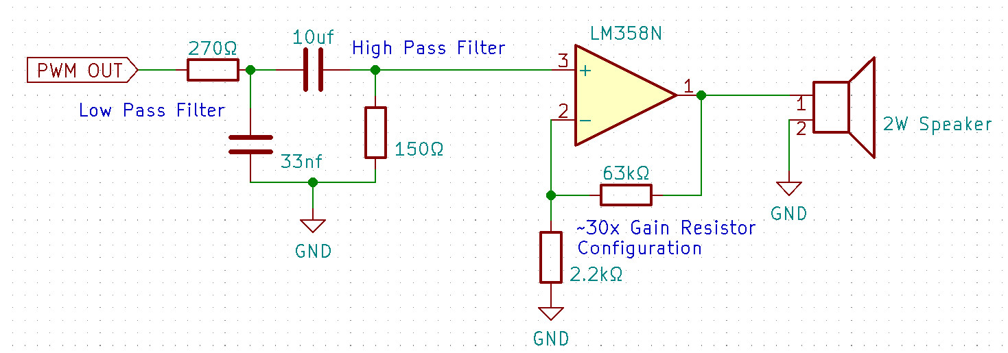

Here's the PWM audio circuit I used. It includes a Low pass and a High pass filter.
Screenshot from 2022-03-30 19-54-42.jpg (149.77 KiB) Viewed 71741 times
Those resistors result in just about 2W of output power from the OpAmp, If you're using a different speaker, calculate the resistor values with this formula:
Note: R2 is the 63k resistor and R1 is the 2.2k resistor.
The RPI outputs pwm at 3.3v 20mA, so at about 66mW. So:
Gain = Speaker_Wattage*1000/66
Then to get the resistors:
Gain = 1 + (R2/R1)
It helps if you assume R1 is 1k, then just figure out what value R2 should be.
In my circuit, I used resistors I had in hand, so that's why I didn't use 1k.
