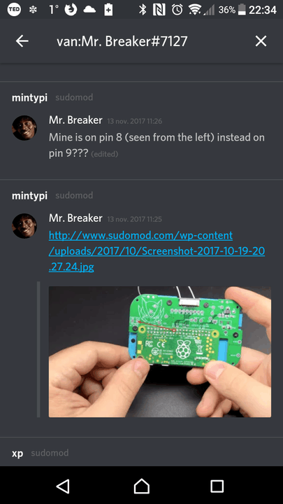

The only issue I encountered was a wrong pin label:
But this didn't cause an issue because it should be on pin 8 instead of on pin 9 (at least... my MintyPi is functioning perfectly) and pin 8 is confirmed by others.
