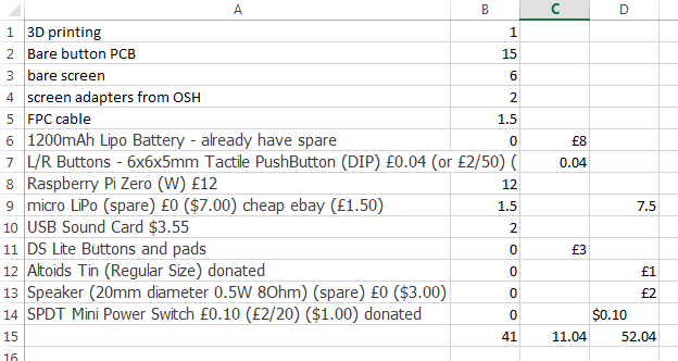

I totally believe this this costing as it's a very similar overall costing to mine! I'm using mainly salvaged and spare parts and DIY'ing certain elements...Holydohnut wrote: ↑Sun Aug 27, 2017 3:52 pmAm I missing anything? Genuine question Coz I still can't quite believe it myself! It could be even cheaper too! If I had more patience, I could probably get the most expensive item, (The battery) cheaper from China. The one I listed is UK based. And the charging boards could be bought in bulk for a little over 50p a piece! (cost above is just for one.)
my most expensive parts have been the Pi zero W and helder's prototype button PCB. I'm using some screen adapters by MoosePR and everything else is either spare or salvaged.
Column B is what I've specifically bought for this project (in £) column C is stuff i already had as spares and D is the cost if i'd paid the proper price for it (like using an adafruit micro lipo instead of a cheap Chinese charging board) (row 15 is totals of B and C, not D)
I didn't see anything for connecting the screen to the pi, or is the screen one with a PCB?

Re: The sub £30 mintypi?!?
Yep. Not sure yet whether I'm chopping the board, or desoldering the sdcard holder. I'd like to go with the latter coz I have a couple of ideas for other projects where that could be useful...
