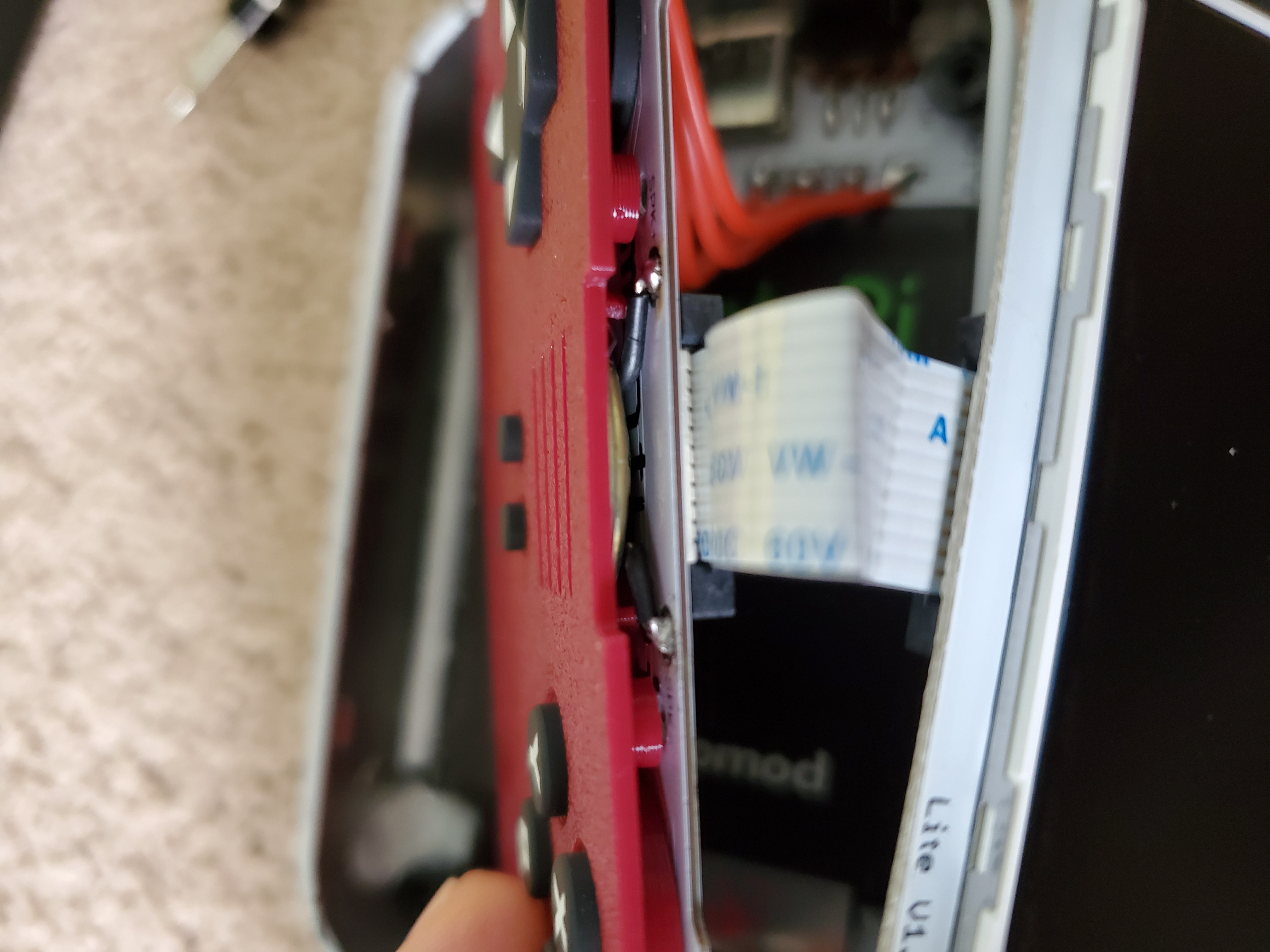

My first go around my right and down button on my dpad werent working every time and it was because the speaker wires I put on were preventing the 3d printer park from sitting flush. I had to make the wires longer by a hair so that I could curve them around the part where the 3d printed part encloses the speaker. Hopefully my picture helps explain what Im saying. Make sure the wires aren't making it bulge and have only the necessary amount of solder in that area you may have your desired results. Hope I helped.
