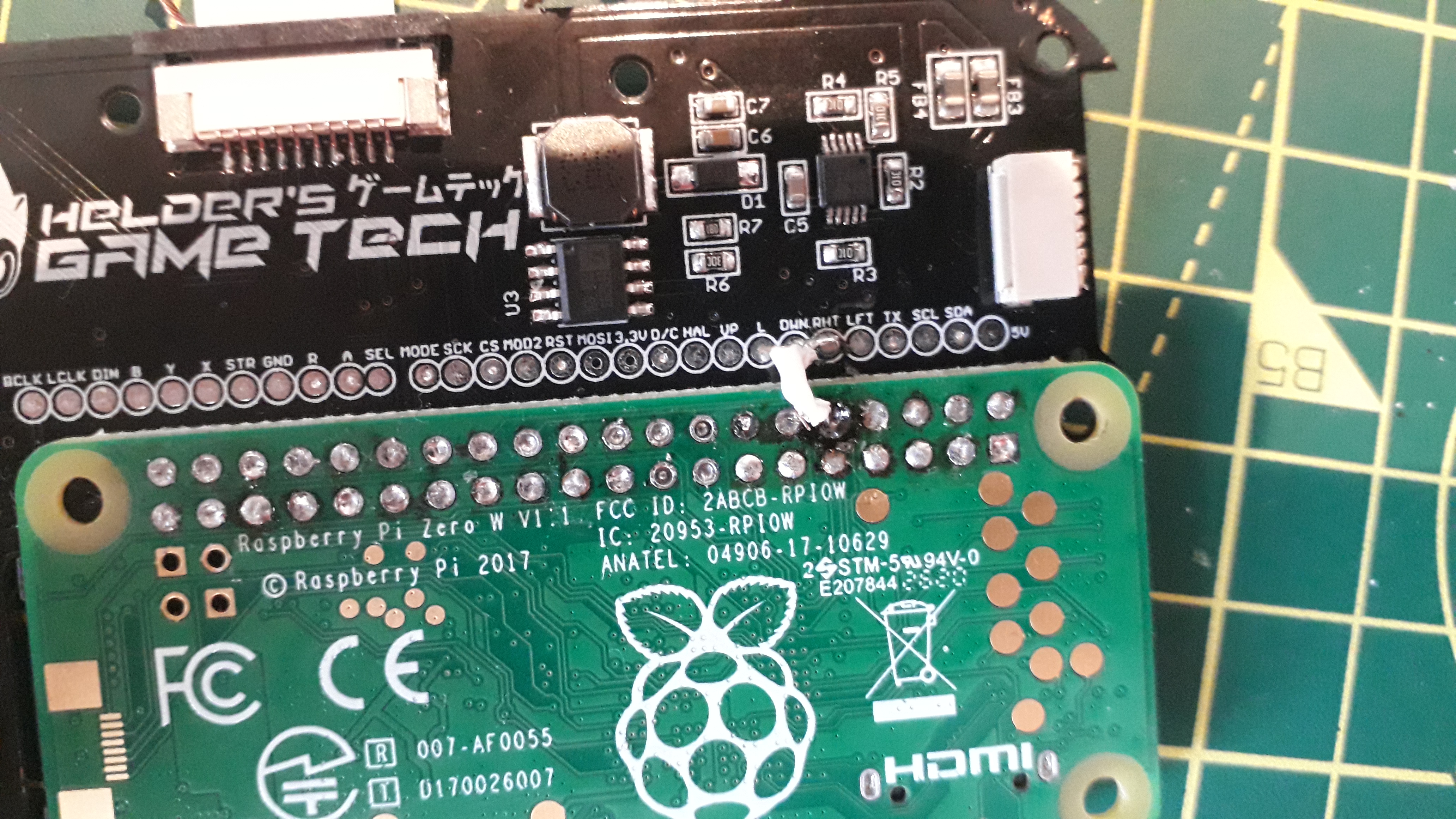

I'm building version 3.5 of the mintypi, however the right dpad is completely unresponsive.
1. I've completed soldering the button PCB to the PI.
2. I've tested the connections with a multi meter. All the connections worked with the exception of the right dpad connection. I added a jumper wire from the PI to the PCB as advised in the build guide.
3. I've connected the screen and speaker. Everything works as best I can tell apart from the right dpad key. The right dpad key is
4. I believe I may have overheated the right dpad connection. I have also checked if I have shorted a connection to ground, which I do not believe that I have.
5. I've attached a photo in case that helps.
6. I am unsure of what I should do next, but thanks for the advice.
