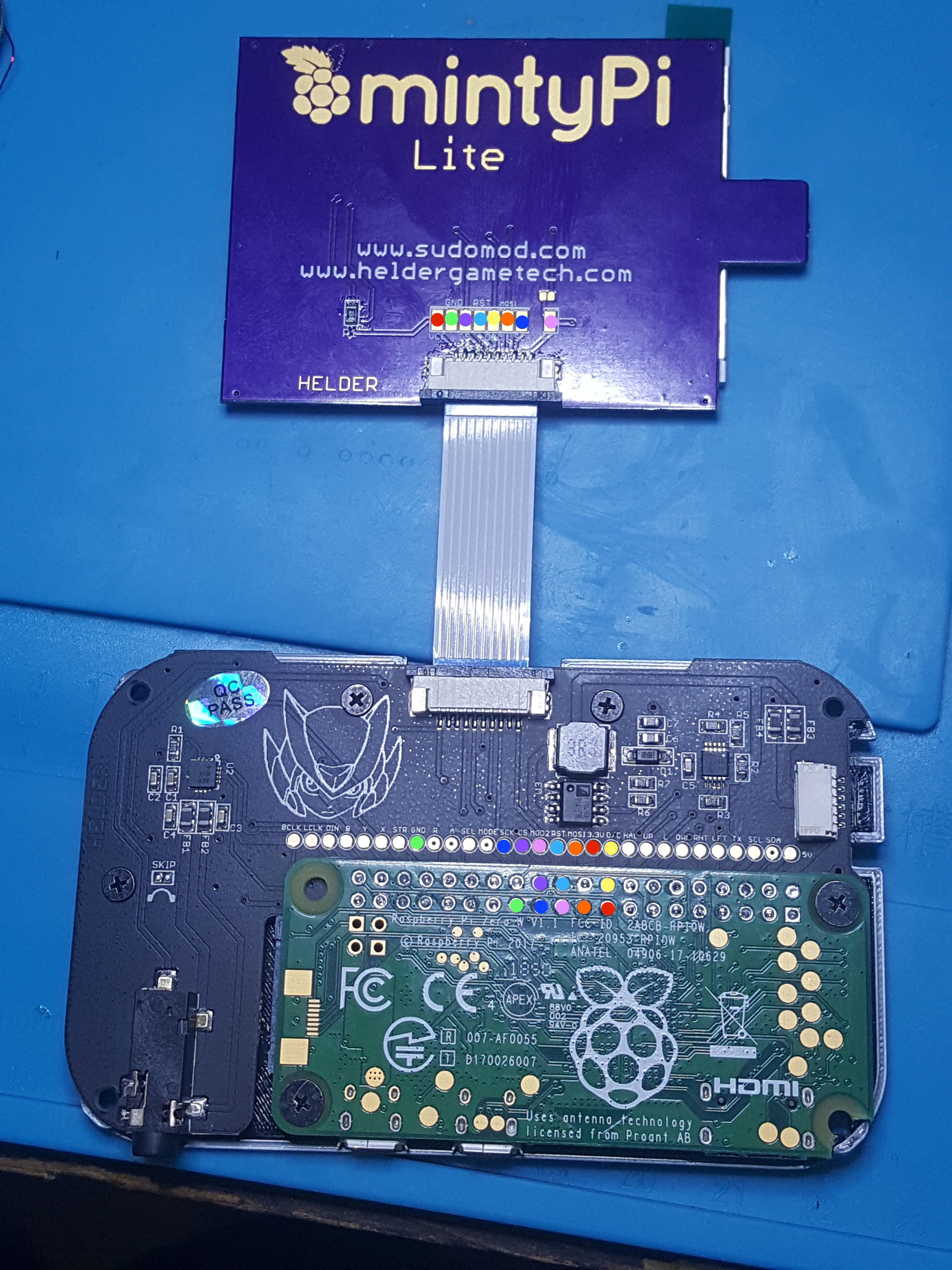

Yup the laptop charger likely killed the charging chip or some other parts but best way to know is to plus a usb-c cable into something like a usb port of a computer and see if the lights come on to show it's charging the battery.
You can also test the voltage of the battery to see if it has a charge or it might have gotten damaged too and the the PI should still work if you power it directly through the micro usb on it and if you give it enough time to boot it should be working.
If it does not come on test continuity from the Pi to the LCD using this image below.

I tried out all of your suggestions and here are my results:
1. I plugged the USB-C cable into a computer and I can confirm that the light was turning on to indicate that the battery was charging
2. I checked the voltage on the battery and received between 8.0 - 8.4 volts each time
3. I checked the continuity test on the pi to the screen and everything checks out
The only thing that wasn't going to plan was plugging the micro usb into the pi. I plugged in the cable and waited for more than 20 minutes hoping for the pi to boot, but I ended up with the the same result.

That battery reading is so wrong that you are either not using the multimeter properly or somehow you doubled the voltage output of the battery which is impossible.
Other than that and you not showing us any pictures of your soldering can't suggest anything else other than the soldering could be bad and you are using the multimeter wrong which leads me to believe if your continuity checks are even accurate.

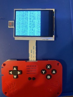

White Screen
Good afternoon,
Im almost done with my build. But Im having troubles with my screen. I checked the soldering it was good...the connection is good... What else should I try?
- Pi Screen.jpeg (53.35 KiB) Viewed 7383 times
- Helder
- Trailblazer
- Posts: 2985
- Location: Rogers, AR
- Has thanked: 1459 times
- Been thanked: 3114 times
Re: White Screen and no boot (dead pi?)
Looks like the wrong image on there, are you using the mintyPi Lite image? and not the V3 image?the Links to the right software are on the video guide's description.

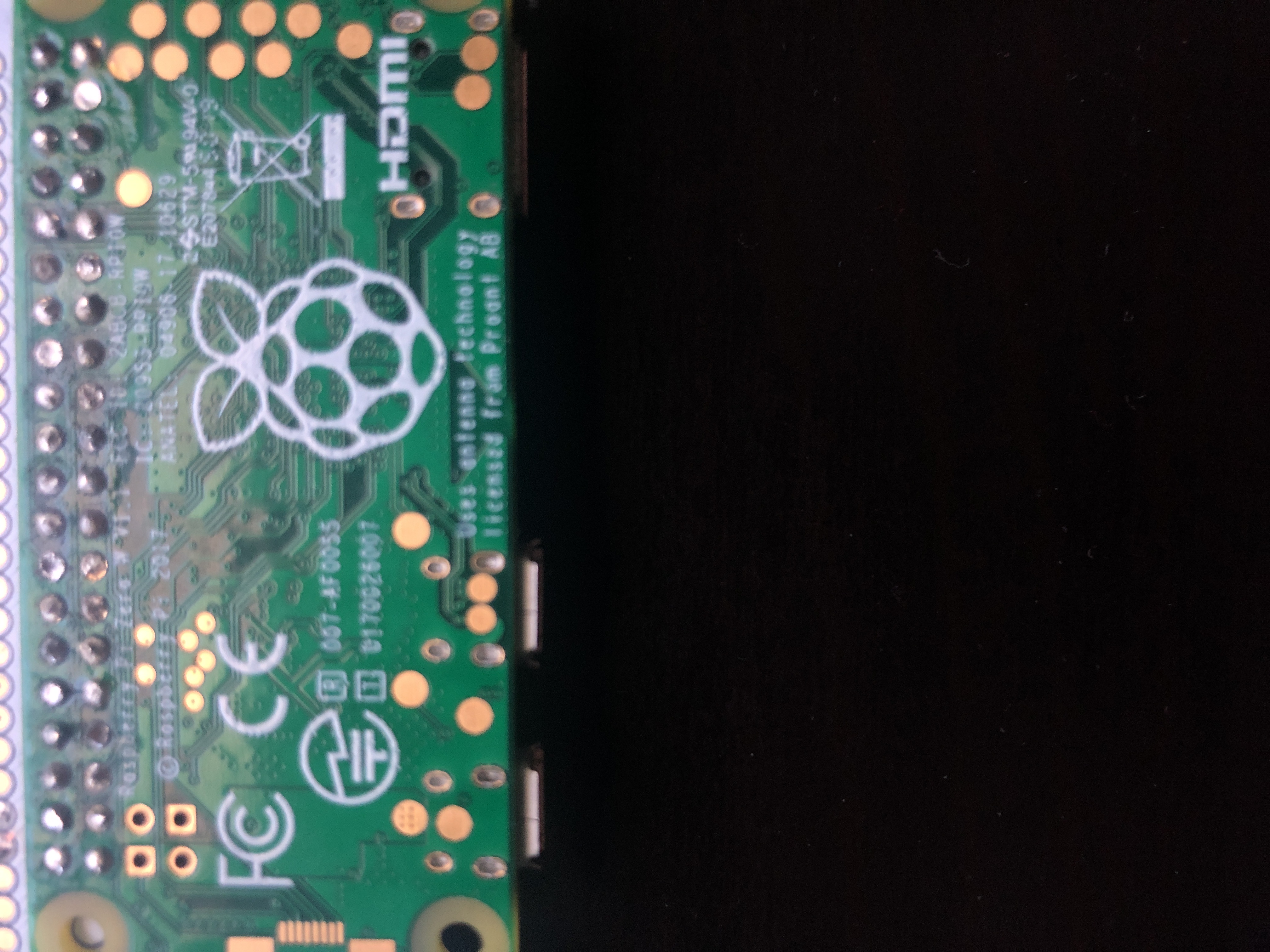

Below I have an attachment of the GPIO pins:
You were right with the voltage, I accidentally wrote 8 volts when it should have been around 3.4 v for the battery. Also, I did read up on continuity again to make sure I was doing it right. After finishing up the continuity test, it wasn’t doing anything, leading me to believe the pi itself probably died. Though unfortunate, I did have fun while it lasted. Thanks once again for your effort, support, and advice!
