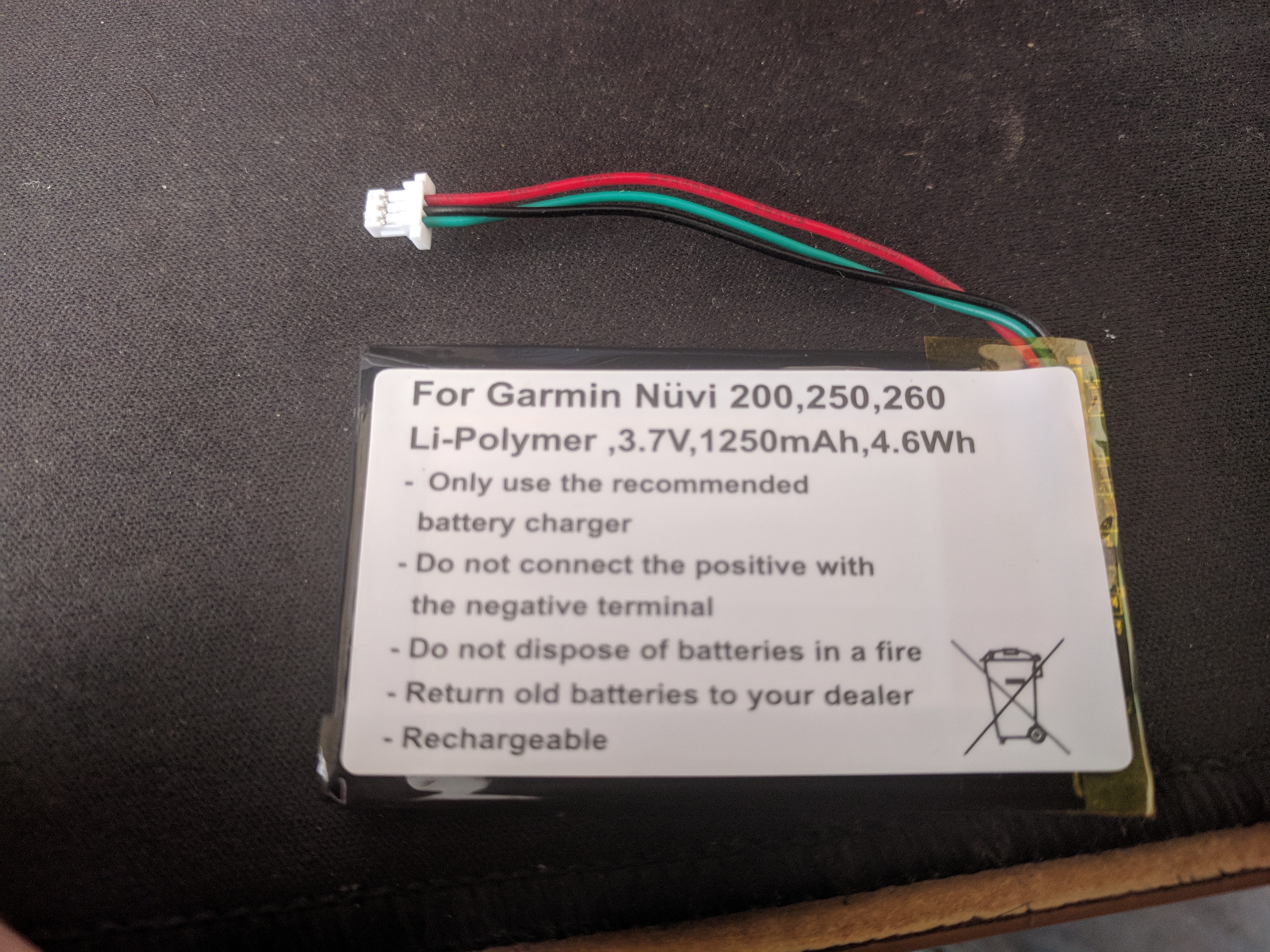

-> should fit (60mm x 36mm x 5mm), 1250mAh but not sure, what the yellow cable is doing and what it will be doing, if I just ignore it, using only the red and black one.

I used similar to the second one. It's for Garmin navigation devices. It's a tight fit, but fits. Plus it's a bonus that I can buy those in local electronics shop. And yes, you just ignore that green wire (in my case). I securely taped it to the side of the battery and used only red and black.
