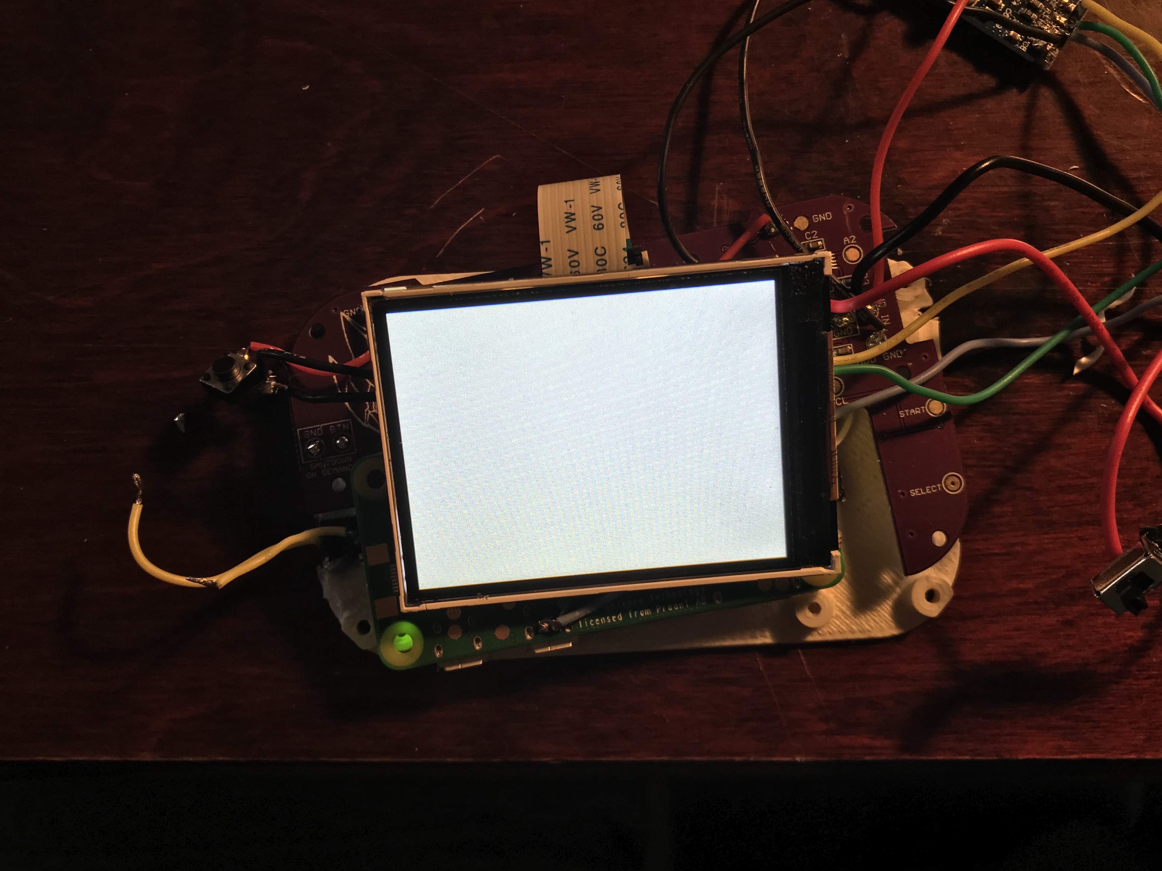

Everything was working perfectly. I did some tests before putting it in the tin and everything worked fine. I was able to navigate the menus and i had picture and sound.
I had trouble putting the screen in the 3d parts, my printer at school printed the pieces a little small. i finally got everything to fit but once i turned it on now i only get a white screen but i still get sound. im worried i broke the screen and i'm wondering if there is anything i should be looking at to troubleshoot this.
Screen is White but there is sound

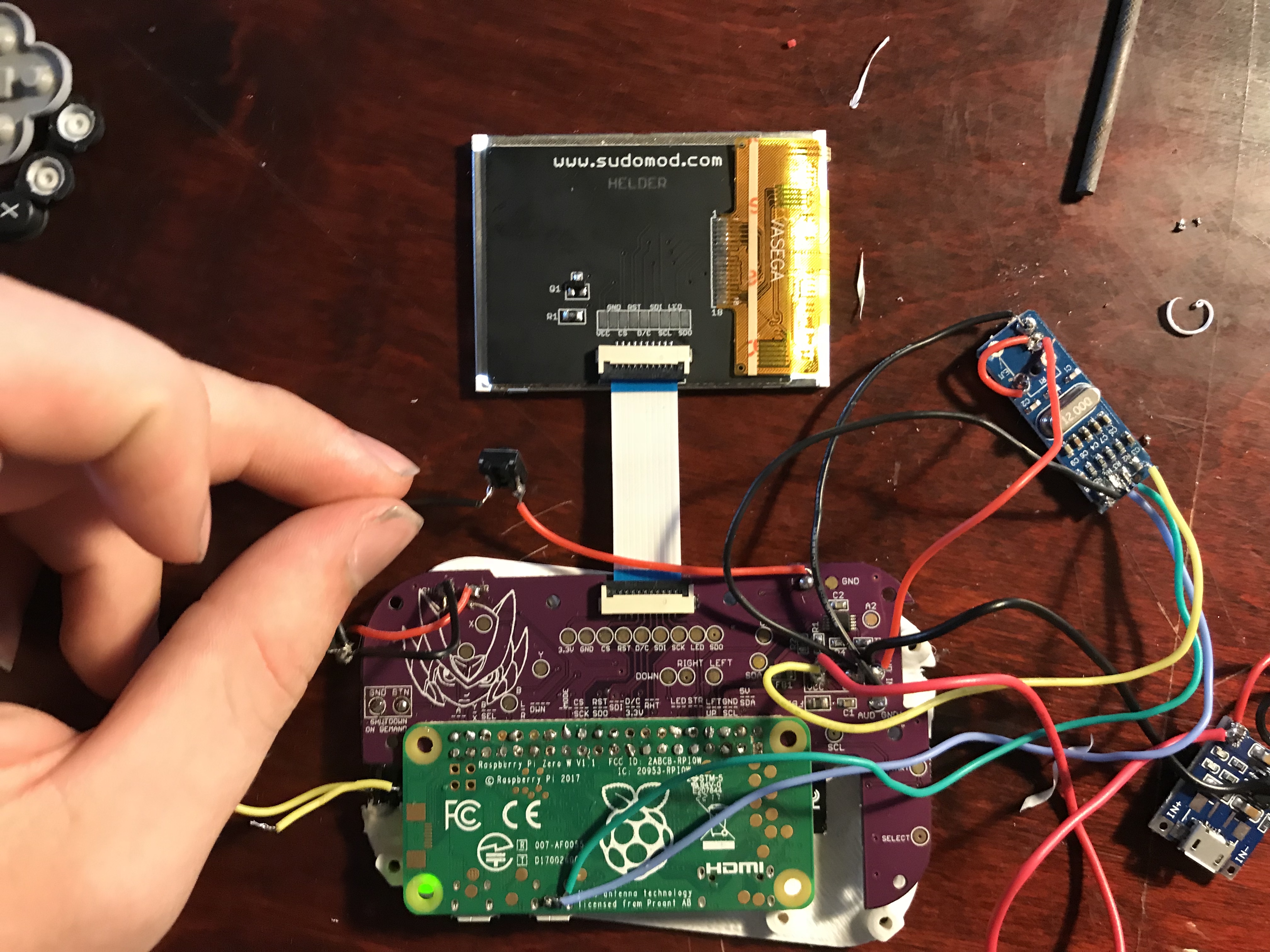

where should i be looking to find those issues. i tested the pads on the back of the LCD and all the connections are reading fine.Lphillimore wrote: ↑Mon Aug 13, 2018 11:17 pmVery common issue.

Try reflowing the gpio on the pi and adding about more solder, those connections look a little low on solder.
