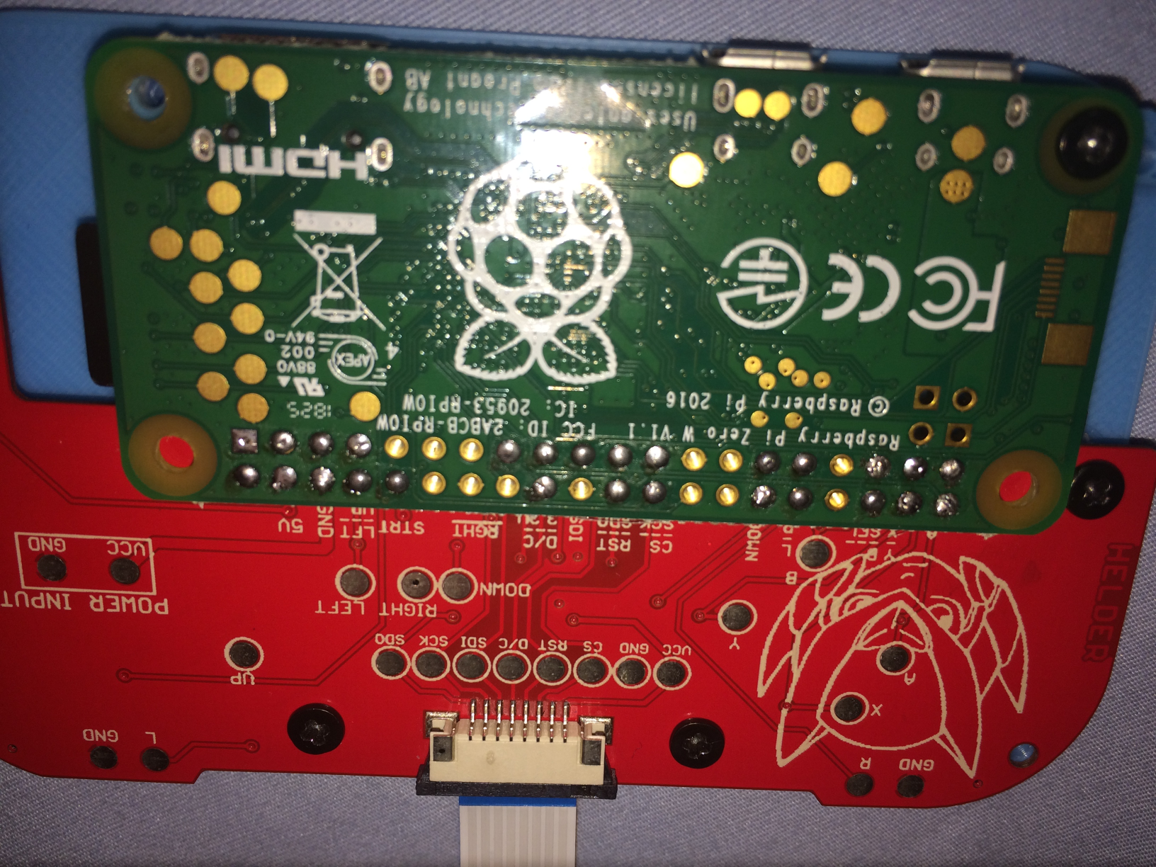

Post by Whoeverhitme » Fri Mar 29, 2019 1:22 pm
here is the photo , sorry to keep you waiting :|
here it Is also if the soldering job is bad BLAME IT ON MY FRIEND

Post by Helder » Sat Mar 30, 2019 2:02 pm
You have a multimeter? You'll need one to test continuity to be sure the soldering is solid which sounds like it's not.
Great example is the Right direction isn't even soldered in your picture, just looking good doesn't mean it's actually solid.
