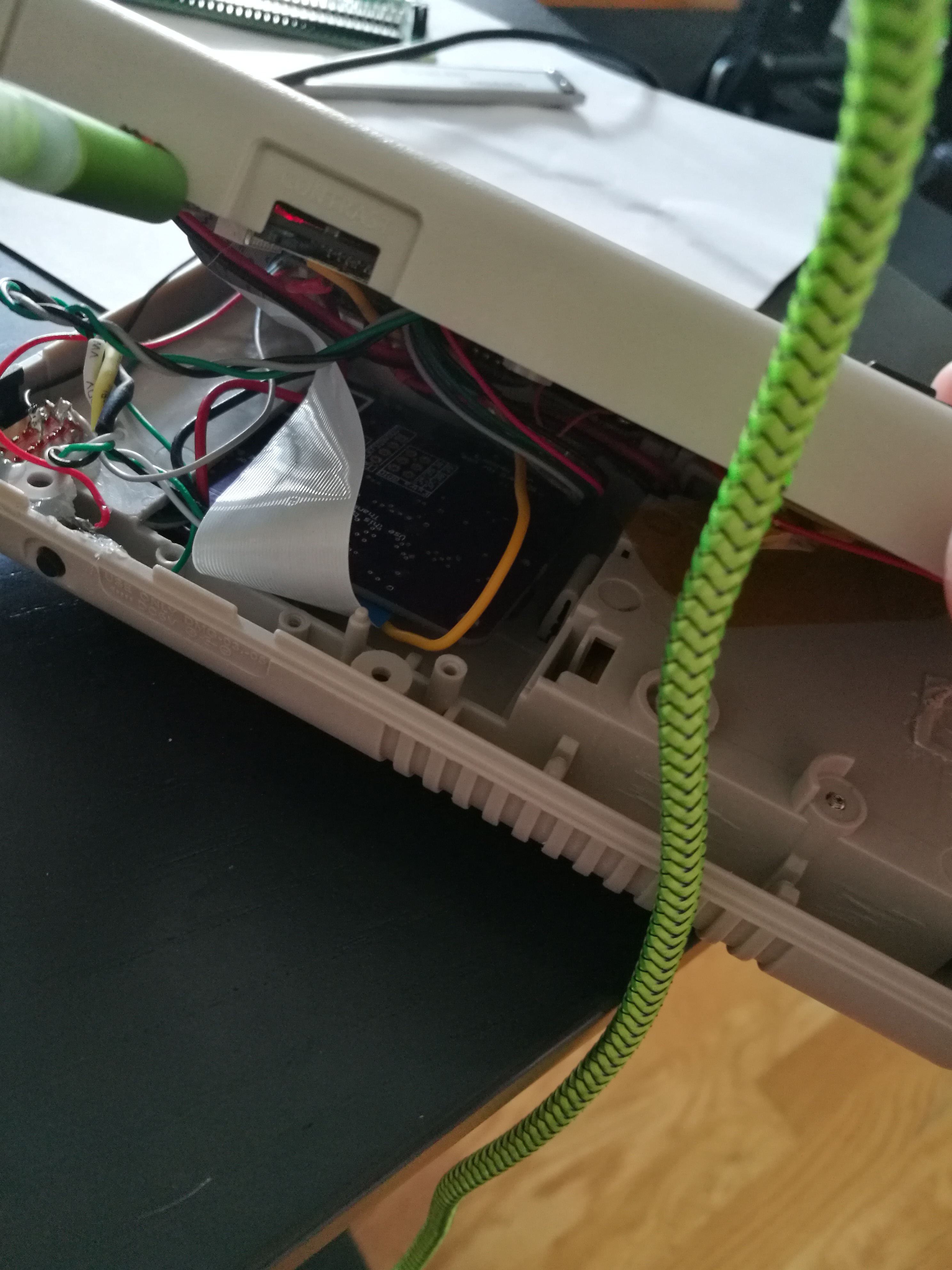

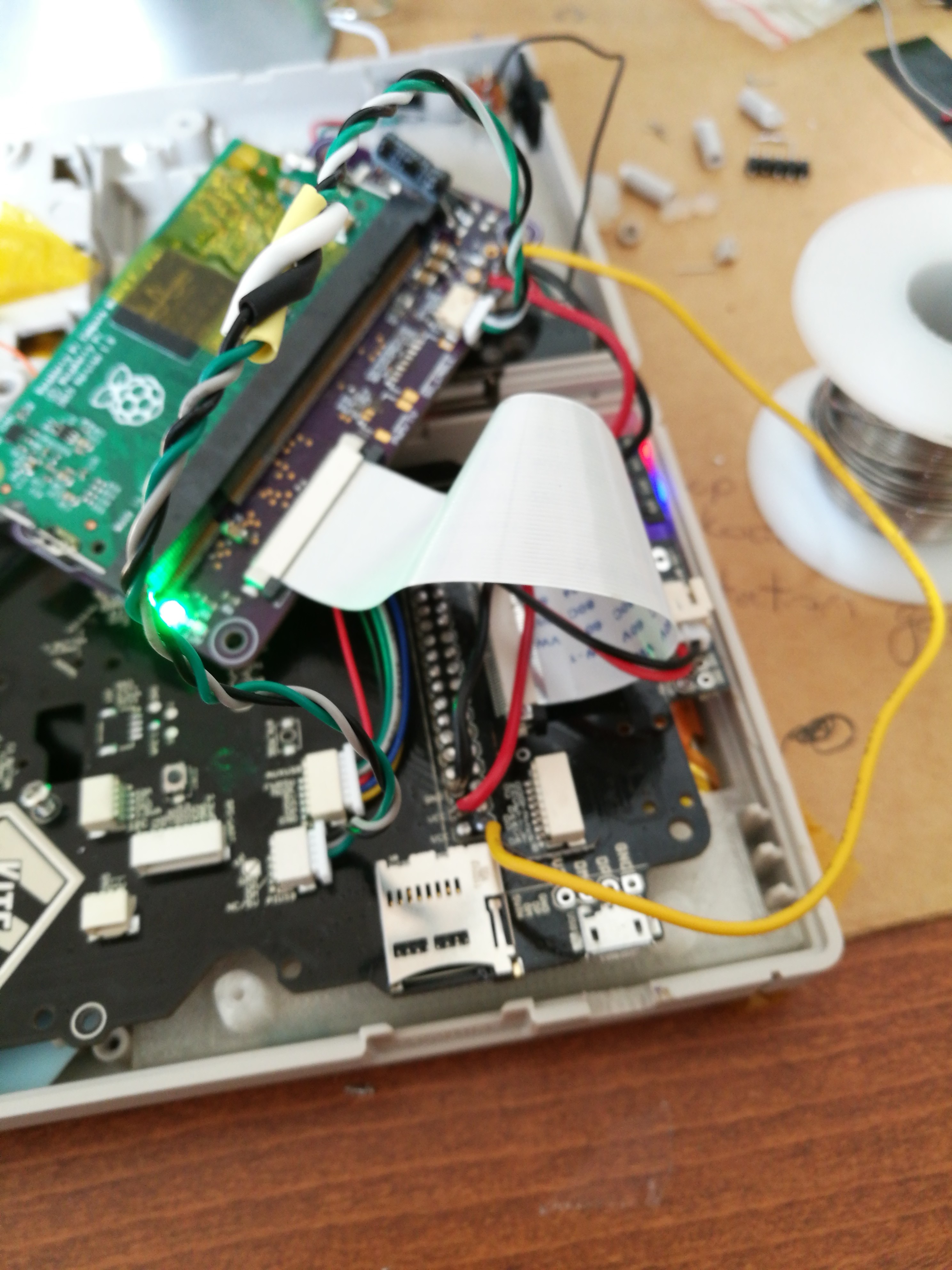

The last two days I've been working a lot on this USB issue.
What I found is that the USB functions when I plug my CeMu into a Pi3, and the SAIO Arduino works over usb intermittently when connected to the Pi3 as well. (one fail followed by a pass before I re-soldered connections and tried it back on the GBZ build again).
That means they are both functioning seemingly fine. The issue is occurring when I connect the two together.
Kite says the 5v is NC and that it's not used/necessary and recommends removing it. I've done so, as well as twisted the wires like he suggests in a Pi3 build photo on his wiki.
I've tried switching from the 3v power I had originally to 5v. This meant adding a 3v line to the CeMu in addition to the 5v and GND I already had. I also unsoldered my 3v regulator because I was getting 3v from the SAIO.
I've tried distancing the USB wires from power lines and shielding them from the other wires using conductive fabric.
Nothing is shorted to ground or each other. I have continuity from the SAIO USB JST connector pins to the SODIMM pins on the CeMu.
I've probed DP and DM and DP is logic high and DM is logic low. I see a constant high and low, so flashing or pulses. That seems a little funny to me, but don't know what to do about it.
I tried an oscilloscope, but don't really know how to operate mine or what to make of it. It seems as if DP brings the line up higher, and DM doesn't effect it. I only have a single channel so I cannot measure them against each other.
I considered carefully desoldering my Pi3 adapter and trying to solder a Pi0 on to double check that there's nothing weird about the SAIO and confirm everything is fine, but that would likely break things and it would be even harder to desolder the Pi0 to put the CeMu back on to test.
I'm sitting on these facts for a while before I try to think about what to do next. It's really rather frustrating to be honest.
inches
Posts: 103
Has thanked: 32 times
Been thanked: 81 times
Re: [Pre-Order] Sign-ups for the CeMu Partner (Compute Module add-on)
Post by inches » Mon Jun 26, 2017 6:29 pm
Success! So, it turned out to be a software thing I'm pretty sure. I flashed the SAIO Arduino with the latest .INO (https://github.com/geebles/Super-AIO/bl ... IO_v2a.ino) and now it's all gravy.

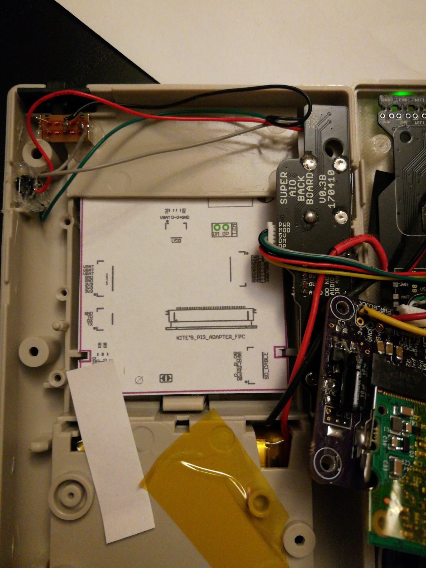

On another note:
That's the CeMu in a new orientation. Seeing this I thought I'd try to cut off the whole board ledge beyond the SODIMM slot. I thought I'd place those components on part of the board I'd increase the size of.
That naturally led into thinking deeper about placement and board layout. If I change anything like the above it's not that much of a stretch to change it all up.
I am toying with the idea of reformatting the board itself to fit within the cart bay rather than above it. It's pretty squished now with empty space that could be used instead.
It might take one or two more iterations, but the benefits of cleaner wires inside are too beneficial to release the current board as it is. Plus there were a few other things I needed to change anyway.
The biggest problem with this is rerouting the FPC cable. It's quite a pain in the pa-toot to route that many lines to such a small space. It's also expensive and very tedious to prototype with SODIMM slots. Anyway, this is what I think is best.
I didn't route power to the SD bank anyway, so I was already going to need more prototypes.

So I think I've been able to route the new board update all in one day. I must have learned something last time I did it. Plus, Kite's been quite helpful. ^_^
The print was a bit off on the scale, but it will fit snugly in the slots. The CM will be facing the back of the case where you'll be able to drill/cut any kind of vent you'd like. I currently have two screws to affix the CeMu Partner at the top right near the WiFi. You'll have to add a screw hole to the cart bay if you'd like to secure it firmly. Otherwise I suspect it'll be just fine sitting by itself.
The other side of the board (facing up/in towards the case's inside) will have all the connectors. I decided to go full monty on the connections and switch everything to JST SH cables. All the wires I had on hand were so stiff that I didn't like working with them in the prototype. The wires on the JST cables will be much nicer to work with.
Here's the I/O the CeMu Partner has today-
Power:
VBAT x 3 (5v typically)
GND x 2
3V3 x 3
Helder I/O:
GND
TV
RX
TX
Secret interface...
SD Card:
GND
CMD
CD
DET
D2
D1
CLK
D0
GPIO Extras:
PWM_1
PWM_0
GPIO 39
GPIO 38
GPIO 37
GPIO 36
GPIO 35
GPIO 34
USB JST - for connecting to Helder's/Kite's board
USB Mini - for programming EMMC
RTL8188EUS footprint
RTL8188EUS USB D+
RTL8188EUS USB D-
Additionally, I did some unscientific tests on the battery and temperature today. I ran the standard CeMu+Kite build today for over 11 hours running the Sonic the Hedgehog opening intro video over and over. The brightness was on high and the sound was quite loud. I did not have WiFi on. The temperature got up to 55C laying flat on my bed, but when raised up held a steady 50C. Kite doesn't have the auto-shutdown script running in his image quite yet, so I stopped the test at 3.36v. I suspect I could have ran an additional hour or so until the 3.2v cutoff.

Hey, just a thought / note regarding your latest placement... If you pick up HoolyHoo's AIO bracket for Kite's SAIO Board (http://www.sudomod.com/forum/viewtopic.php?f=27&t=2553) then we have an issue with proposed location (per the drawing above) :-)
terrapinlogo
Posts: 7
Joined: Tue Jun 06, 2017 5:19 am
Post by terrapinlogo » Thu Jun 29, 2017 9:22 pm
clonemypi wrote:
Thu Jun 29, 2017 8:47 pm
I don't see how it would be an issue? The CeMu is in the cart bay while Holyhoo's bracket is behind the screen? It looks like inches is using one of Holyhoo's brackets in his latest post (Top right corner of the picture).
