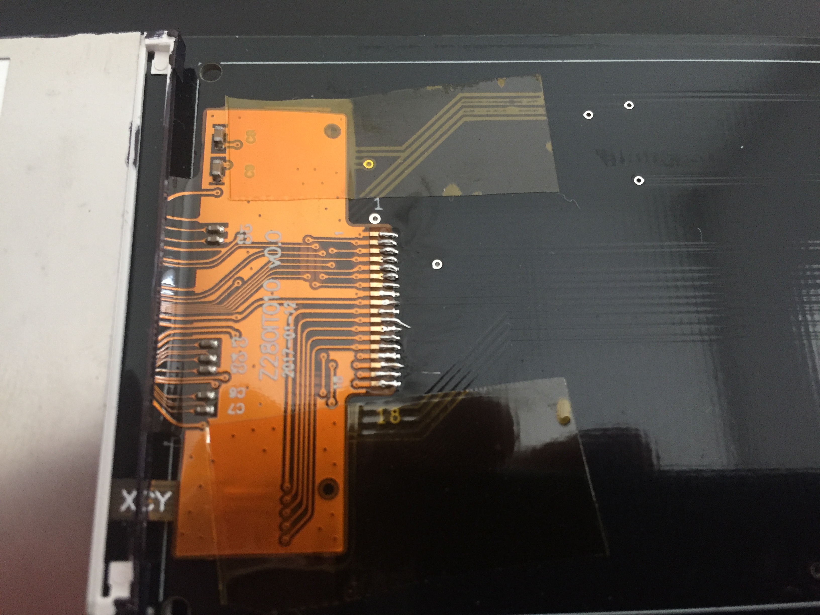

Ampersand I just purchased this and am super pumped to start building, but i have one question. When soldering the screen to the board can I run one continuous line of solder or do I have to solder each individual connection. Thanks for any help!! Cant wait to get this bad boy up and running!

The pins have to be soldered individually, it's not hard though, take your time and keep it clean.
It doesn't need to be that neat since you won't see it under the screen, here's a pic:
