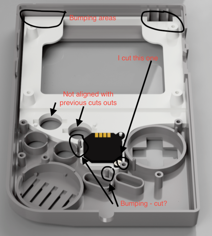

Hi HoolyHoo,
This is my second bracket. I initially started with the standard SAIO bracket in GBZ shell, but upgraded to the new one for the Circuit Sword. Having a few issues with overall fit as compared to backet rev 1. Pics for reference. Suggestions?
Re: [For Sale]HoolyHoo's AIO bracket for Kite's SAIO Board
Post by YaYa » Thu Feb 15, 2018 12:26 pm
the problem is obviously your shell... i had the same issue with brackets printed by the same hub i always used but this time, the upper right and upper left corners are bumping too... i have designed also some small parts and they needed to be trimmed down to sit down on the case.
what changed before after ? the case supplier lol
What you can do for the upper side, chamfer the front of the bracket slightly at the corners so it can sit down :D worked like a charm for me not later than yesterday lol
Post by dryja123 » Thu Feb 15, 2018 1:02 pm
The SNES and Joystick X and Y button holes are not cut in the same position, the joystick x and y buttons are a more true to real Super Nintendo spec. If you're using a case that was cut for the SNES style bracket your buttons will be a little off set with the joystick bracket.
You're spot on about the bracket bumping into the case though. It's either a variation in the case or a variation in the bracket. I can confirm that the joystick bracket does fit a little more snug than the SNES one.
Post by HoolyHoo » Thu Feb 15, 2018 1:14 pm
exodus wrote:
Thu Feb 15, 2018 12:18 pm
Hi HoolyHoo,
Hi, as YaYa suggested, there is no way for me to account on some aftermarket case dimensions. I can tell you that I have designed and tested the bracket around the dimensions of the original GB shell. I have also verified it with two different aftermarket shells however, as you may know, there are many suppliers of those aftermarket cases.
That being said, it should be easy enough to sand by hand or very carefully, lightly dremel those areas to get the fit in your case. The one area that you mentioned, the X and Y holes, you should not have issues with if you used the provided drill guides to make the holes as those should be made according to where the bracket rest. Do not use Kite's drill guide on his board as they may lead to out of alignment of the X and Y holes in relation to the bracket. There is enough tolerance on the contact pads to allow for this without issue.
Hopefully you should be able to get that to work without issue. :)
