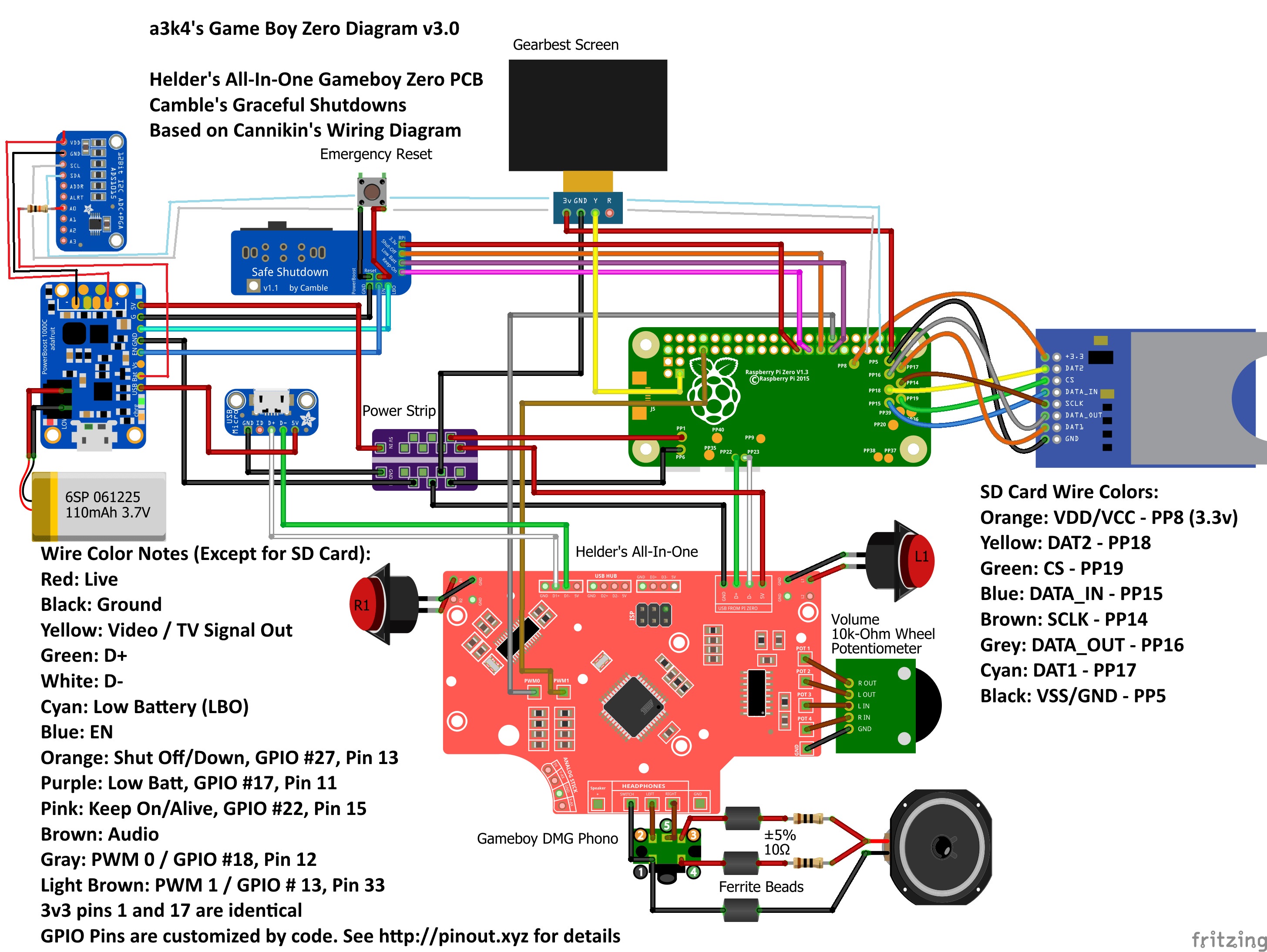

I think what Veteran is saying, is a way to simplify the below image. Merlin worked out a way to add an ads1105 with your Safe Shutdown board. That way he had batt monitoring and changed the script so the safe shutdown triggered with flipping the switch. I would also be interested in this as it nice to have that shutdown script on demand at the switch (not a separate button/combo of buttons). Ignoring all the other parts of this diagram (helder pcb, screen, sd card), something that incorporates the shutdown pcb, ads and powerboost like this:
