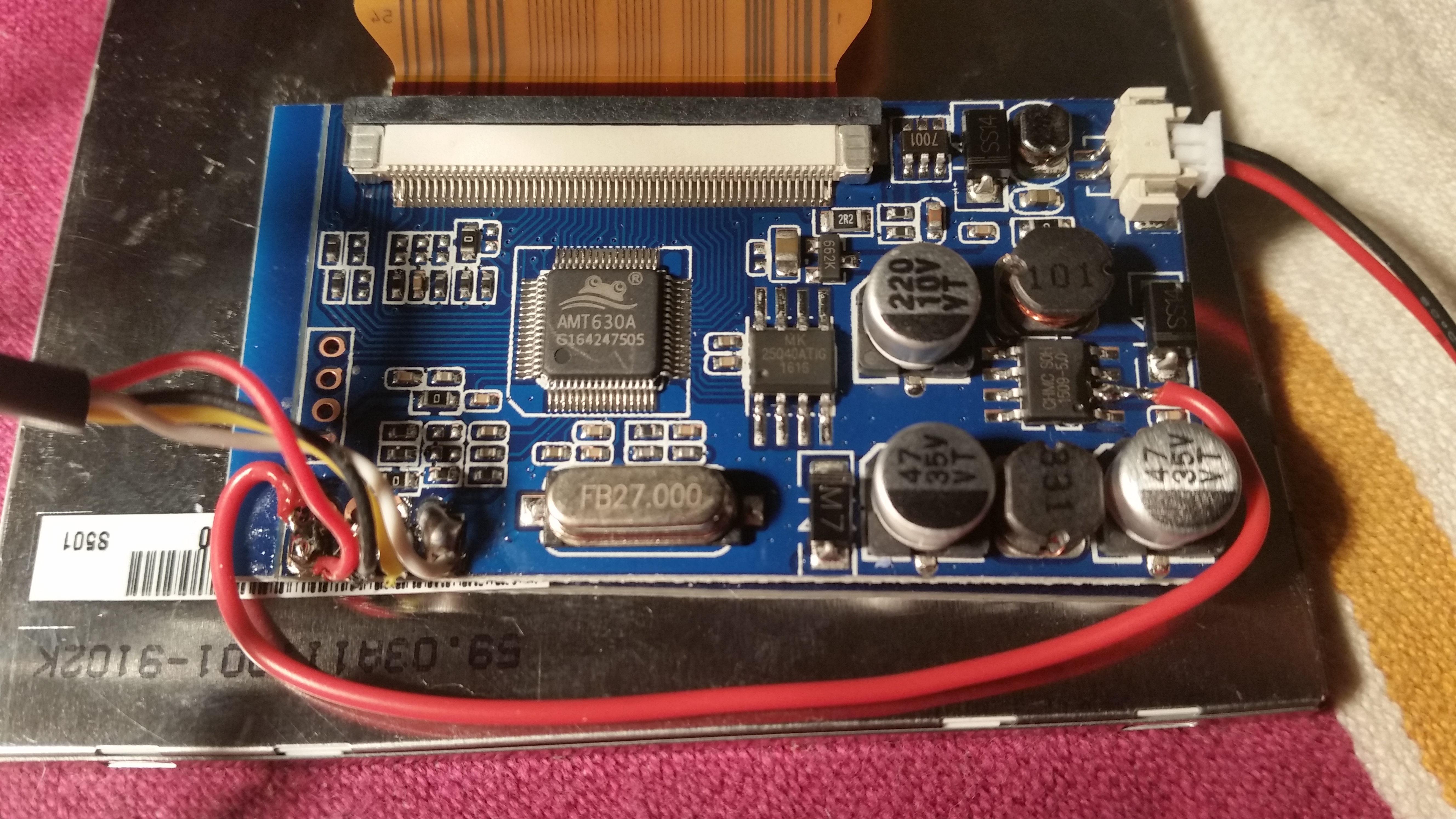

@Rog585
While, technically, the BW7 display works without modifications, my experience was that it had very noticeable flickering when used that way. I'd really recommend soldering a jumper wire like so:

RxBrad wrote:@Rog585
So I just snip the current attachment and solder the wire to the board? Also where are the connections on the pi zero? Do you have a image of that. I appreciate you help!
Sorry just seen that I solder to the chip I don't need to cut the connection.

Post by RxBrad » Tue Aug 30, 2016 1:01 pm
@Rog585
Keep the red wire attached to the board as it is. The jumper wire is soldered onto the same solder point as the existing wire, and onto the pin shown on the IC.
This post shows a basic breakdown of the wiring that most people use.
Red and black go to the Powerboost.
Yellow goes to the "TV" through hole on the Pi0.
Many people use the white wire as the ground, and simply wire it to the through-hole next to the "TV" on the Pi0. The thing is, the white wire is technically the AV2 input wire for the screen. Others have simply snipped the white wire off and left it unused, and don't attach anything next to the "TV" through-hole (this is the ground wire for the TV input, BTW). I don't know the right way to do it, but apparently both ways work.
A third option that makes more sense to me is to completely remove the white wire, then solder it onto the same pad as the black wire on the screen PCB. Then solder the other end of the white wire to the through-hole next to "TV" on the Pi0. (If you tear apart the factory-attached cable for the screen, you'll see that this is how they handle grounding the AV inputs, assuming they don't have any special components hidden away in the joint where the red/white/yellow cables split off.)
Red and white go to the Powerboost.
Thank you for the help, I think I will go with you and do option 3. Final question what gauge wire is best to use for 1) the control connecions - dpad 2) general connections and 3) powered connections?

Post by RxBrad » Tue Aug 30, 2016 1:11 pm
Rog585 wrote:Thank you for the help, I think I will go with you and do option 3. Final question what gauge wire is best to use for 1) the control connecions - dpad 2) general connections and 3) powered connections?
Starting to get off-topic for this thread, but I used 30AWG for controls and stuff going into regular old GPIOs. I used 22-26AWG for powered/audio connections. Others will have different answers to this. Might want to start another thread (or see if one exists) if you want further info.
EDIT: Also note this I fixed an error in my original reply to you on which wires go to the Powerboost. It's red and black.

Post by Rog585 » Tue Aug 30, 2016 1:16 pm
That's perfect, you have been a great help and will give it a go, just to confirm for option 3 the white wire should go through the hole to the right of tv which is marked up as U3?

Post by RxBrad » Tue Aug 30, 2016 1:24 pm
Rog585 wrote: That's perfect, you have been a great help and will give it a go, just to confirm for option 3 the white wire should go through the hole to the right of tv which is marked up as U3?
Yup. On the Pi0, TV output and the ground for TV output have the little white box around them. (like you, I think the U3 refers to the ground pin, but the label is placed kind of funny, so it might technically refer to a component(s) under it).
Also, again note that I fixed my error on which wires go to the Powerboost: Red & Black

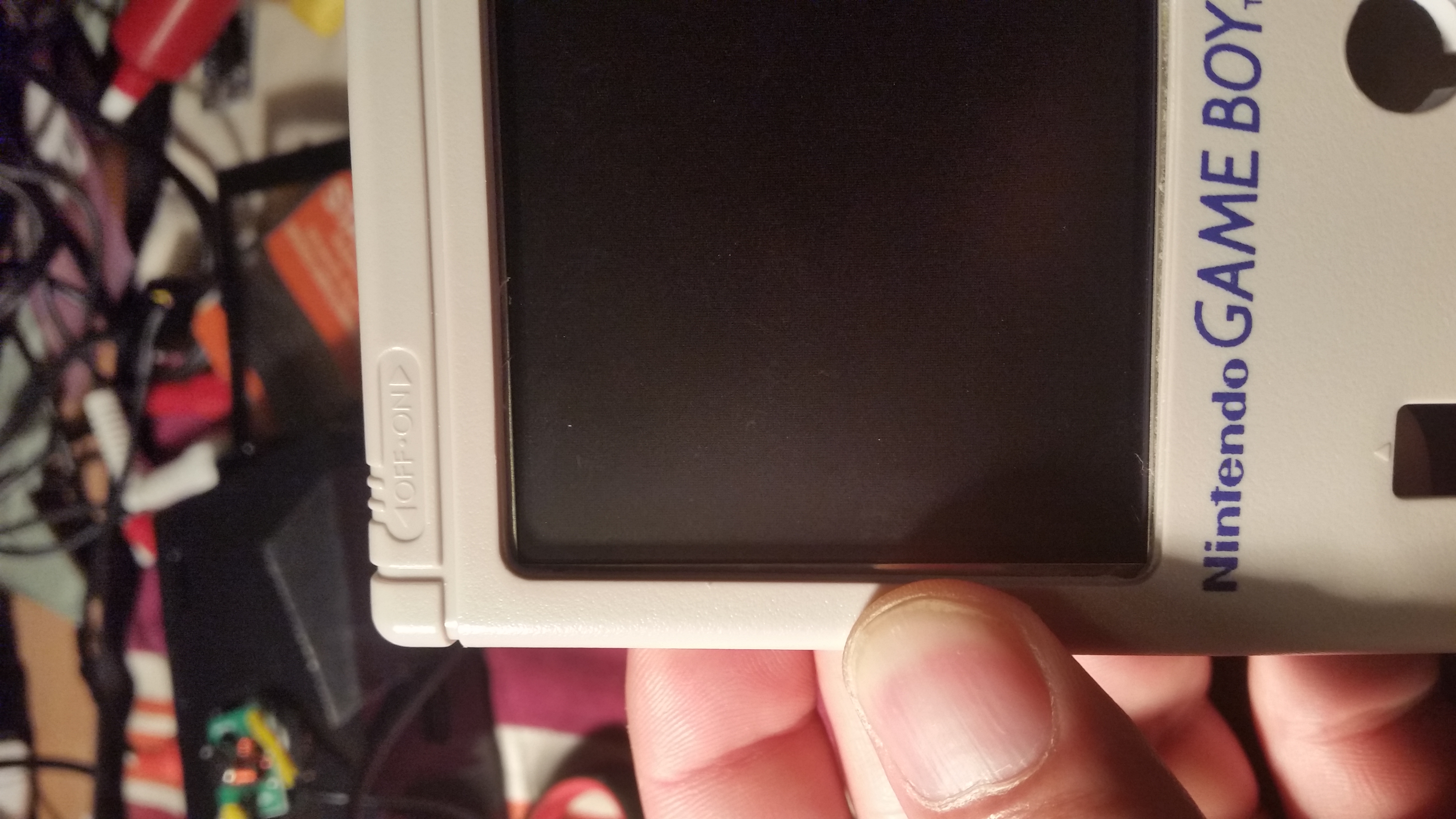

Post by dezent » Tue Aug 30, 2016 6:17 pm
Amazon.de Link
https://www.amazon.de/gp/product/B0056W ... UTF8&psc=1
I ordered 2 screens. Both were delivered within 2 days. Both seem to be V7 BW board and working perfectly fine @5V after soldering the jumper solution.
There is a small (silver) border visible, but a bit of black color will fix this.
