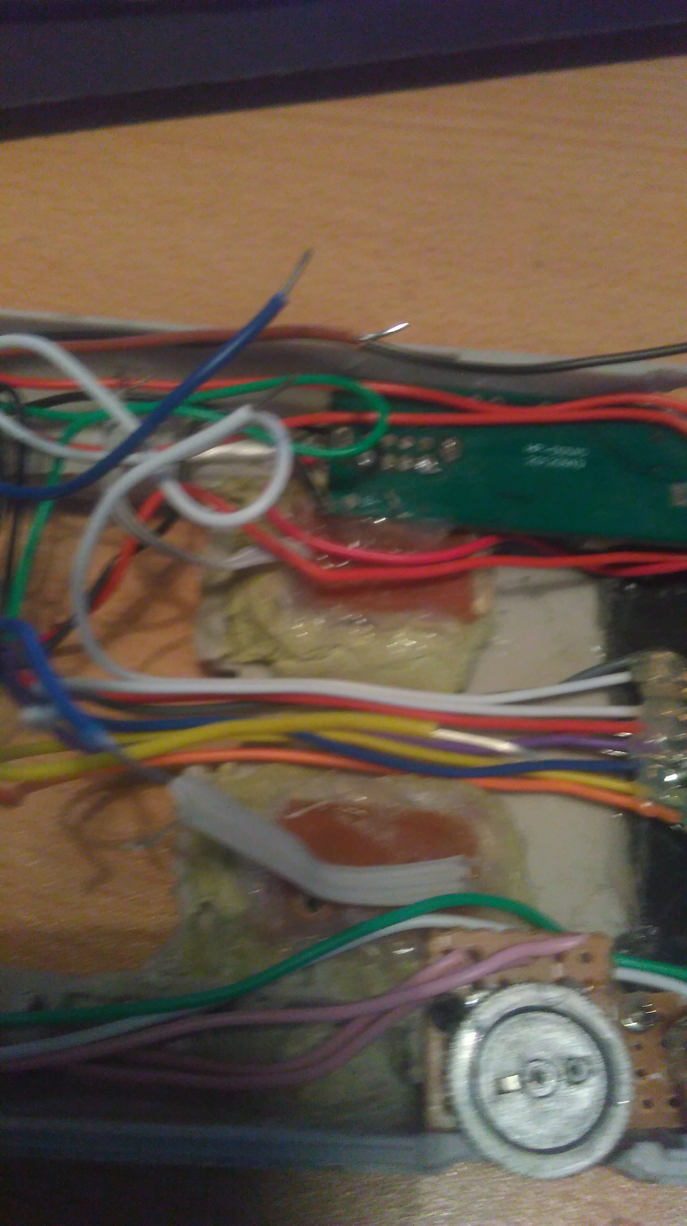

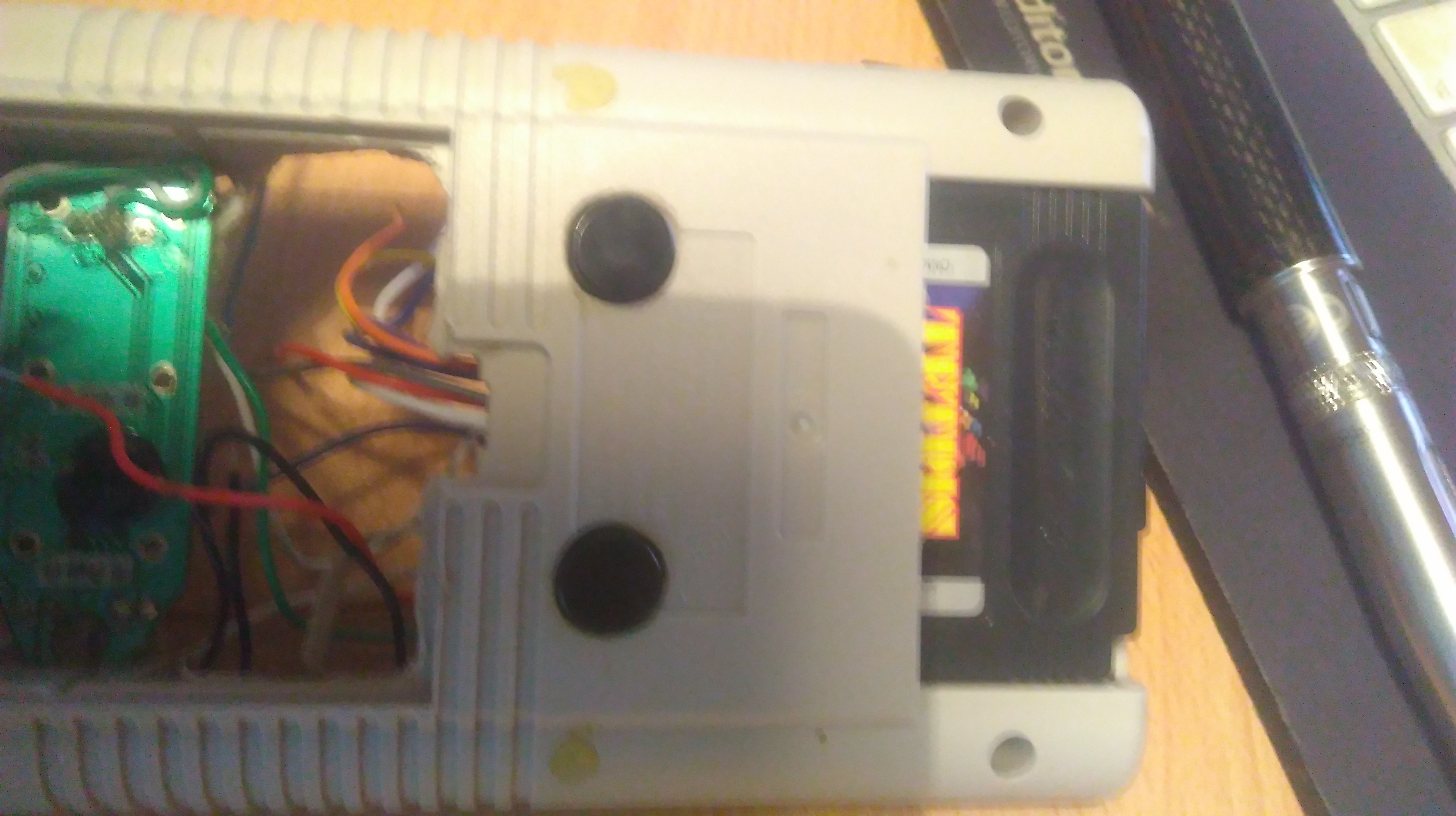

Post by wusubby » Sat Sep 10, 2016 4:29 am
Thought the same, buttons not really comfortable. I've moved them as you can see in the pics. Used the bumper pads from the USB Suez controller mentioned in the guides. Buttons I already had. Just had to drill the holes slightly bigger to go over the rubber connector to make the connection on the switch pad.
To hold it all together is used epoxy putty and hot glue.
