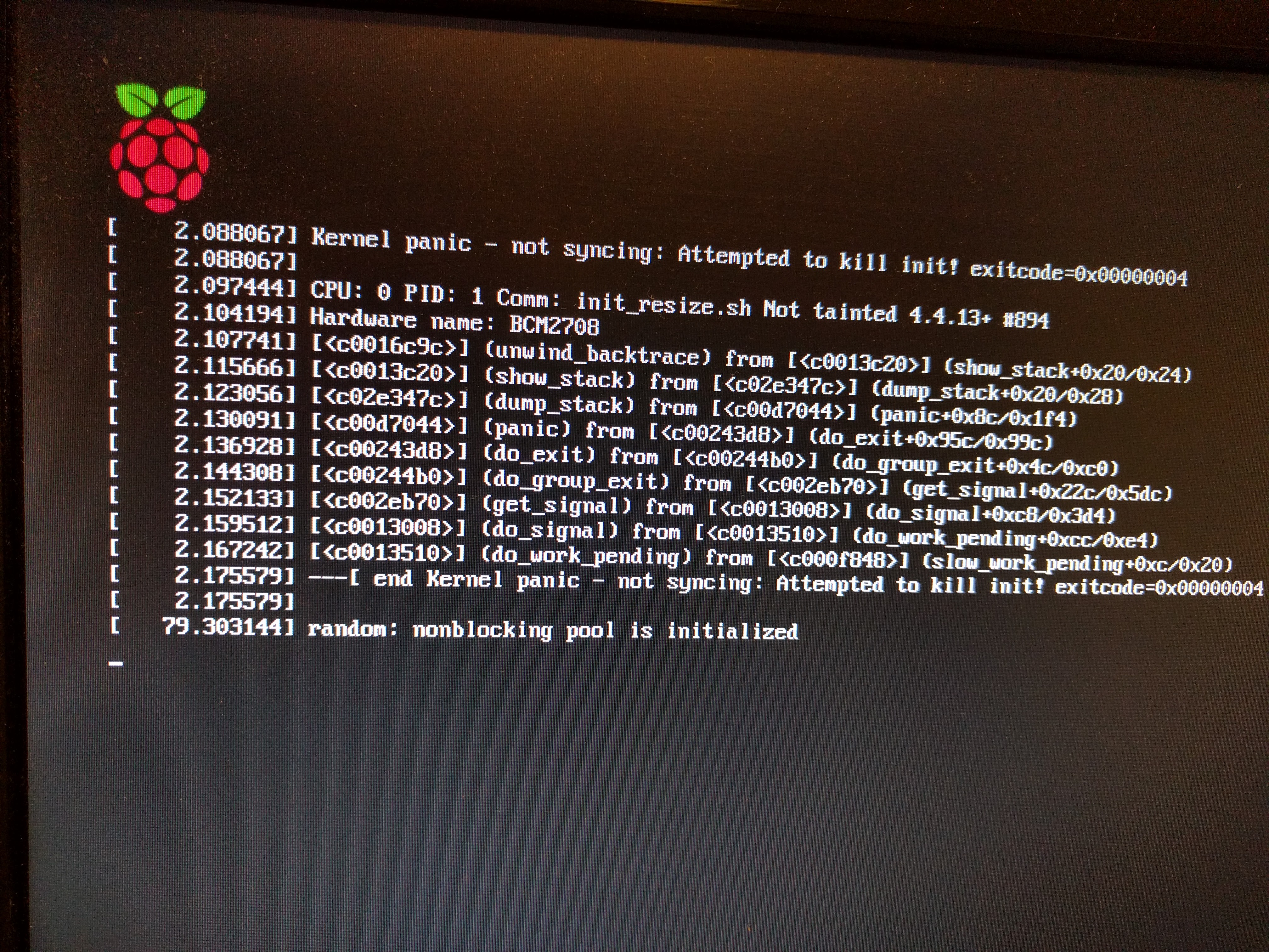

I've been trying to get my USB hub working without any luck (no USB device is recognized when the hub is wired to the Pi). Without a way to safely shut the Pi down, I think I have corrupted the data on the SD card at least a few times. I have been reflashing RetroPie with Apple Pi Baker, but that has stopped working. Now, even with a completely clean copy of RetroPie, it will not boot. Is it possible that the physical card has been damaged by something I have done? I have another 32GB card (the one that was booting successfully before is an 8GB card), but it has never booted (I just get the rainbow square when the Pi turns on).
This is the error with the possibly damaged 8GB card:
Pi error message
Any ideas?

When plugged into my laptop, the card was showing that it only had something like 50MB available, so I completely erased it using MacOS Disk Utility. When I reflashed RetroPie, it appeared to be doing better at first but there were a lot of "Failed" messages. It didn't successfully boot. I started over and wiped it clean again and now it is back to the same error shown in my original post. I may need to try to do this on another machine; I may try to get Ubuntu booting from USB or something.
I don't understand the comment from Zero about adding my USB hub using a OTG cable. I have an OTG cable that I have been using to test USB devices that I plug into the Pi, but is there something else I am supposed to do? I am following wermy's guide as closely as I can, and he doesn't use an OTG cable.
Update:
I formatted the card using GParted on Ubuntu, and even then with a completely clean install of RetroPie, I get the same Kernel panic error shown in my original post. I'm stumped. It looks like I may need a new SD card or possibly a new Pi Zero.

Looks like the card is toast. I did an "Overwrite Format" of my card, which took quite a while, and then, using Apple Pie Baker, I prepped the card for NOOBS and then flashed the RetroPie image to the card. Same error.

It looks like the issues with the SD card were a red herring all along. I received a new Pi Zero in the mail today, so out of curiosity I put my "bad" card in it, connected it to a monitor and power and it booted right up. Zero's advice in his last post was to remove all solder joints from the Pi and make sure it is clean when I test new cards. All this time, I had my SD card cartridge reader wired up, and I had alternated between putting the card in the cartridge and directly in the Pi. If I remove the cartridge and put the card directly in the Pi, it works just fine. I'm not sure what this means. I don't see any problems with my solder joints on the Pi or on the pins on the cartridge slot, and I doubt the problem is with the cartridge itself since I am using PRS-TECH's pcb with the built-in slot and filtering.
Whether the SD card is in it or not, if the cartridge is connected to the Pi, it won't boot. Any advice on how to troubleshoot this? When I get a minute (I'm out of time tonight), I'll check continuity on the wiring with my multimeter. Not sure what to do next.
