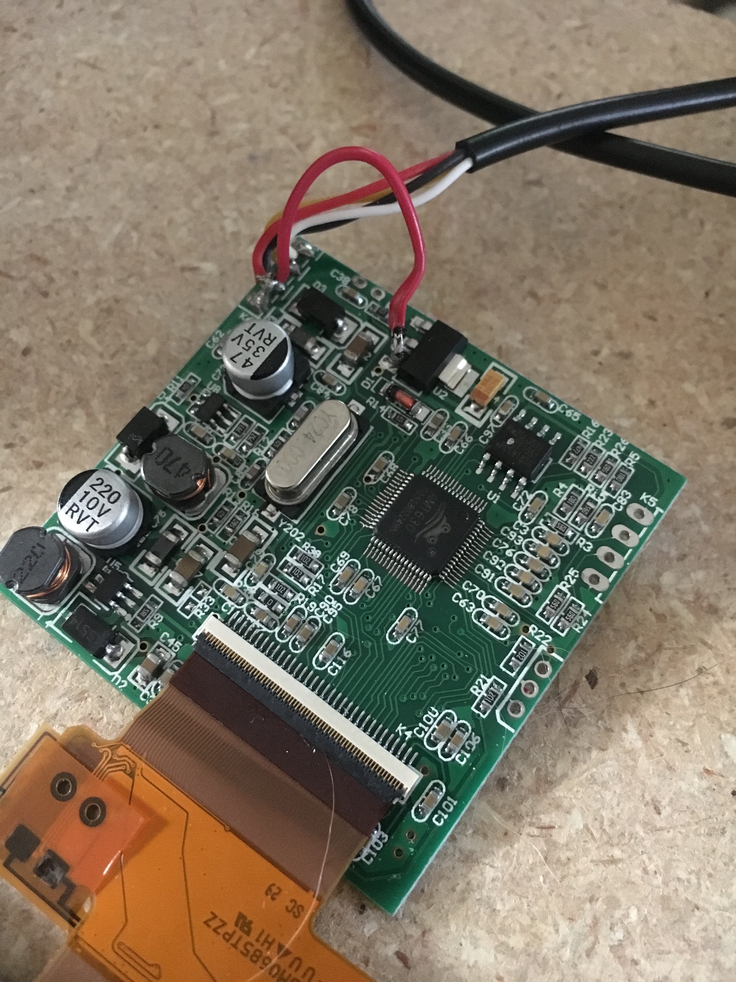

Being a total novice, as stated before, I am just sort of following directions as I see them (I can just barely understand some of this stuff :? ). That being said... so the only thing I would have to do to get this to work is take a wire (I am using 24 gauge, is that too thin?) and solder it onto the power wire connection and the other end to the third pin on that regulator?

Okay, I have an update on my screen.
I wound up wiring a 22 gauge red jumper wire like in the picture. I used a more rigid, bendy copper wire than the other wires I was using, so hopefully that was the right choice. My soldering isn't the best, and it kind of lifted the initial red wire out of the contact point, but the solder is holding both of them in place, just a little higher up off of the board.
Here is a photo of this:

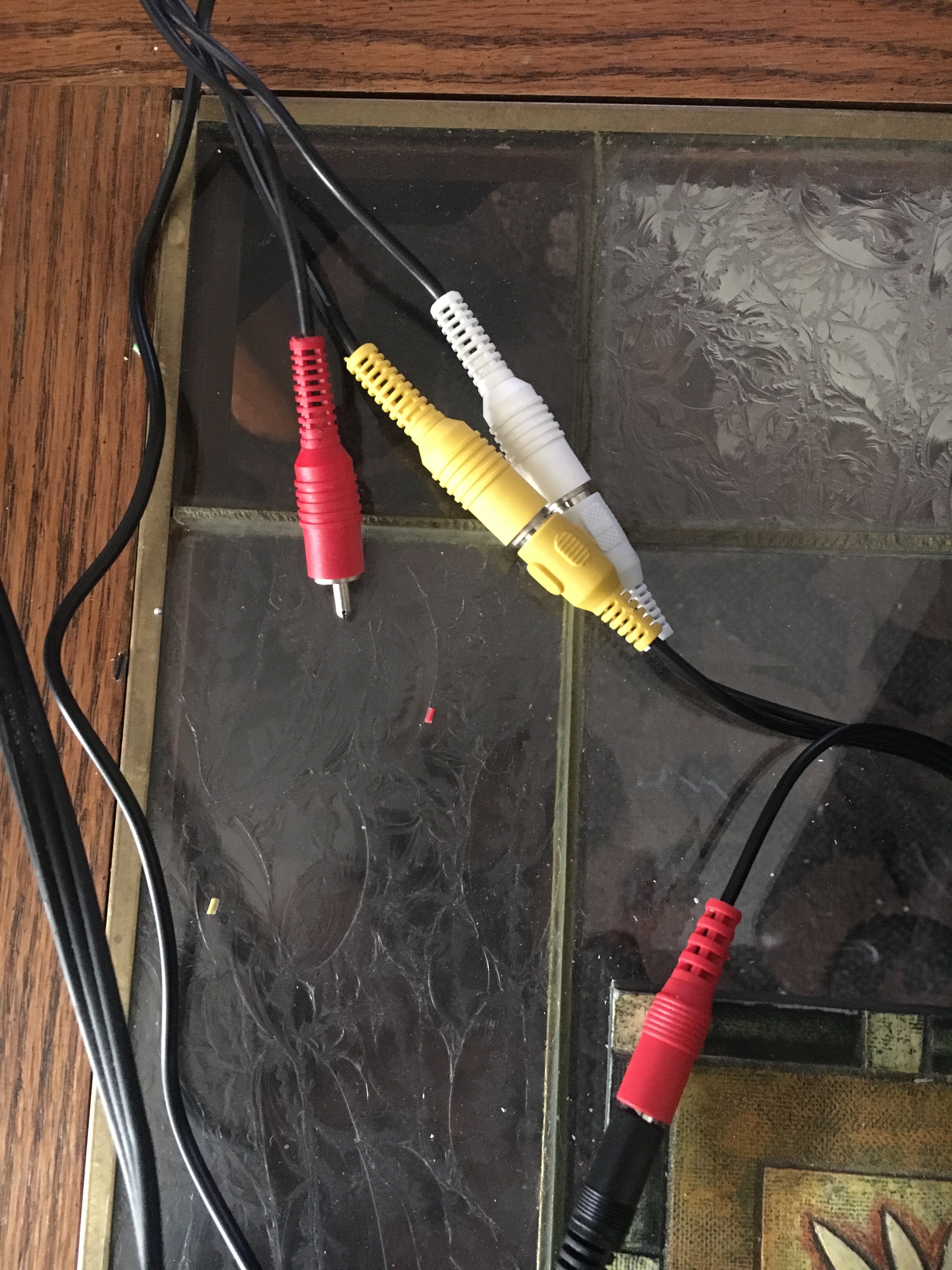

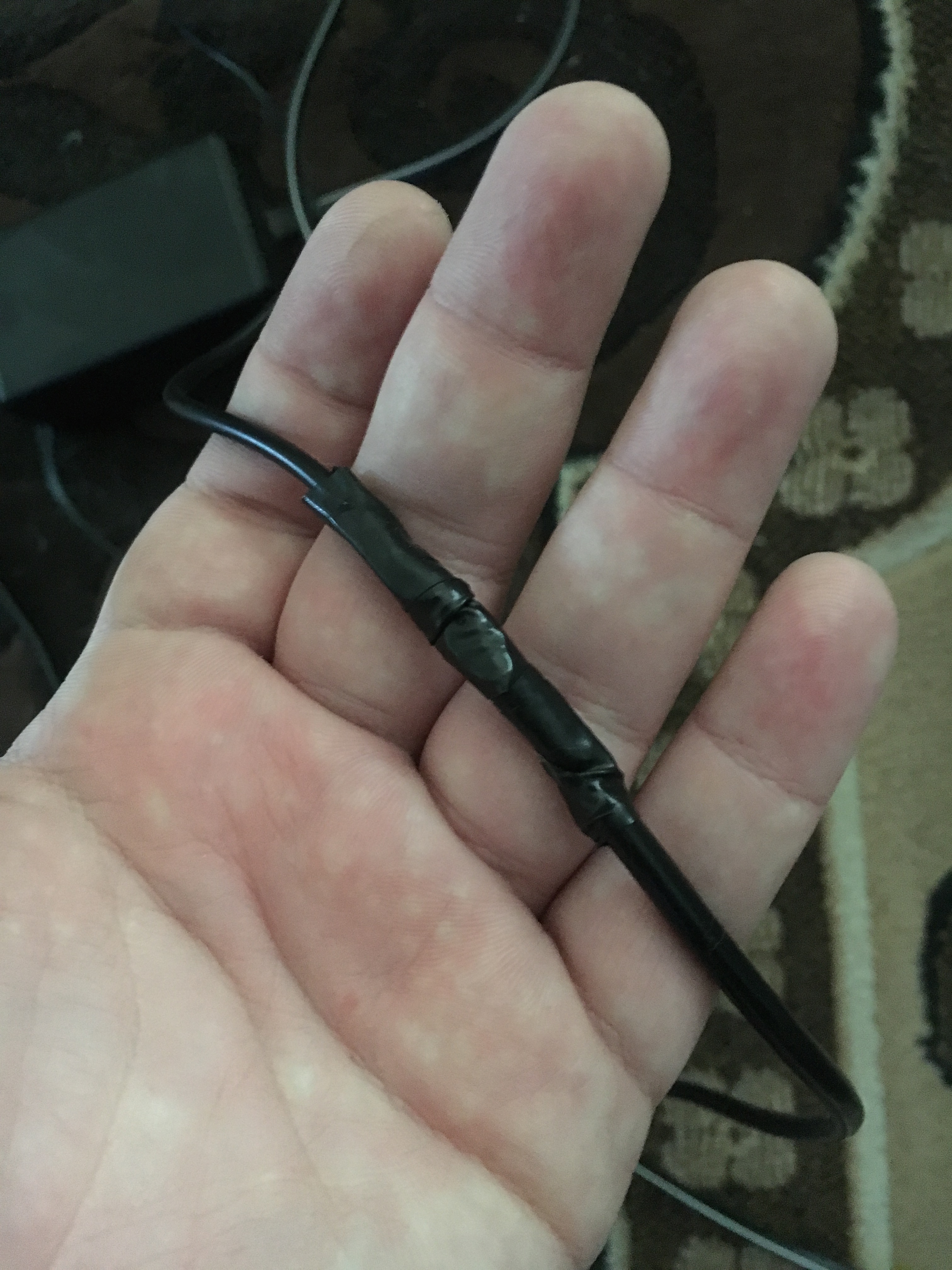

Like I mentioned before, I wired up the power cable that came with the camera to a 99cent store USB, disregarding the two data wires:
Which is plugged into a 5 volt (5.1 actually, i think) power block from a chomecast I had laying around.
I then used a gamecube to plug the composites into the wires that were given with the screen, which is wired up to the board
I got everything wired up and....the screen didn't turn on :(
I fiddled with the ribbon, which is held in by a clasp, and I started seeing something..a flicker. At this point, I'm stuck with this flickering screen, which I feel is a better sign than it not working, but I'm not sure where to go from here. It seems like it just probably need some simple modification. I used my multimeter (a tool I havent used before and need to learn more about), and when I set it to the "10V" setting then probed the ground and end of the jumper wire, it said ".58"
Heres a gif of the flicker. In reality, it looks much clearer, and the brightness seems good.
I appreciate everyones helpful comments. Any idea of where to go from here?

Not sure if the yellow and white cable are for the yellow and white wire, but you only need one when soldering to the pi.
It might be switching between av1/av2 constantly? Try just using one.
