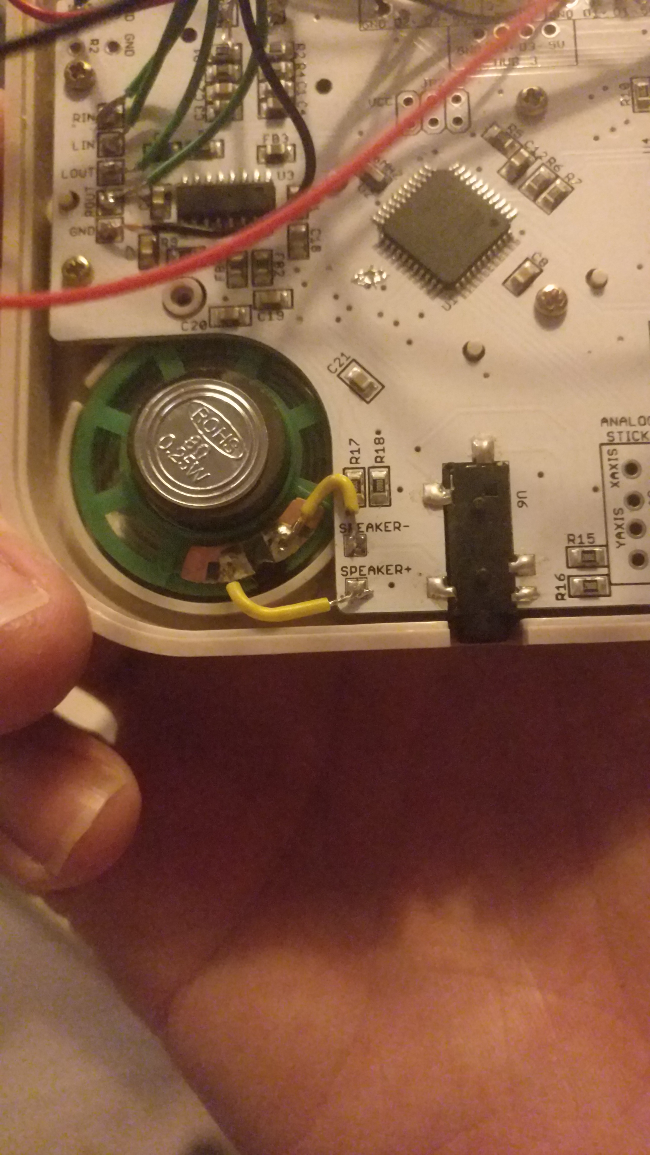

Re: Are there any wire diagrams for Helders latest AIO?
I wired the speaker to the speaker + and speaker -, yet I hear no audio. Did I hook this up incorrectly or do I have to change settings somewhere/program scripts?
Sorry for the noob question.
- IMG_20161120_002123.jpg (2.26 MiB) Viewed 9414652 times
- RetroGamingNow
- Posts: 137
- Joined: Fri Jul 15, 2016 7:55 pm
- Has thanked: 9 times
- Been thanked: 24 times
Have you wired pwm to your pi and added the correct info to your config.txt file?Fleppensteijn wrote:I wired the speaker to the speaker + and speaker -, yet I hear no audio. Did I hook this up incorrectly or do I have to change settings somewhere/program scripts?
